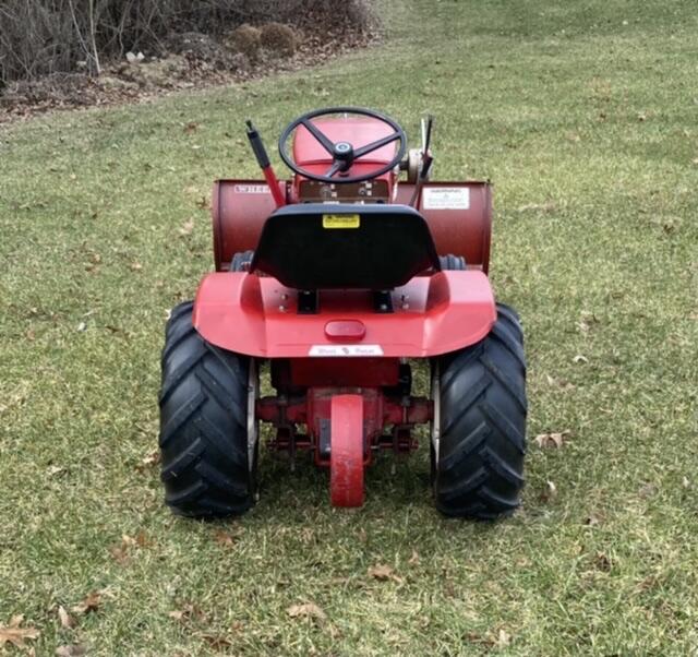

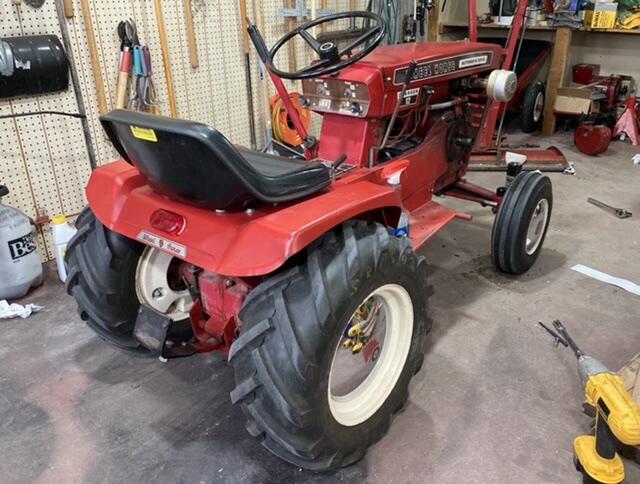

cschannuth 3,817 #7 Posted February 11, 2021 Deestones run narrow but here is a set of 10.5 inch Deestones on 7 inch wheel horse wheels. 2 Share this post Link to post Share on other sites
WVHillbilly520H 10,376 #8 Posted February 11, 2021 Maybe this will help clear the mud... Share this post Link to post Share on other sites
