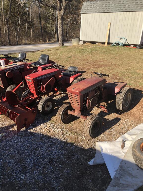

Sammy 89 #1 Posted February 8, 2021 Well guys I’ve recently picked up a 1276 and it runs like new and drives good for the most part but it has a fun and dangerous issue I need some help with. If you push in the neutral return brake pedal it will return and stop motion as it should but as soon as you let off of it the control lever falls forward and it takes off full speed. There isn’t much of a crawling speed to this tractor at all it’s either neutral or full speed and I need to get it fixed because I’d like to mow with it this upcoming season. Are there any fixes for this issue I’m having? (It’s the tractor on the farthest right in the picture) Share this post Link to post Share on other sites

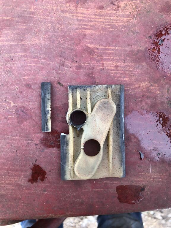

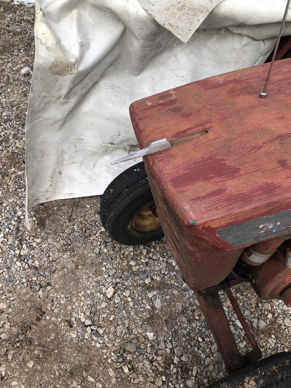

Sammy 89 #10 Posted February 8, 2021 Well fellas I just replaced the cam plate and just flipped over the tension plates and belt them a little and that seems to be working much better than it did, I also discovered a crack in the cam plate so that probably had something to do with it also! Now I’m setting up to put a hydraulic lift on this thing that came off of an electro 12 and the tractor I’ve Codenamed stingray will be done! (Top picture is the broken cam plate!) (bottom picture is why I call it stingray) 2 Share this post Link to post Share on other sites
rjg854 13,180 #11 Posted February 8, 2021 A little bit of caulk under that hood ornament and it'll be all better, I have a hood ornament that only has the one post too. You wouldn't know it now 1 Share this post Link to post Share on other sites
Sammy 89 #12 Posted February 8, 2021 3 minutes ago, rjg854 said: A little bit of caulk under that hood ornament and it'll be all better, I have a hood ornament that only has the one post too. You wouldn't know it now That’s a good tip that I’m definitely going to remember but we have plans of doing a restoration on this tractor and putting hydraulic lift on it so we’ll most likely end up using another hood ornament Share this post Link to post Share on other sites
Pollack Pete 2,273 #13 Posted February 8, 2021 1 hour ago, Sammy said: Well fellas I just replaced the cam plate and just flipped over the tension plates and belt them a little and that seems to be working much better than it did, I also discovered a crack in the cam plate so that probably had something to do with it also! Now I’m setting up to put a hydraulic lift on this thing that came off of an electro 12 and the tractor I’ve Codenamed stingray will be done! (Top picture is the broken cam plate!) (bottom picture is why I call it stingray) Be careful where you bend over!! 1 1 Share this post Link to post Share on other sites
Sammy 89 #14 Posted February 8, 2021 6 minutes ago, Pollack Pete said: Be careful where you bend over!! Lol, we have been knowing that the 1276 is out there Share this post Link to post Share on other sites
