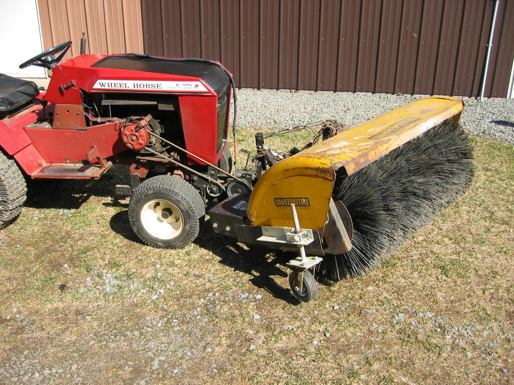

pfrederi 21,184 #26 Posted February 8, 2021 I would recommend pneumatic tires for your casters. I use mine in the spring to get the stones out of the grass and back in the driveway and the dirt road I live on. The ground is soft and bigger casters are better as this thin is heavy and the electric lift doesn't respond quickly to any dips or bumps. Wish I had better casters cheap chinese tires do not hold up. 2 1 Share this post Link to post Share on other sites
