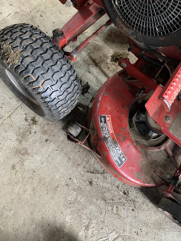

Bcmedic85 12 #55 Posted March 26, 2021 Got another question about this thing it has a 37 inch side discharge mower deck on it no tags on serial numbers anywhere. I put a new belt on it today found a 1/2 inch x 141 inch belt that works once I tighten the adjuster on the mule drive a bit could probably get by with a 140 or 139 have more adjustment left in it. But does anyone else’s deck come really close to the left front tire or is it just mine? I barely turn left and it’s scrubbing the front tire. Share this post Link to post Share on other sites
Handy Don 17,495 #56 Posted March 26, 2021 1 hour ago, Bcmedic85 said: Got another question about this thing it has a 37 inch side discharge mower deck on it no tags on serial numbers anywhere. I put a new belt on it today found a 1/2 inch x 141 inch belt that works once I tighten the adjuster on the mule drive a bit could probably get by with a 140 or 139 have more adjustment left in it. But does anyone else’s deck come really close to the left front tire or is it just mine? I barely turn left and it’s scrubbing the front tire. Can you get a couple good shots from low on both sides that show how it's hooked up under the tractor, please? Share this post Link to post Share on other sites
Bcmedic85 12 #57 Posted March 26, 2021 @Handy Don I got it fixed I found instructions on this site for deck removal and installation. It wasn’t aligned properly the middle fork was on the outside of the frame instead of in the middle on the bar. The fella I bought this thing off of had it hooked up wrong as well. Share this post Link to post Share on other sites
Handy Don 17,495 #58 Posted March 27, 2021 1 hour ago, Bcmedic85 said: @Handy Don I got it fixed I found instructions on this site for deck removal and installation. It wasn’t aligned properly the middle fork was on the outside of the frame instead of in the middle on the bar. The fella I bought this thing off of had it hooked up wrong as well. Glad to hear it! You were reading my mind. Also, the fork that "sticks up" in the middle is easy to mis-align. With everything in its proper place, it also lifts better and mows more evenly. BTW, I strongly suggest you read the rest of those instructions and take the time to make sure the mower height is correctly aligned--not hard to do and makes a big difference in the evenness of the cut! 2 Share this post Link to post Share on other sites
