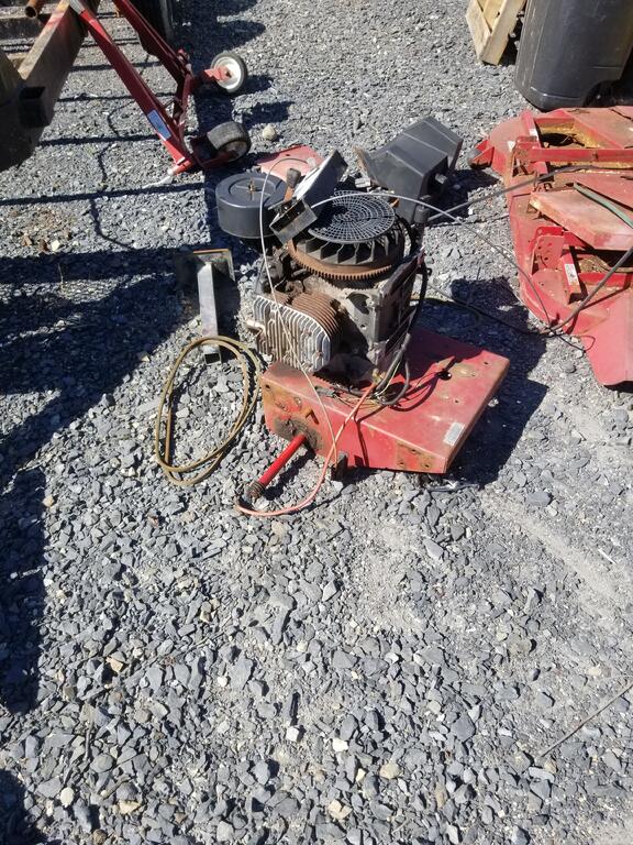

Shed 377 #1 Posted February 7, 2021 Hey there I wanted to ask this for motor people. I have a magnum mv16 vertical shaft not running came out of a toro. I planned to use it for a log splitter build. In your opinions is this thing worth rebuilding or just buy a new 16hp size engine. I figures if I'm taking this thing apart it's going all the way and I see the cost for rebuilding parts are pretty costly. But are these motors worth rebuilding that's the question too. Share this post Link to post Share on other sites

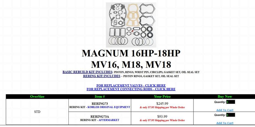

Shed 377 #6 Posted February 7, 2021 I just cant get it to fire but I'm guessing the valves need replacing and I'm sure the pistons need new rings. It came off a toro walkbehind. That was used pretty hard. I put a brand new starter on it. At the price of plugs wires and ignition module I'm a 3rd away from a replacement. Well looking at the picture looks like the head is cast block may be aluminum Share this post Link to post Share on other sites
pfrederi 21,301 #7 Posted February 7, 2021 Two piece block is alloy as are the heads. The jugs are cast iron. Valves are not adjustable. you can do a re-ring just pulling the jugs. If you have a rod/crank issue you have to split the crankcase. Since it isn't running it is impossible to be sure how bad off the engine is. I think I would buy the re[placement engine. Share this post Link to post Share on other sites
