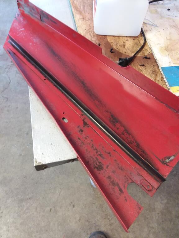

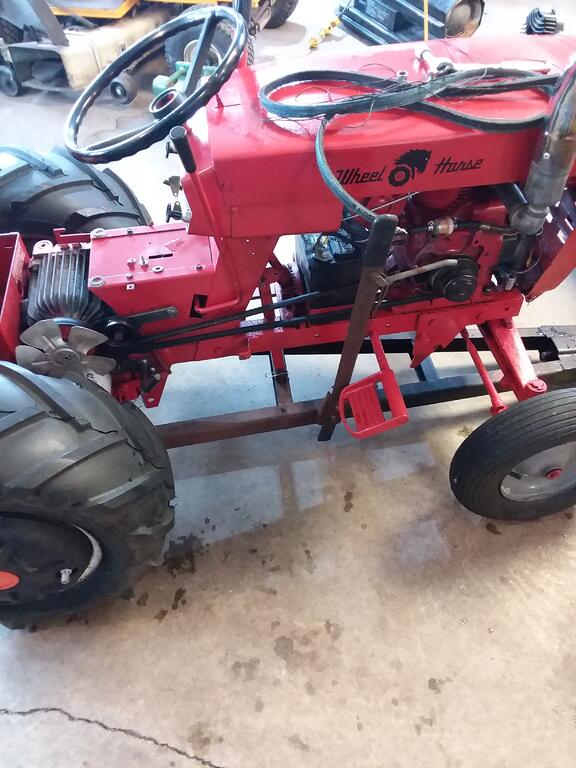

Andy876 25 #1 Posted February 5, 2021 New to wheel horse's, learned a valuable lesson plowing snow today! Be sure to lock your drive belt in, before installing the shield. Finished the whole drive, but shredded the belt 200 feet away from the barn! It was a long push!!!! Lol! 2 6 Share this post Link to post Share on other sites
pfrederi 21,312 #2 Posted February 5, 2021 (edited) Ouch...but i have to admit to more than once realizing I had the belt on the wrong side of the guide piece... Edited February 5, 2021 by pfrederi Share this post Link to post Share on other sites
moe1965 774 #3 Posted February 5, 2021 I see it's a hydro. If you have to push or pull again be sure to back off the toe valve so you dont damage the pump. Just a fyi 3 Share this post Link to post Share on other sites
Andy876 25 #4 Posted February 5, 2021 14 minutes ago, moe1965 said: I see it's a hydro. If you have to push or pull again be sure to back off the toe valve so you dont damage the pump. Just a fyi I did back her off, but it was slippery than heck! 2 Motrin 800's and my lazy boy for me! 1 9 Share this post Link to post Share on other sites

rjg854 13,422 #8 Posted February 5, 2021 I got myself into the habit of always having the drive belt engaged when putting the belt guard back on. So that doesn't happen, again. 4 Share this post Link to post Share on other sites

wfrpalm 218 #10 Posted February 5, 2021 3 hours ago, pfrederi said: Ouch...but i have to admit to more than once realizing I had the belt on the wrong side of the guide piece... Which is the wrong side? The belt on my 875 keeps falling off, maybe that's the problem. Share this post Link to post Share on other sites

pfrederi 21,312 #14 Posted February 5, 2021 2 hours ago, wfrpalm said: Which is the wrong side? The belt on my 875 keeps falling off, maybe that's the problem. Belt should sit on top of it 1 Share this post Link to post Share on other sites
