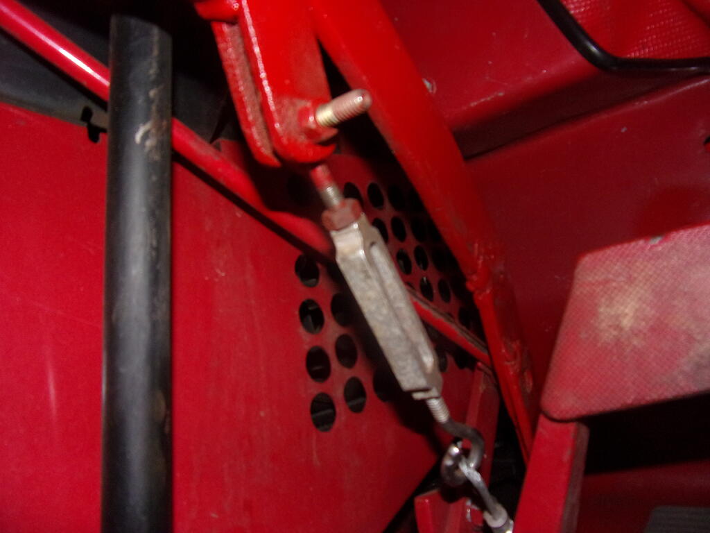

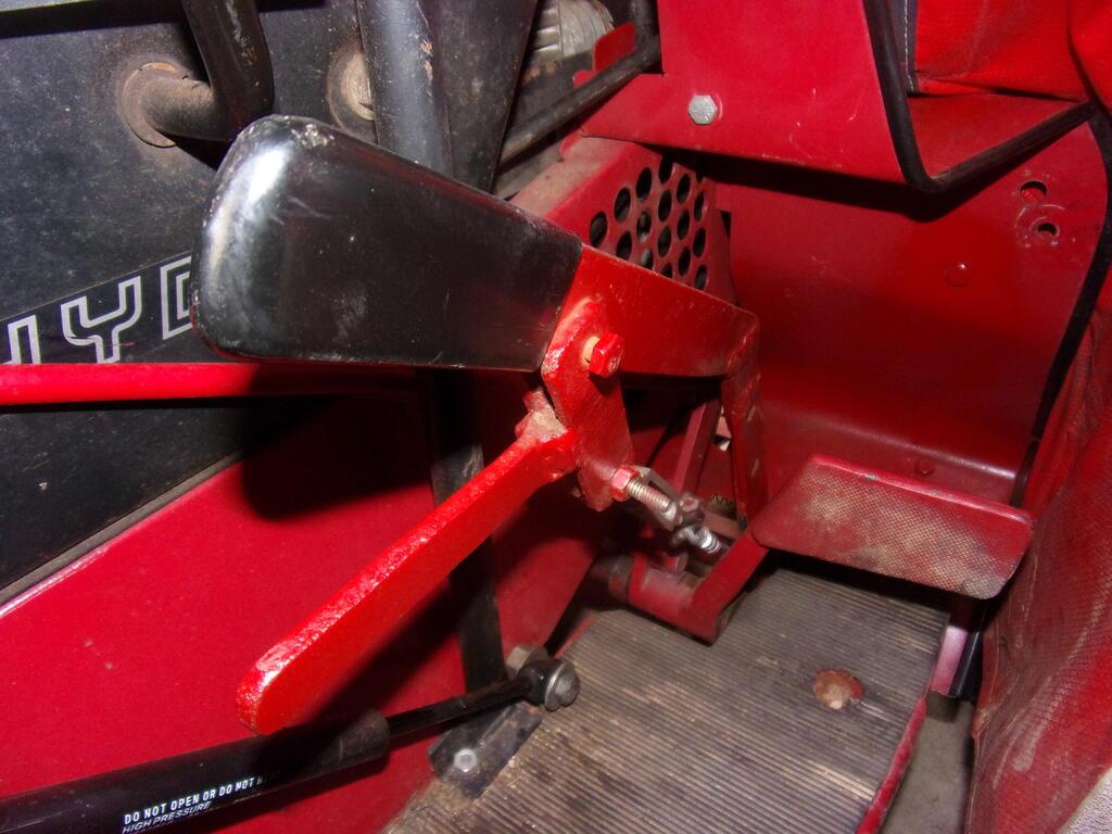

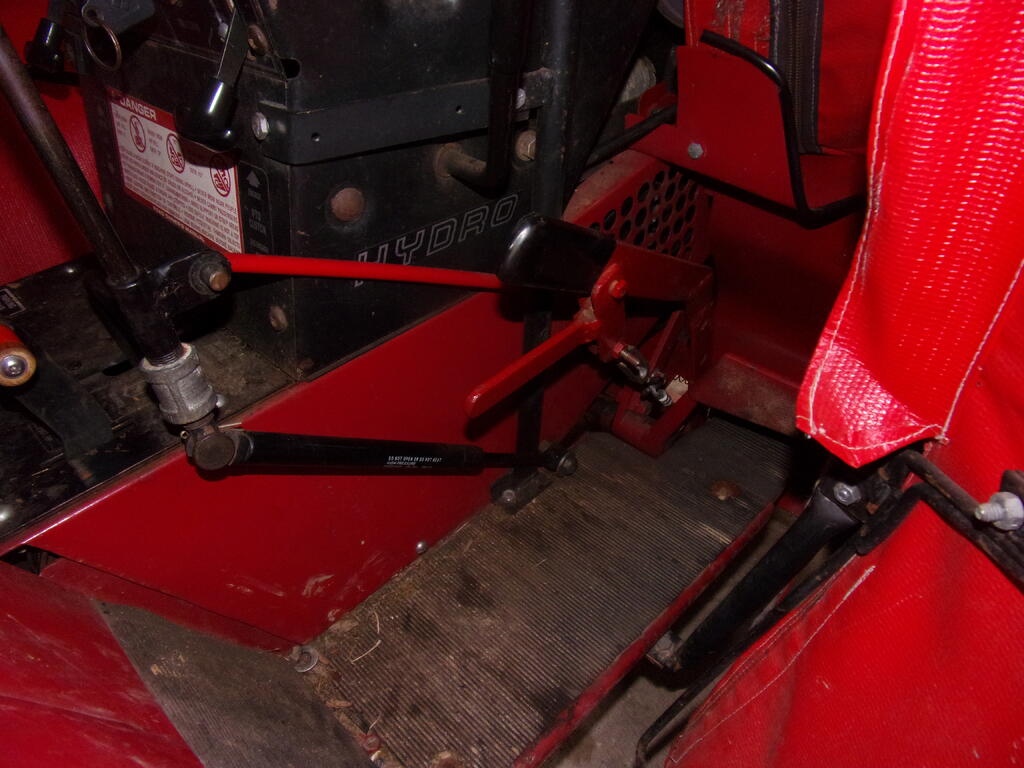

Ed Kennell 47,604 #8 Posted February 5, 2021 I have some old garage door lift cables that I use for this. They all ready have a loop crimped in the one end that I put at the top handle. I use small eye bolts as guides and put a small turnbuckle in line to adjust the tension. On my 520 with the cab, I modified the blade angle lever to a horizontal position inside the cab by my right leg. The cable worked great for this as the lever has several bends to get inside the cab. 5 3 Share this post Link to post Share on other sites

Horse Newbie 7,405 #10 Posted February 5, 2021 1 hour ago, Ed Kennell said: I have some old garage door lift cables that I use for this. They all ready have a loop crimped in the one end that I put at the top handle. I use small eye bolts as guides and put a small turnbuckle in line to adjust the tension. On my 520 with the cab, I modified the blade angle lever to a horizontal position inside the cab by my right leg. The cable worked great for this as the lever has several bends to get inside the cab. What is the galvanized coupling... onboard waterworks ? Share this post Link to post Share on other sites
Ed Kennell 47,604 #11 Posted February 5, 2021 24 minutes ago, Horse Newbie said: What is the galvanized coupling.. A 3/8 sch 40 pipe nipple just slides down over the motion lever. Cut a notch to clear the bend in the lever and screw on a coupling to lock it in place. Gives me an attachment point for my foot pedal and pneumatic cylinder w/o altering the hand lever control. 1 1 Share this post Link to post Share on other sites
