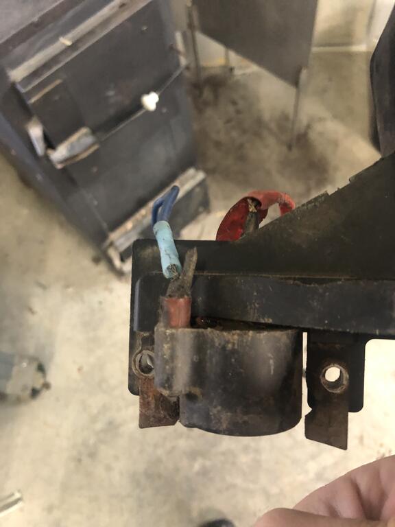

Ed729 57 #1 Posted February 4, 2021 My Kohler 12hp magnum has the solid state ignition on it. It has works fine but the spark plug wire is in bad shape right at the coil. It looks like it’s all one piece but I would really like to replace the wire itself. Has anybody had any luck or do I have to replace the coil? The only thing I can think of is trying to cut the insulation and sleeve off to get a better soldered connection, then use liquid tape to cover it. Here’s a picture of the temporary repair that has lasted several years. Share this post Link to post Share on other sites
WHX?? 58,218 #2 Posted February 4, 2021 Ed. That's probably what I would attempt to do. See if you can get back to good wire and solder new on. Epoxy/shrink wrap it back up. Your really not out much for trying. Course they don't want a whole heck of alot for a new one..... Ignition Coil For Kohler M10-461512 Magnum Series Engine M12 M14 M16 M16GT | eBay 2 2 1 Share this post Link to post Share on other sites
johnnymag3 2,646 #3 Posted February 4, 2021 Just replace the coil......13.00 , and you wont have to go back and fix the repair again in a few months.... My .02 centssssssssssss Good Luck John 1 2 Share this post Link to post Share on other sites
gsummers 236 #5 Posted February 4, 2021 For the Love of Christ.... Magnum Coil - Engines - RedSquare Wheel Horse Forum Here is a link to an old post that shows how to replace plug wire in coil, I did it on one and it worked great! 1 1 1 Share this post Link to post Share on other sites
Ed729 57 #6 Posted February 5, 2021 Thanks everybody. Gsummers this was exactly what I was looking for! I’ll try this and order a cheap spare as a backup. 1 Share this post Link to post Share on other sites
