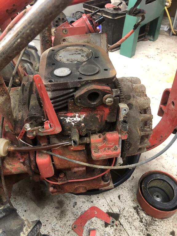

The Tuul Crib 7,339 #27 Posted February 7, 2021 Well last night I decided to take the top end off and do a carb dip. By the looks of the serial number date codes this was a replacement motor. It takes the motor to 1986. I'm thinking this machine is a little older than 1986? The top of the piston was stamped FLY with an arrow towards the fly wheel an STD which we all know what that means! he said something was done to it such as may be being bored out when he got it. Hope to get it back up and running soon. As soon as I figure out this transmission! 3 Share this post Link to post Share on other sites

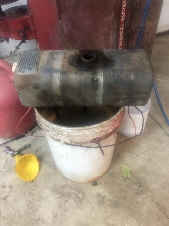

The Tuul Crib 7,339 #28 Posted February 7, 2021 OK got the head back on it carburetors going to soak for another day or two. i'm trying to gain knowledge on this machine is a go as to how it works. Friend of mine came over today looked at it and he knows how to run these machines. so he says anyway. Trying to figure out what kind of oil to put in it. Plus I filled up the gas tank with vinegar and shake it every now and then for the next week or two. 1 Share this post Link to post Share on other sites

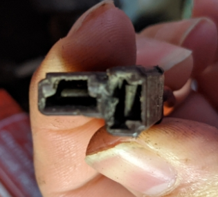

seuadr 489 #34 Posted February 24, 2021 (edited) @The Tuul Crib Hey - what does the wires coming out from behind the flywheel look like on your machine? what color are they? do they have a connector that looks like this: Also - do you have a glass fuse in line between your starter solenoid and the "B" terminal on your ignition? if so - can you tell me what amperage it is? Edited February 24, 2021 by seuadr Share this post Link to post Share on other sites

The Tuul Crib 7,339 #37 Posted February 26, 2021 On 2/24/2021 at 8:38 AM, seuadr said: @The Tuul Crib Hey - what does the wires coming out from behind the flywheel look like on your machine? what color are they? do they have a connector that looks like this: Also - do you have a glass fuse in line between your starter solenoid and the "B" terminal on your ignition? if so - can you tell me what amperage it is? Sorry it took so long for me to get back but the connector I have is just like this one in your picture. Share this post Link to post Share on other sites
seuadr 489 #38 Posted February 26, 2021 13 minutes ago, The Tuul Crib said: Sorry it took so long for me to get back but the connector I have is just like this one in your picture. awesome! where does it go? Share this post Link to post Share on other sites

Oldskool 6,663 #40 Posted February 26, 2021 6 minutes ago, seuadr said: awesome! where does it go? Mines a different model but 2 red from fly wheel plug, plugs to 2 blue to here. Share this post Link to post Share on other sites
seuadr 489 #41 Posted February 26, 2021 55 minutes ago, Oldskool said: Mines a different model but 2 red from fly wheel plug, plugs to 2 blue to here. my engine is nowhere near my chassis - was the plug long enough for you? seems really short to me, but, like i said, i don't actually have them lined up. Share this post Link to post Share on other sites
seuadr 489 #42 Posted February 26, 2021 59 minutes ago, The Tuul Crib said: Behind the flywheel. Can't imagine it would be but maybe three amps? no lights and no cigarette lighter ! BTW do you know if this was an option to have these outside wheels added. The hub between the tires is cast-iron and I'm assuming it's maybe 10 ir 15 pounds? yep. spacers are just a bolt on: 1 Share this post Link to post Share on other sites
Oldskool 6,663 #43 Posted February 26, 2021 4 minutes ago, seuadr said: my engine is nowhere near my chassis - was the plug long enough for you? seems really short to me, but, like i said, i don't actually have them lined up. My plug is close to the engine. With both connected there isnt much extra wire there. Share this post Link to post Share on other sites
