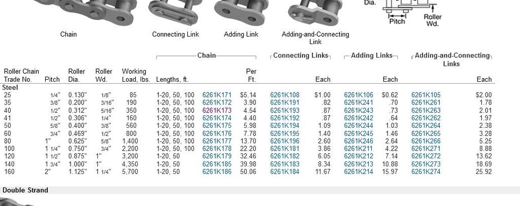

pfrederi 21,222 #3 Posted February 3, 2021 Too new for me but I would guess #40 McMaster has more dimensioned drawings Start here https://www.mcmaster.com/roller-chain/ansi-roller-chain-and-links-10/ 1 Share this post Link to post Share on other sites

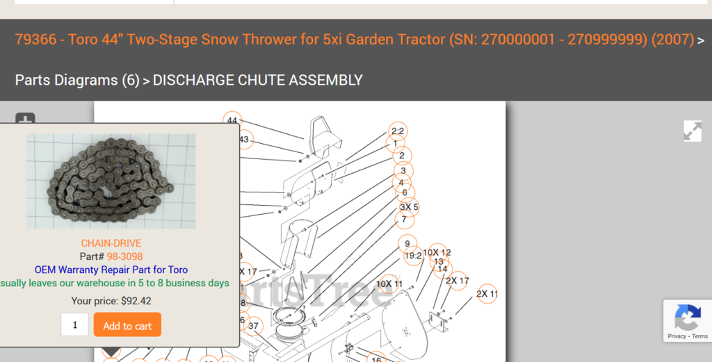

Pullstart 71,367 #7 Posted February 4, 2021 1 hour ago, stevebo said: Guys, Thank you for the replies. I ended up taking old chain to tractor supply and matched it up. It is indeed a #40 chain. I got a 10’ length fir about $23 bucks. Cut it to fit and moved a lot of snow banks tonight. Held up with no issues. woo hoo! Beats $92 for a part number! 1 1 Share this post Link to post Share on other sites
