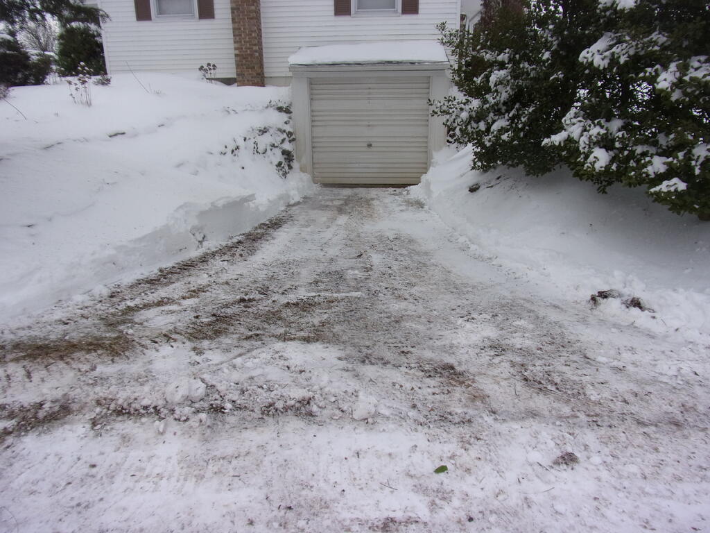

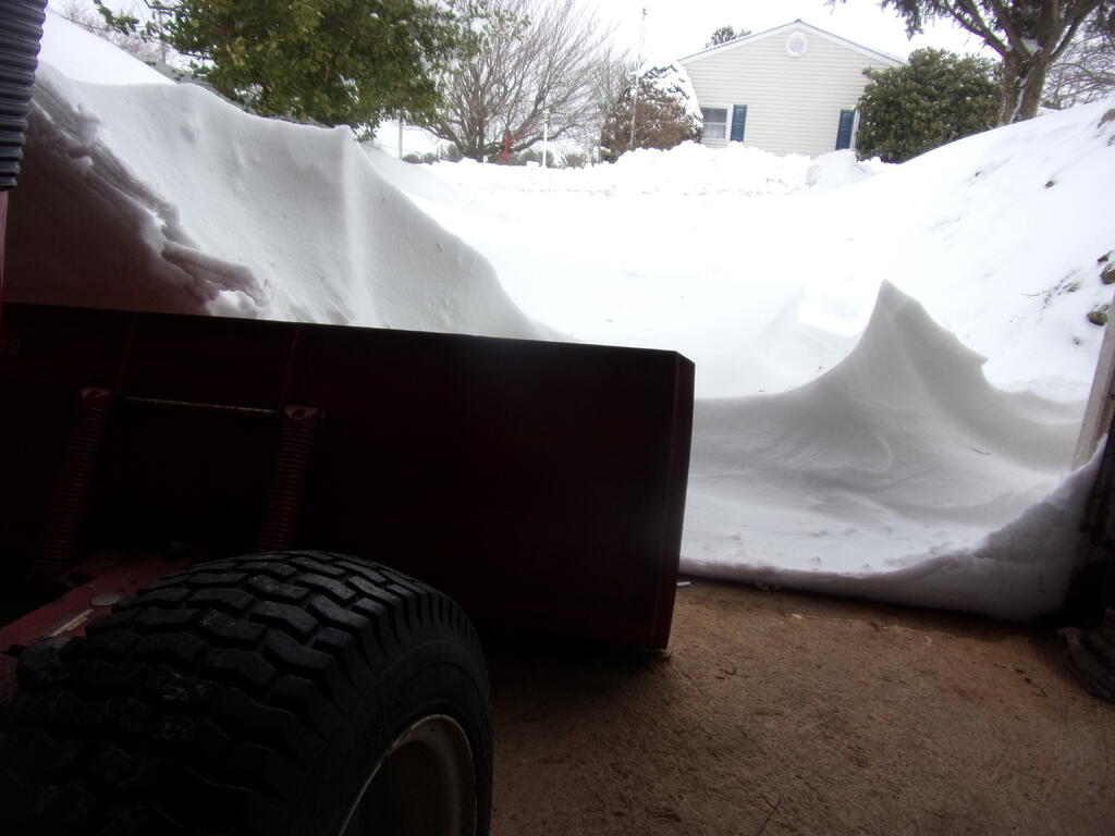

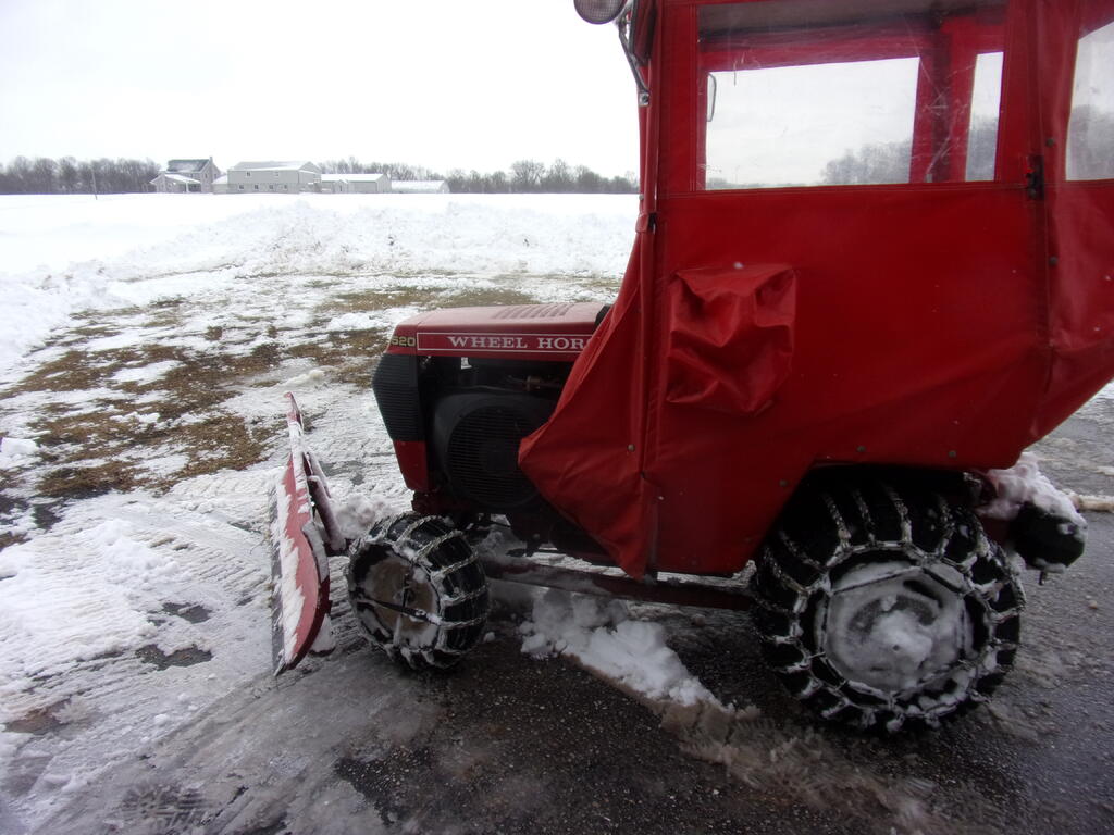

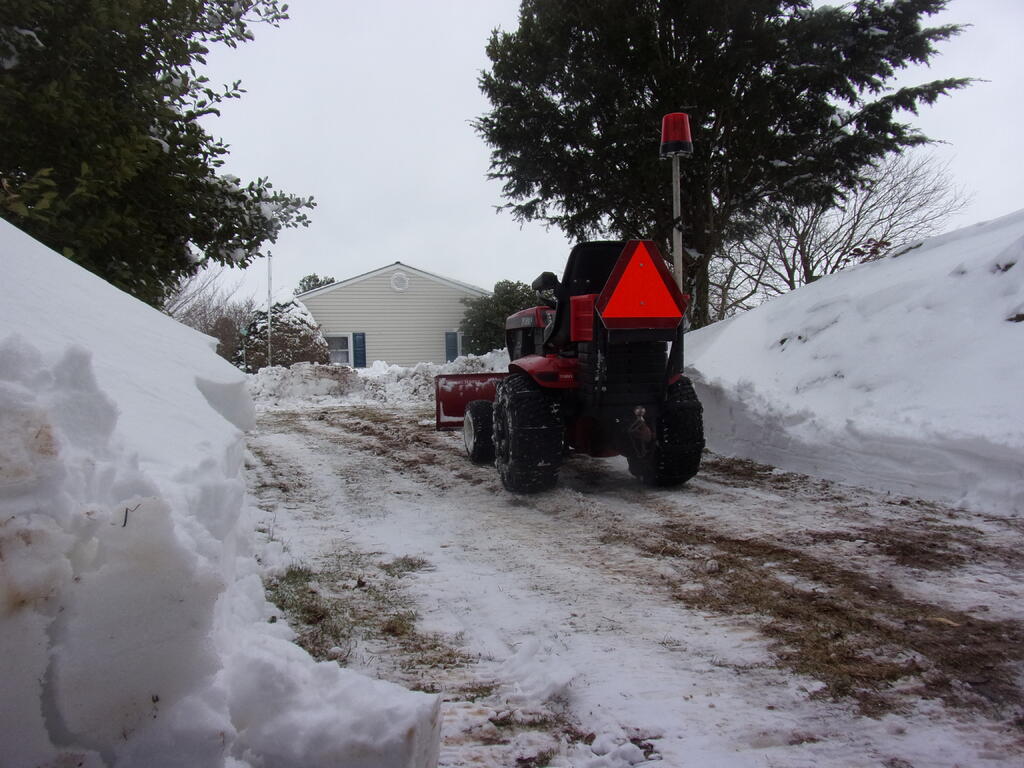

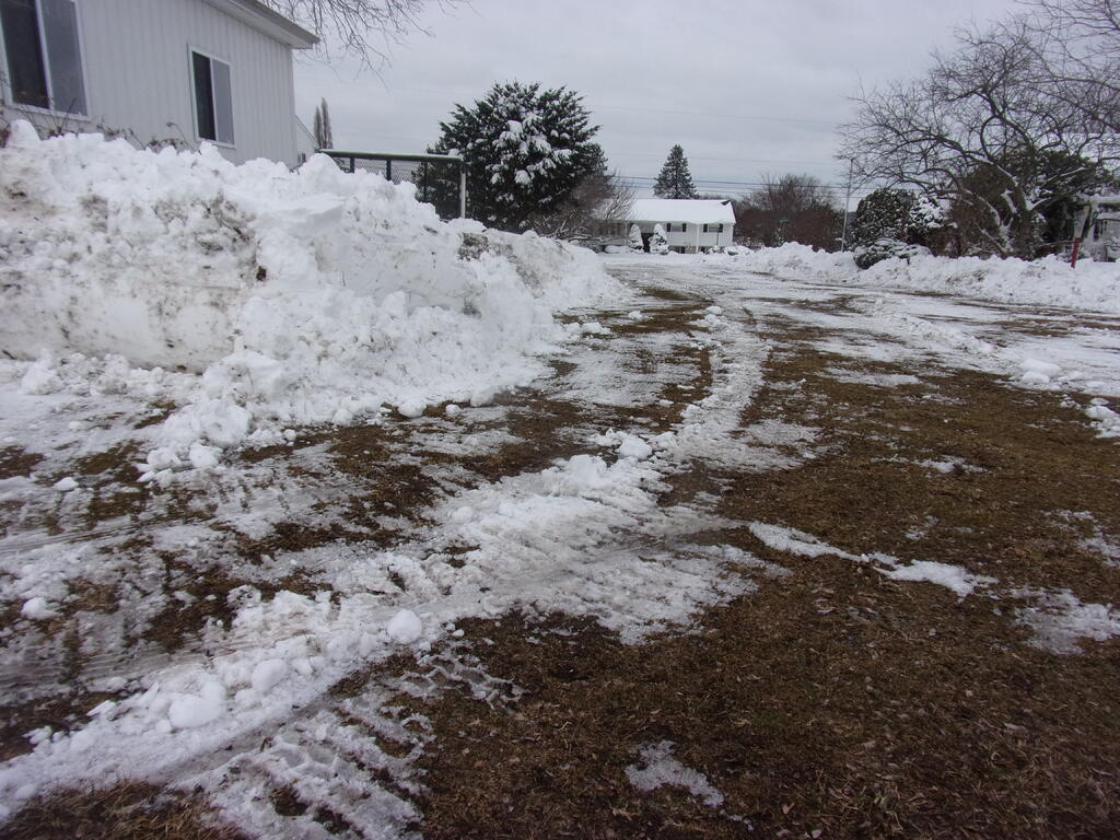

Ed Kennell 47,266 #1 Posted February 2, 2021 Finally , a plowable snow that got me some seat time. We got five inches Monday night that took me 3 hours to clean up the 5 driveways, stone road, and trails to the wood pile and the back woods. Then another 8inches fell Tuesday night that took another 4 hours to clean up today. It is drifting badly now, so there will be seat time tomorrow. Due to the cold and wind, I mainly used the 520 w/ heated cab and steel chains. The 312 had to plow his way out of his basement stall. All uphill. This is a testament to the traction of the rubber chains. This is on a grass surface and the 12 horse Kohler actually bogged down to the point of stall before the wheels lost traction. That's a 54" blade , 4 link worn rubber chains, and ~ 500 lbs on the rear wheels (including me). 7 15 1 Share this post Link to post Share on other sites
chucksterock 15 #2 Posted February 2, 2021 How are you heating your cab? Share this post Link to post Share on other sites
Ed Kennell 47,266 #3 Posted February 2, 2021 (edited) 2 hours ago, chucksterock said: How are you heating your cab? I vented the belt guard and made a housing that connects to the cab collecting all the heat that is pushed across the rear cylinder. The temp. stays 30- 35 degrees above outside temp. Edited February 3, 2021 by Ed Kennell 5 4 2 Share this post Link to post Share on other sites

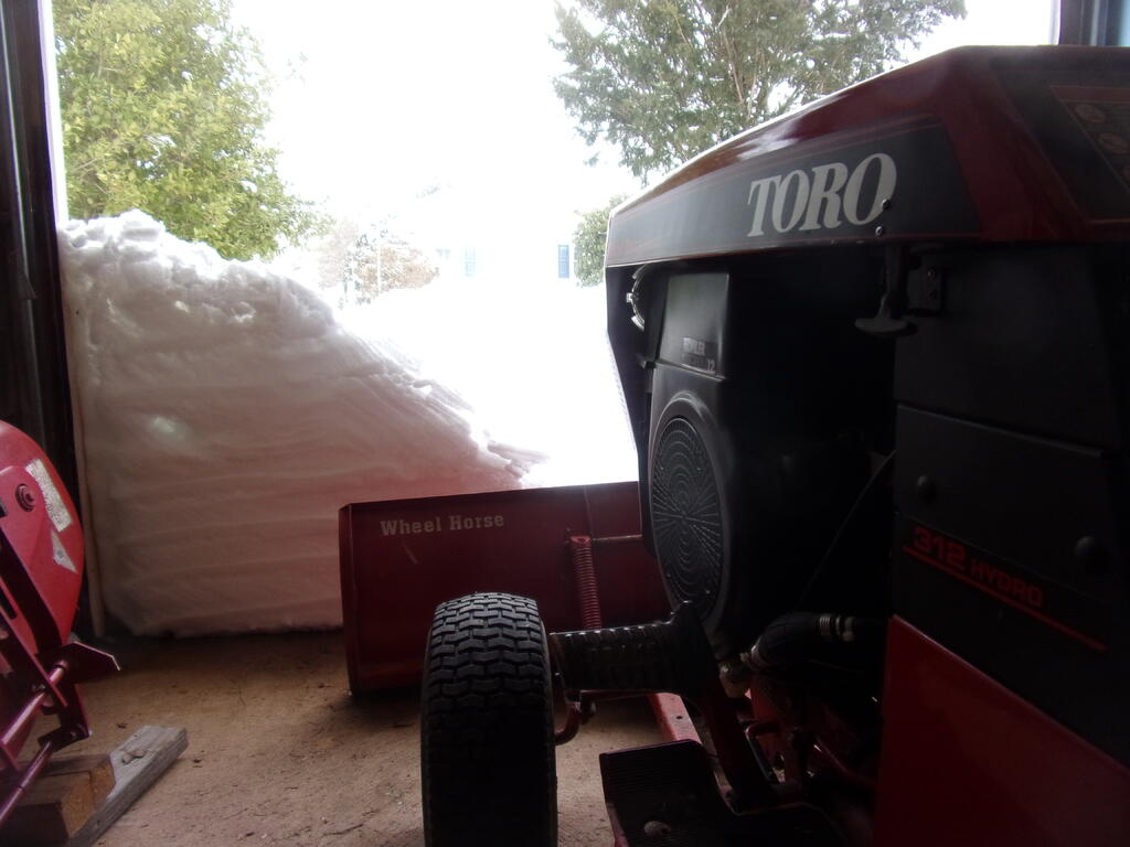

rjg854 13,341 #4 Posted February 2, 2021 Ed that sure looks like a tuff spot to get out of if that was to drift in. Great job. 1 Share this post Link to post Share on other sites

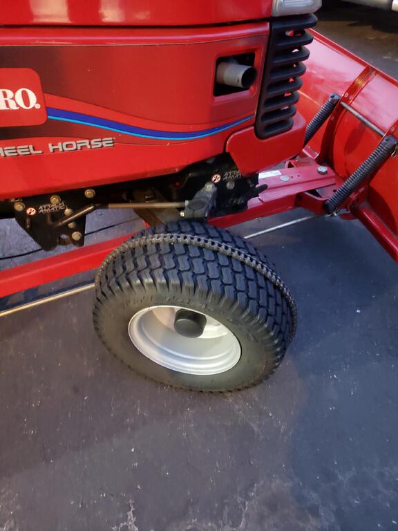

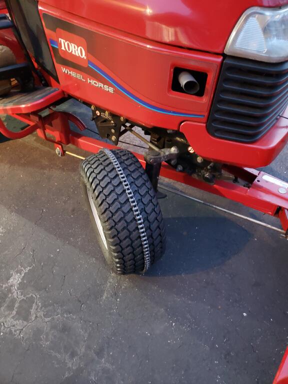

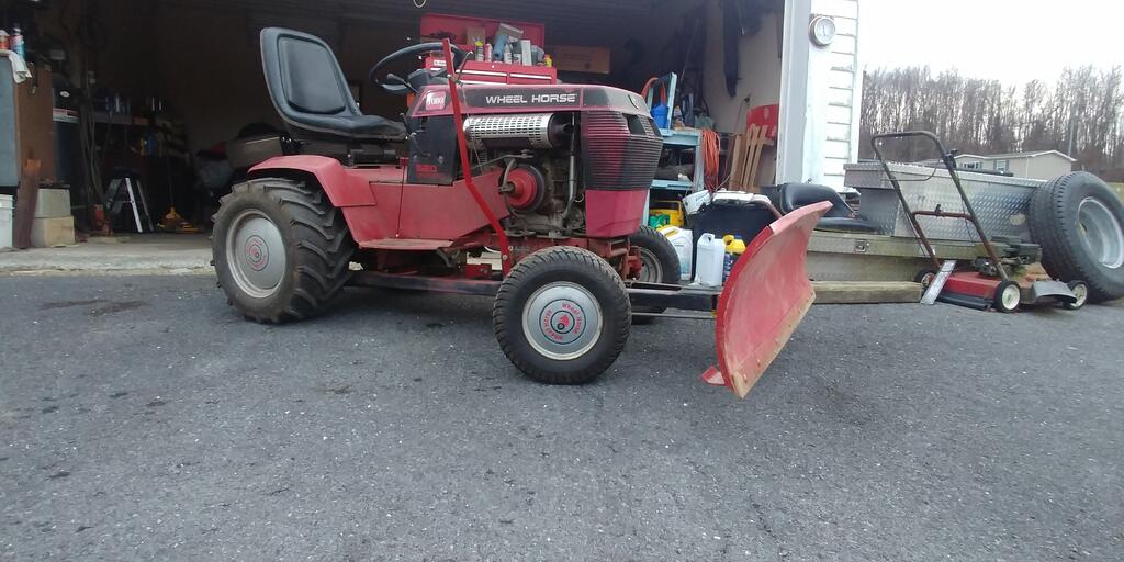

DennisThornton 4,773 #5 Posted February 2, 2021 I've got to do something with my fronts, either roller chain, different tires or roller chain. My goto snow plowing C-85 with filled rears and 2-links will overdrive my steering so until I address that there's little reason to add rear weights. And I'm very impressed with that 8hp will push! Looks like you have ice grips front and rear so what do you think, roller chain or tire chains on the front? Are your fronts filled? Share this post Link to post Share on other sites
Ed Kennell 47,266 #6 Posted February 2, 2021 7 minutes ago, rjg854 said: Ed that sure looks like a tuff spot to get out of if that was to drift in. Great job. That it is Randy and it does drift there. I use the 312 to back in trailer loads of wood. I could use the 520 , but It is easier to back in with out the cab. The old neck only has about 5 Degrees of rotation. I have always been able to get out, but my back up plan is my neighbor with his FEL on a 4WD Kubota. He watches me plow (his is one of the 5 driveways I plow) with the 520. I think his best day will be the day when I have to ask for help from his Kubota. 1 4 Share this post Link to post Share on other sites
Ed Kennell 47,266 #7 Posted February 2, 2021 10 minutes ago, DennisThornton said: I've got to do something with my fronts, either roller chain, different tires or roller chain. My goto snow plowing C-85 with filled rears and 2-links will overdrive my steering so until I address that there's little reason to add rear weights. And I'm very impressed with that 8hp will push! Looks like you have ice grips front and rear so what do you think, roller chain or tire chains on the front? Are your fronts filled? I would try the roller chain and filled tires Dennis. I don't have any weight on the fronts, and even with the 2 link chains, the 54" blade will steer the 520. I may try the roller chain over top of the existing chains. 1 1 Share this post Link to post Share on other sites
DennisThornton 4,773 #8 Posted February 2, 2021 2 minutes ago, Ed Kennell said: I would try the roller chain and filled tires Dennis. I don't have any weight on the fronts, and even with the 2 link chains, the 54" blade will steer the 520. I may try the roller chain over top of the existing chains. The roller chain is waiting for me to find the repair links... I've got enough links to build a set of chains for the fronts. But today I watched my fronts fail to steer and it seems to me that with a steering only, non-powered front that the roller chain would have been a better steering aid. Now, I was also using my TC-35 and watched my front driven R4s do nothing! There I would think I could benefit from cross chains and very little from a roller chain. 2 Share this post Link to post Share on other sites
rjg854 13,341 #9 Posted February 2, 2021 I 2nd the use of roller chains! For me it made all the difference in the world on my Commando 8 4 1 Share this post Link to post Share on other sites
emdmat1981 62 #10 Posted February 3, 2021 I'm with you guys. With the latest 8" snow in Southeast PA the plow was steering the tractor at times. Hanging weight off the back end probably doesn't help matters much. Still amazed at how much the 5xi will push (have a sacrificial blade that's all bent up that I use when pushing the heavy wet stuff) Just standard # 40 roller chain .. right? 5 1 Share this post Link to post Share on other sites
Ed Kennell 47,266 #11 Posted February 3, 2021 7 minutes ago, emdmat1981 said: Just standard # 40 roller chain .. right? That's it. Let us know how it works. 1 Share this post Link to post Share on other sites

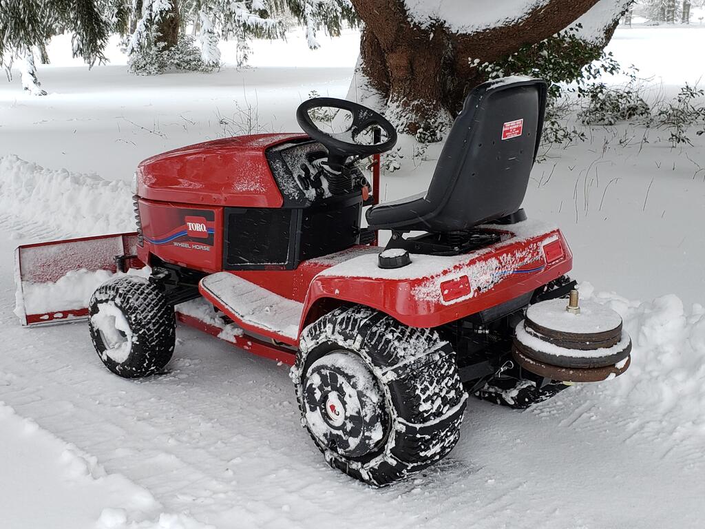

ebinmaine 80,635 #12 Posted February 3, 2021 I just recently put roller chains and weight on the front of Trina's 867 Pigpen. It made a good difference. She still needs a little more weight added. I highly recommend adding extra weights on a bracket at the front. 1 Share this post Link to post Share on other sites

bds1984 1,519 #15 Posted February 3, 2021 12 hours ago, ebinmaine said: I just recently put roller chains and weight on the front of Trina's 867 Pigpen. It made a good difference. She still needs a little more weight added. I highly recommend adding extra weights on a bracket at the front; good thing I was driving through my neighborhood on bulk trash day and saw someone was throwing out a partial weight set. Between the weights and reversed ags, that rig turns pretty good in the snow. I bolted plate weights to the front wheels of my 520H 2 Share this post Link to post Share on other sites

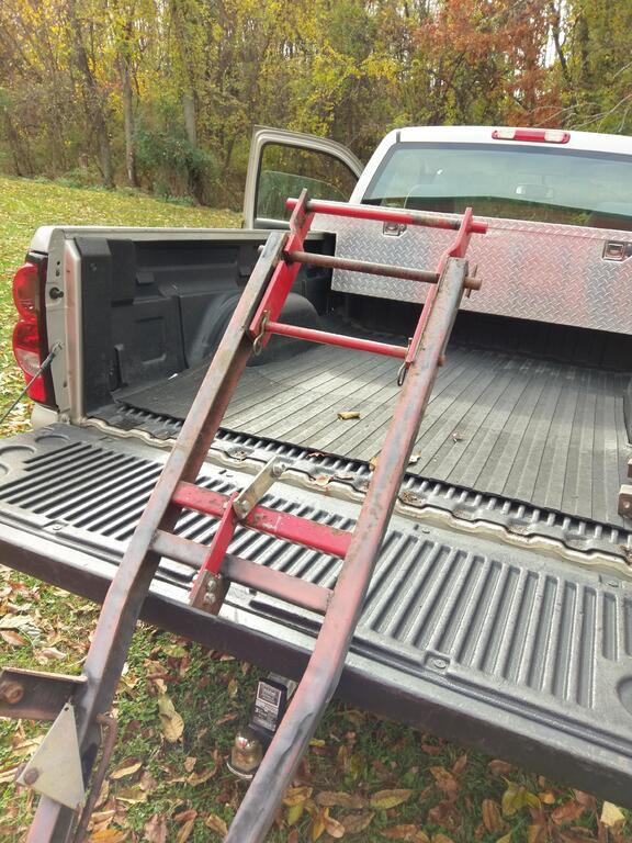

ohiofarmer 3,475 #16 Posted February 3, 2021 This is a good thread. My question is on the520 with the swept axle, is there a longer frame model for a 520 blade? The blade that came with the c-141/145 set hits the tires and will not lock in to the side sweep position.. i am at the point of deciding to make a rear extension to the frame or finishing up the little issues with the Black hood twins. Being semi retired still requires time management in that I had to decide whether or not to gamble on completing the black hoods or just mounting the blade on the 520 with the 420cc predator engine. Then Mr Murphy shows up..... Share this post Link to post Share on other sites
Lee1977 7,764 #17 Posted February 3, 2021 29 minutes ago, ohiofarmer said: This is a good thread. My question is on the520 with the swept axle, is there a longer frame model for a 520 blade? The blade that came with the c-141/145 set hits the tires and will not lock in to the side sweep position.. i am at the point of deciding to make a rear extension to the frame or finishing up the little issues with the Black hood twins. Being semi retired still requires time management in that I had to decide whether or not to gamble on completing the black hoods or just mounting the blade on the 520 with the 420cc predator engine. Then Mr Murphy shows up..... There is a additional bracket that fits on the back of the long frame plow. 1 Share this post Link to post Share on other sites
WVHillbilly520H 10,379 #18 Posted February 3, 2021 (edited) 46 minutes ago, ohiofarmer said: This is a good thread. My question is on the520 with the swept axle, is there a longer frame model for a 520 blade? The blade that came with the c-141/145 set hits the tires and will not lock in to the side sweep position.. i am at the point of deciding to make a rear extension to the frame or finishing up the little issues with the Black hood twins. Being semi retired still requires time management in that I had to decide whether or not to gamble on completing the black hoods or just mounting the blade on the 520 with the 420cc predator engine. Then Mr Murphy shows up..... You need an extension kit for the frame, its 3 parts rear, center lift point and new angle handle. Check here http://x65.d8d.myftpupload.com/product/toro-wheel-horse-520-snow-plow-ext-kit/ Edited February 3, 2021 by WVHillbilly520H 5 Share this post Link to post Share on other sites

emdmat1981 62 #22 Posted February 7, 2021 Got the # 40 Roller Chains installed today ... should get a good work out with 4-8" of snow in forecast for tomorrow ! 3 Share this post Link to post Share on other sites
ebinmaine 80,635 #23 Posted February 7, 2021 7 hours ago, emdmat1981 said: Got the # 40 Roller Chains installed today ... should get a good work out with 4-8" of snow in forecast for tomorrow ! Very nice. Be sure to take them out and do a few sharp turns BEFORE it starts to snow so you know they're nice and tight. Share this post Link to post Share on other sites
emdmat1981 62 #24 Posted February 7, 2021 Thanks Eric. That's exactly what I did. Jacked up the front, deflated tires completely, installed 51.5" of # 40 per tire (as XI has 16 x 7.5 x 8 fronts), then re-inflate to 12 lbs. Then ran it around the snow covered yard and checked for slippage (none - all tight) !!! 1 1 Share this post Link to post Share on other sites
ebinmaine 80,635 #25 Posted February 7, 2021 46 minutes ago, emdmat1981 said: Thanks Eric. That's exactly what I did. Jacked up the front, deflated tires completely, installed 51.5" of # 40 per tire (as XI has 16 x 7.5 x 8 fronts), then re-inflate to 12 lbs. Then ran it around the snow covered yard and checked for slippage (none - all tight) !!! Niiiice Share this post Link to post Share on other sites
