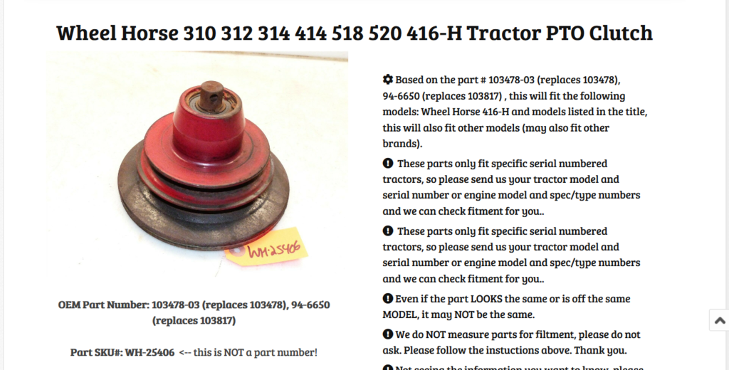

wallfish 20,219 #1 Posted February 2, 2021 Any gurus available that know if the bearings and PTO can be changed from a 418 Kohler Magnum directly onto a 520 with an Onan? Just wanted to check before I go out there and start taking them all apart to find out I froze my nuts off for nothing. Blew out the outer bearing while blowing the deep heavy DOT drifts and still have more to go. That bearing was definitely due to be changed but of coarse I procrastinated too long. Might be able to get out of the driveway for a new bearing and snap ring if it's a common size and available at TSC so that info would also be helpful if someone knows. Share this post Link to post Share on other sites
squonk 47,383 #2 Posted February 2, 2021 (edited) John, I think the bearing is the same. Napa # P204RR6 . As far as the snap ring goes I believe I just get a pack from McMaster-Carr # 99142A570 1.75" I.D O.D. 1.942" .068" thick. You can drive on down here in your van and I'll give you a couple! Or just swap the pulleys and get the snow done. I keep an extra pulley on the shelf and my feathers numbered for just such an emergency! Edited February 2, 2021 by squonk Share this post Link to post Share on other sites
wallfish 20,219 #3 Posted February 2, 2021 5 minutes ago, squonk said: John, I think the bearing is the same. Napa # P204RR6 . As far as the snap ring goes I believe I just get a pack from McMaster-Carr # 99142A570 1.75" I.D O.D. 1.942" .068" thick. You can drive on down here in your van and I'll give you a couple! Or you can drive up here and fix it! That would easier LoL It's the little snap ring right at the inner bearing race. Looks smaller than 3/4, is that a 5/8 ?It clips on that little shaft which goes to the hoop 1 Share this post Link to post Share on other sites
gwest_ca-(File Mod) 12,353 #4 Posted February 2, 2021 3/4" on the stub shaft Share this post Link to post Share on other sites
squonk 47,383 #5 Posted February 2, 2021 Oh that clip. Don't have that size in my memory banks but a "Well inventoried " hardware store should have it. I looked it up 3'4" x .046" thick. O.D. is about .082" You don't have another tractor to rob the pulley off of for now? Share this post Link to post Share on other sites
wallfish 20,219 #7 Posted February 2, 2021 All set!!! Froze me nuts off and the entire PTO assembly swapped right over. Just need to warm up a little now before going back out there. The wind is really whipping. The biggest PITA was those little bolts for the PTO brakes. The 520 had the nuts under but at least the 418 had the nuts on top. Much easier! 2 Share this post Link to post Share on other sites
