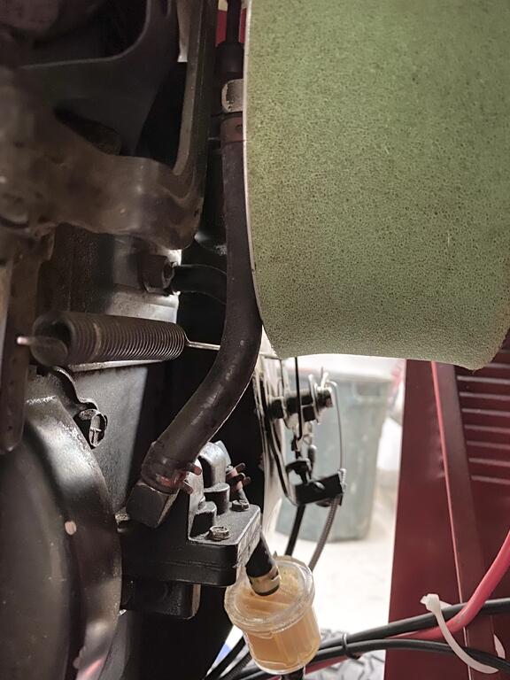

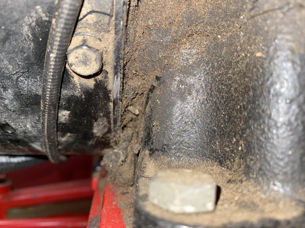

BeninCT 451 #6 Posted February 3, 2021 Whoa you guys are amazing!! i crawled all around it today and its bone dry. Even looked into the blower housing with a flashlight and between the fins I don’t really see anything. Strange. That said, the few drips I saw were after some long work for this engine after sitting for a few years. I think I will have to take off the blower housing and see what I see. Too clean otherwise. Pics under blower housing and of carb/pump. Little dirt in that crack but I blew it out with air and its all dry. Strange. Maybe only leaks once its good and hot which would make me think gasket more than a seal but who knows 1 1 Share this post Link to post Share on other sites
