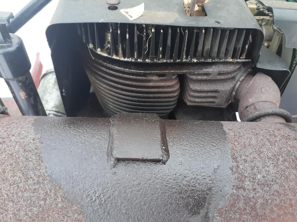

handyrandy 7 #1 Posted February 1, 2021 Hello everyone, I started up the old 312-8 kohler magnum and started plowing snow and smelled oil burning. Looked down and saw oil on the side of the head and muffler. Is this as easy as buying a new head gasket and cleaning the surfaces and bolting it back down again? I have torque wrenches but not a lot of small engine experience. I need to get it fixed pronto and need to get the parts ordered. Any suggestions or tips? Thanks in advance. Share this post Link to post Share on other sites

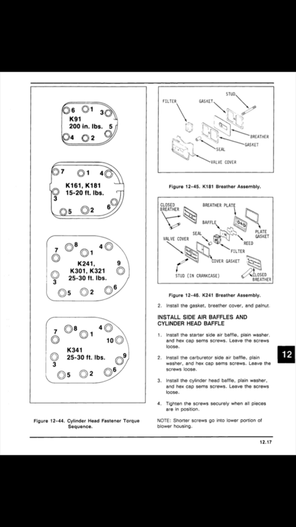

Ed Kennell 47,809 #2 Posted February 1, 2021 Not hard at all if you don't break a head bolt during removal. There are many threads on here with video describing the techniques used to clean remove the carbon of the head, block, valves, and piston. Download the manual for your engine where you will find the head bolt torque specs and tightening sequence. When I remove a head, I use the torque sequence in reverse and only loosen each bolt 1/8 of a turn until they are all loose. I never had one break. 7 Share this post Link to post Share on other sites

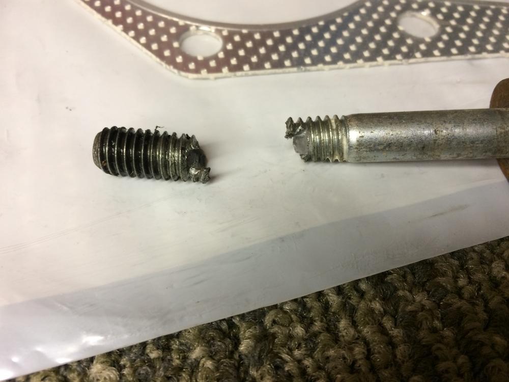

squonk 48,322 #3 Posted February 1, 2021 I had one break. But it was already broke before I broke it 2 1 1 Share this post Link to post Share on other sites
WHX?? 58,347 #4 Posted February 1, 2021 (edited) Yer a Mike.... Very easy to do. So easy even a Squonk can do it. Hardest part is taking the tins off and putiing them back on. Like Ed said de-carbon as long as your there and glass the head. This might help. headgasket.pdf Edited February 1, 2021 by WHX24 5 1 1 Share this post Link to post Share on other sites
squonk 48,322 #5 Posted February 1, 2021 59 minutes ago, WHX24 said: Yer a Mike.... Very easy to do. So easy even a Squonk can do it. Hardest part is taking the tins off and putiing them back on. Like Ed said de-carbon as long as your there and glass the head. This might help. headgasket.pdf 1.22 MB · 1 download There were bits of this head bolt missing before I even touched it. Broken piece spun out by hand 4 1 Share this post Link to post Share on other sites
midpack 1,148 #6 Posted February 1, 2021 Some good fortune there! 3 Share this post Link to post Share on other sites
Handy Don 17,670 #7 Posted February 1, 2021 26 minutes ago, midpack said: Some good fortune there! Indeed! 2 Share this post Link to post Share on other sites

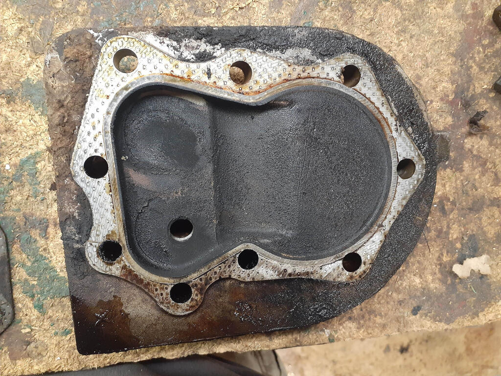

RandyLittrell 3,946 #11 Posted February 2, 2021 Along with a new gasket, check for flatness. Here is a great video. 2 Share this post Link to post Share on other sites

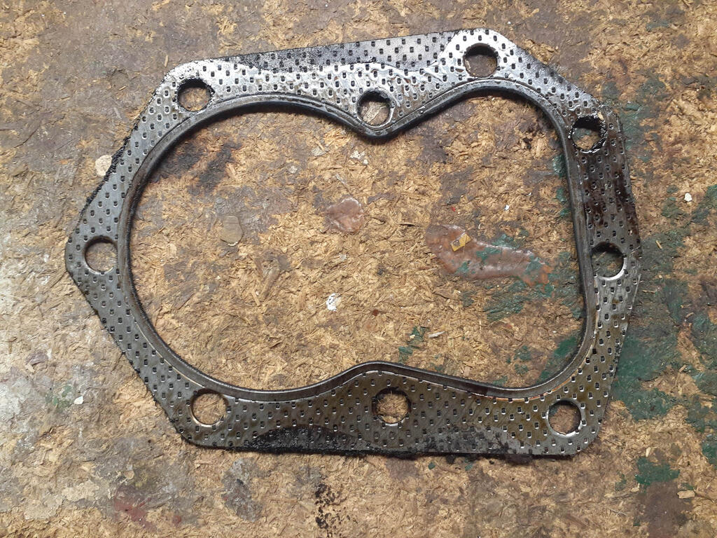

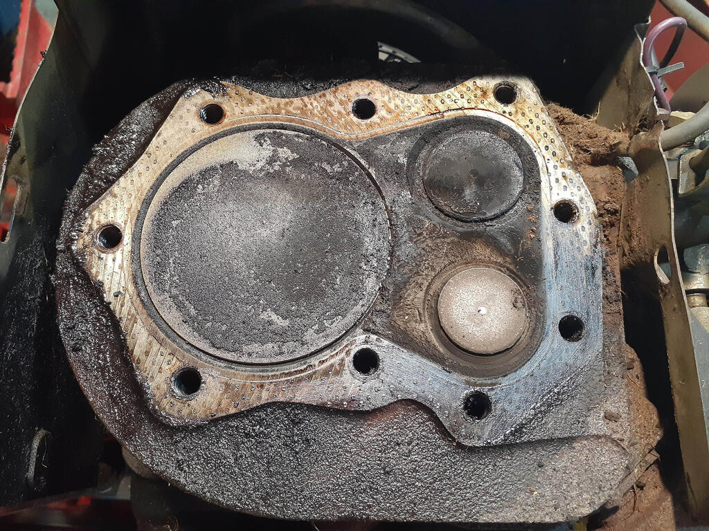

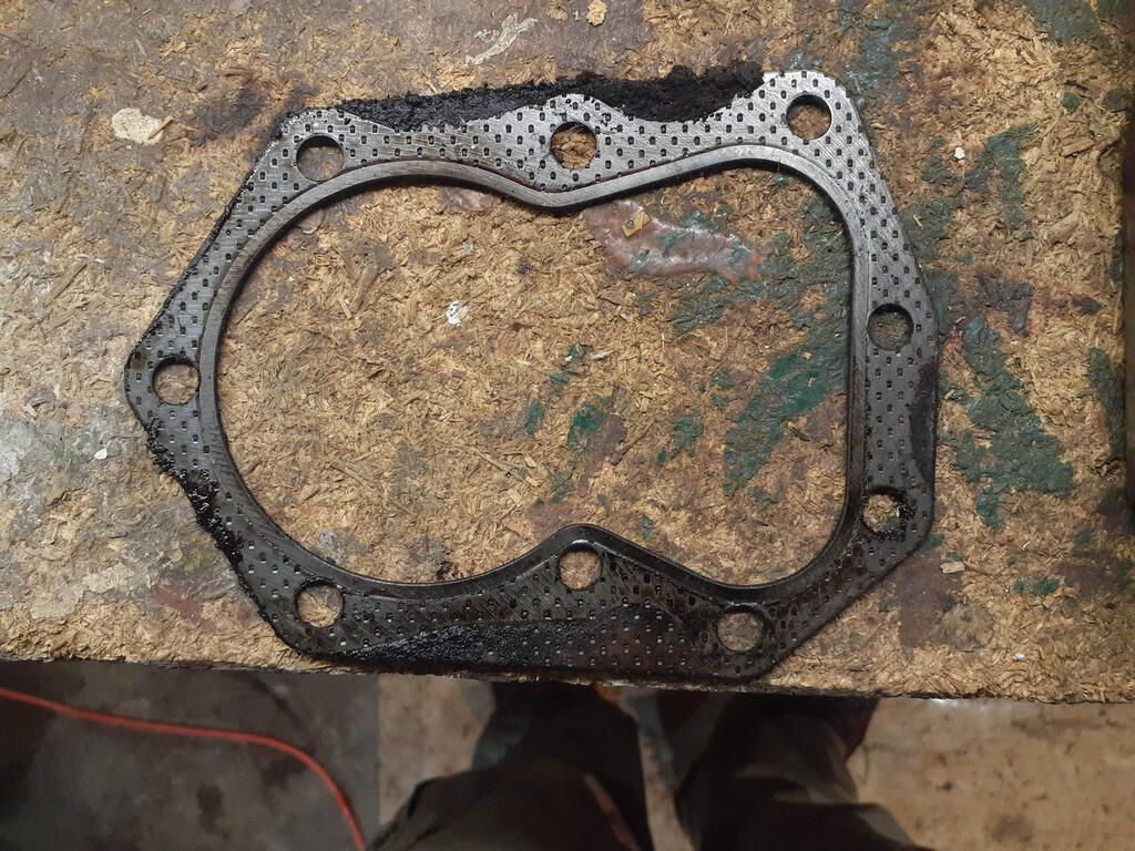

handyrandy 7 #13 Posted February 2, 2021 Thanks everyone for the great help. I took the head off today and first thing I noticed was the head bolts where all loose. I photographed the parts. To me everything looks pretty good. I may just clean it all up and put it back together the way it is and see what happens. What do you guys think? I will take the head down to my brothers and check for warpage on his milling machine table. I was afraid I would see all kind of head and gasket damage. I think I am very fortunate. Also is there some cleaner I can get to clean all the carbon deposits off easily? 1 Share this post Link to post Share on other sites
Pullstart 71,516 #14 Posted February 2, 2021 A wire brush or drill attachment do pretty good to remove the deposits. I wouldn’t recommend it, but one of my 8 hp machines have red RTV on both sides of the head gasket and it’s holding strong since 2008. I did it to see how long it would last. 1 Share this post Link to post Share on other sites

Tuneup 1,459 #19 Posted February 4, 2021 The blowby through that gasket likely ruined it. That same blowby focused added heat in the leaky areas through the gasket and likely warped the head. Plan on replacing the gasket and planing the head with some sandpaper on a good surface when you have a chance. It's an easy thing to do as you've found out and the gasket is cheap. For now, she'll be happy to get you through the winter storms. Share this post Link to post Share on other sites
