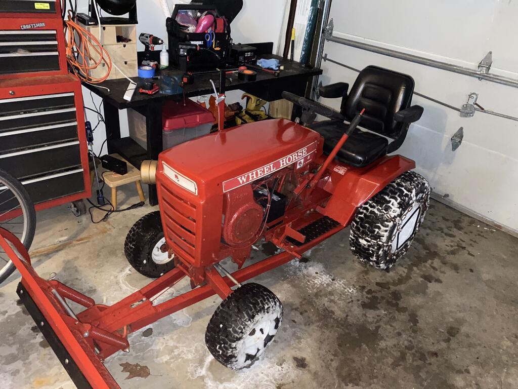

TonyBer 71 #1 Posted January 31, 2021 (edited) Hello, I'm new to the hobby and recently purchased this. The model# says 0 120 8 but if I look at the post chart it shows 0120 as an 8 speed and this is only a 4spd? I thought is was a 1973? Currently there is a snow plow and with a fairly flat driveway I bought it recently when my snow blower wouldn't start for the 50th time. This baby cranks right up with one turn and runs great. I'd like to get a mower deck and don't know for sure what will work. I'm looking for a 36" deck. Anything special I should know or look for? Thanks for your help in advance. Tony Edited January 31, 2021 by TonyBer 2 Share this post Link to post Share on other sites
ebinmaine 76,178 #2 Posted January 31, 2021 That's a beautiful tractor! 1-0120-8 is a 1973 8HP 4 speed. That's the model. In 1973 there was no other designation. One of the favorite engines of many of the Wheelhorse folks. Please do feel free to put a want ad up for a deck. 3 Share this post Link to post Share on other sites

AHS 1,566 #7 Posted February 2, 2021 That 8hp is a beauty! Wow! 😀 2 Share this post Link to post Share on other sites
