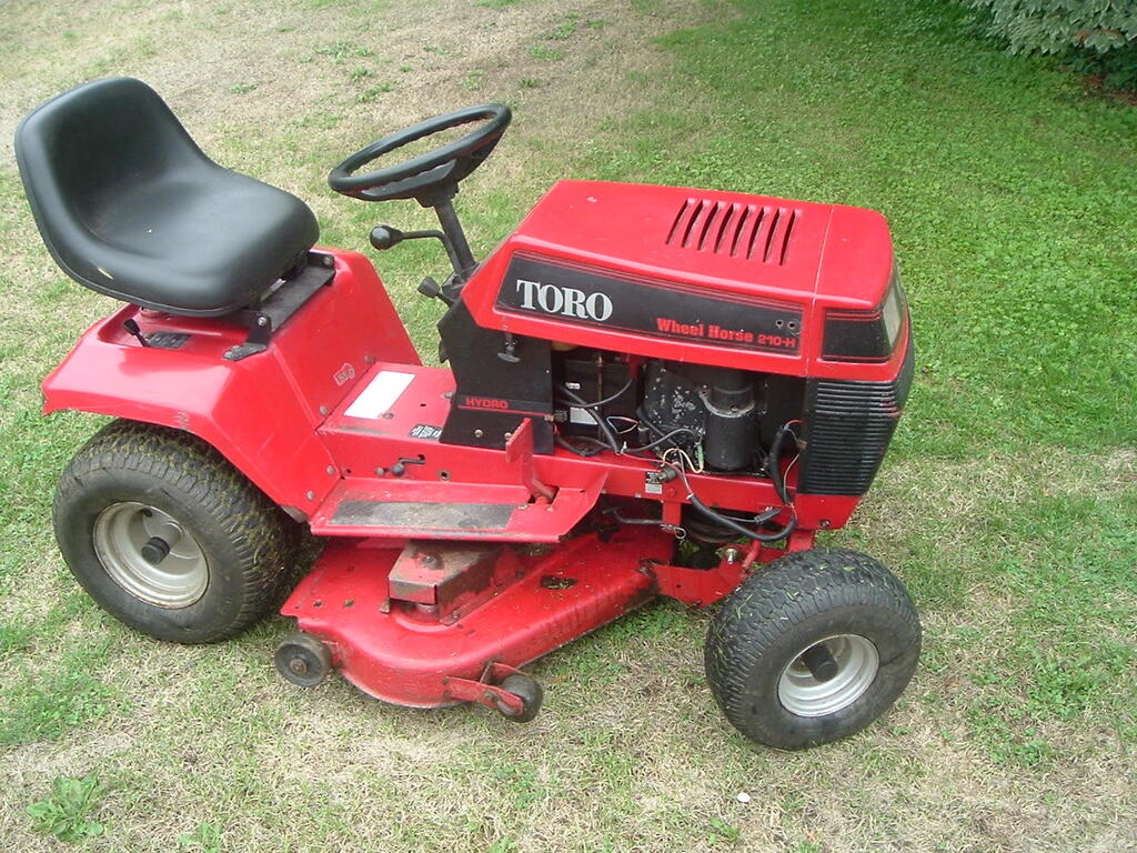

squonk 47,384 #4 Posted January 31, 2021 I had this 210-H for 20 years. bought it new in 1990 with a factory snowblade, plastic weights and chains. After the superstorm in 93 I bought a used Simplicity blower from my neighbor. I used to clean a large area in front of my house along a state highway. You can imaging the amount of snow the state boys left in the spot. This little tractor never let me down. 3 Share this post Link to post Share on other sites

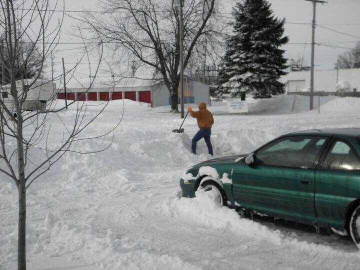

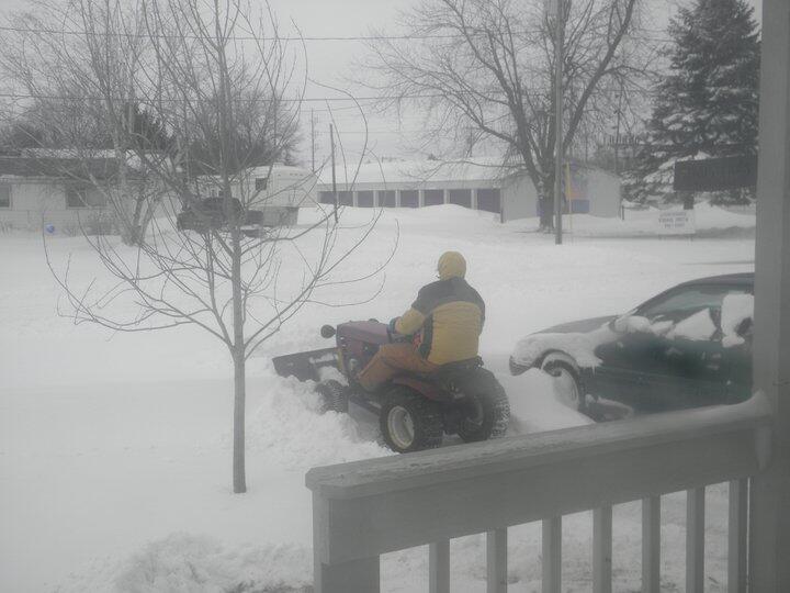

Raider69 125 #5 Posted January 31, 2021 1 hour ago, squonk said: I had this 210-H for 20 years. bought it new in 1990 with a factory snowblade, plastic weights and chains. After the superstorm in 93 I bought a used Simplicity blower from my neighbor. I used to clean a large area in front of my house along a state highway. You can imaging the amount of snow the state boys left in the spot. This little tractor never let me down. I live on a busy US highway so I definitely feel your pain. This was a few years ago, that little tree in the picture is now about 45 feet tall! I'm 6' 2" to give you some perspective on the snow pile. Even my B-100 with chains and 67 Lbs. of RV anti-freeze in each rear tire wasn't up to this crap. They plowed the highway AND shoulder during the night and by the time I could get out to start the cleanup there was a pile of packed snow 3 to 4 feet high and 6 to 8 feet wide at the base plugging the end of my driveway. The "Mighty B" put up a good fight and pushed snow that was well over the blade but you can't fight the DOT....... I finally admitted defeat and hired somebody with an end loader to dig out the wall at the end of the driveway. The B is getting a makeover this year, 4 new tires, a tune up at least with a possible upgrade to a K301, more weight at both ends and not least of all I'm FINALLY going to install the hydraulic lift I bought from a member here many moons ago so I can mount the 42" snowblower I have for it again. I had it on one winter and it was a snow throwing beast but it was also a back breaker. 2 Share this post Link to post Share on other sites
