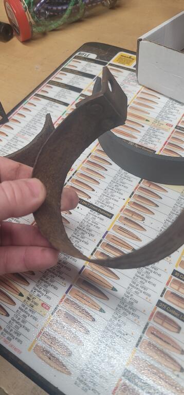

haydendavid380 759 #4 Posted January 30, 2021 I guess I was wrong What I saw loose around the drum was the separated material not the actual band Share this post Link to post Share on other sites

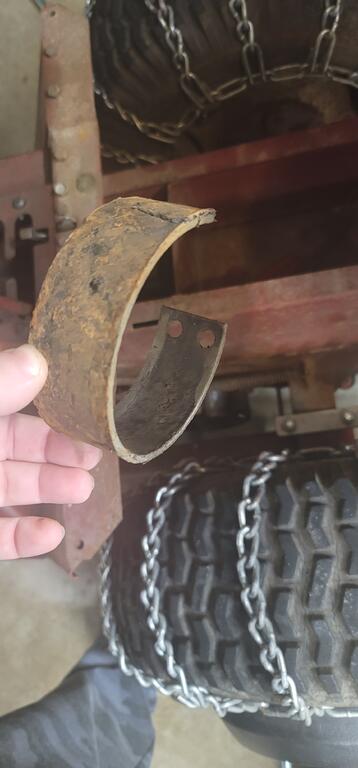

haydendavid380 759 #5 Posted January 30, 2021 Is this band still usable if I take a wire wheel to it? Also, what adhesive are you guys using to attach the new linings? Share this post Link to post Share on other sites
stevasaurus 23,662 #6 Posted January 30, 2021 Looks like it is still good from here. Bathroom silicone calk will work great to hold that lining. Share this post Link to post Share on other sites
haydendavid380 759 #7 Posted January 30, 2021 This is how it came out after putting a wire wheel on it to knock off all the rust Sprayed it down with brake cleaner, spread glue down to both surfaces, and clamped it for about 4 hours Got everything back together once the glue was tacky enough to hold the material to the back during installation, and then tightened it down and set the parking brake. Hopefully everything will be golden by tomorrow morning to shove around some snow. 1 Share this post Link to post Share on other sites
haydendavid380 759 #8 Posted January 31, 2021 Evening worked like it should. Thanks guys Share this post Link to post Share on other sites
