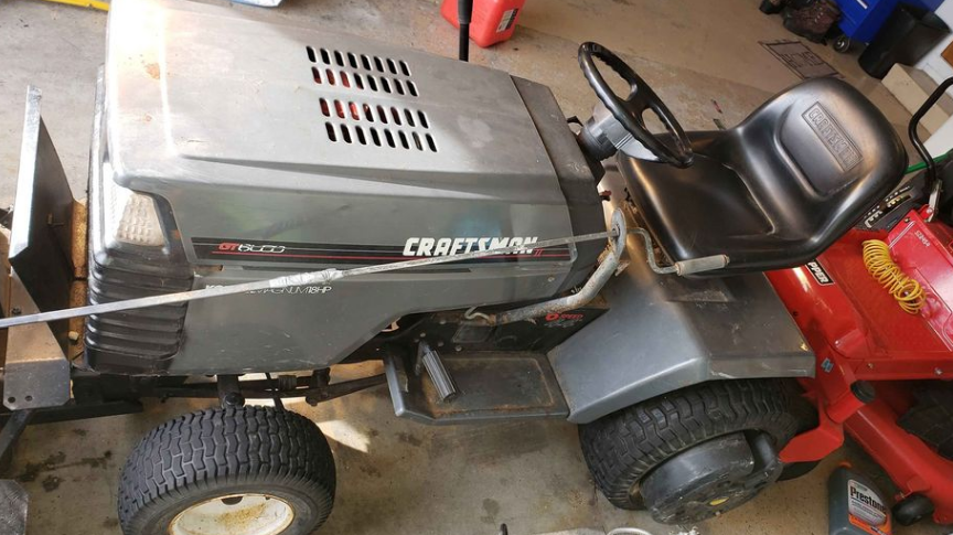

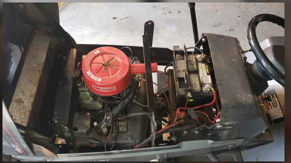

JoeM 9,622 #14 Posted January 30, 2021 Maybe another economical option, Briggs Vanguard V twin out of a Cub. I've done two 16HP and they run real good. Some of those 90 ish vintage cubs are going for less then 300 and might be able to hear it run before you buy. Down side was the exhaust needing modified and 1 inch to 1 1/8 sleeve for drive pulley. 3 1 Share this post Link to post Share on other sites
Bill D 2,598 #15 Posted January 30, 2021 5 hours ago, wh5208speed said: I would look for a Craftsman GT 6000 as a donor tractor. It has the twin cylinder Kohler Magnum with the same output shaft. They can be had pretty cheap ($250-700 depending on the condition). Any Magnum from another machine will require use of an electric clutch. Only WH spec Magnums had the necessary thrust bearings. Also, some older Sears tractors came with Briggs boxer twins that can be swapped in. Those engines should have ball bearings on the crankshaft and be able to handle the side loading from the PTO. Sears also put Onans in some tractors. Briggs boxer twins can also be found in some older Snapper tractors as well. 1 Share this post Link to post Share on other sites

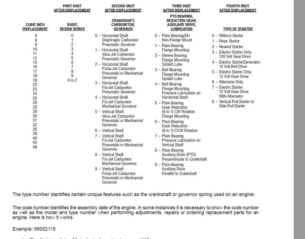

Bill D 2,598 #18 Posted February 1, 2021 @gwest_ca. Garry do you have a chart from Briggs that shows which boxer twins came with ball bearing supported crankshafts. Someone gave me one awhile back in another thread, but I can't find it now. Thanks. Share this post Link to post Share on other sites
pfrederi 19,894 #19 Posted February 1, 2021 58 minutes ago, Bill D said: @gwest_ca. Garry do you have a chart from Briggs that shows which boxer twins came with ball bearing supported crankshafts. Someone gave me one awhile back in another thread, but I can't find it now. Thanks. Share this post Link to post Share on other sites
Bill D 2,598 #20 Posted February 1, 2021 On 1/30/2021 at 2:02 AM, JoeM said: Maybe another economical option, Briggs Vanguard V twin out of a Cub. I've done two 16HP and they run real good. Some of those 90 ish vintage cubs are going for less then 300 and might be able to hear it run before you buy. Down side was the exhaust needing modified and 1 inch to 1 1/8 sleeve for drive pulley. I like this. Any more pictures, or is there a thread detailing how exactly you did the swap? Thanks. Bill Share this post Link to post Share on other sites
JoeM 9,622 #21 Posted February 1, 2021 1 hour ago, Bill D said: Any more pictures That is about all I got. I know I had to raise up about an inch to make the belt alignment. I One machine I used channel the other was threaded blocks welded to the original 520 plate. And the ignition switch is different because the vanguards don't use a coil. Share this post Link to post Share on other sites
