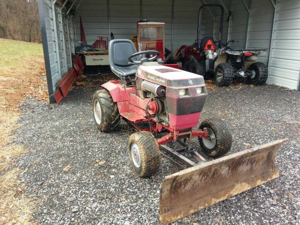

stevasaurus 23,857 #3 Posted January 29, 2021 When you say..."older blade" do you mean the "A" frame type? If so, you may find that when mounted you may not be able to angle the blade because it will hit the front tires. older type newer type Share this post Link to post Share on other sites
snowhound 106 #4 Posted January 30, 2021 It's like the second photo and clears the tires when angled but the arm to angle the blade doesn't clear the muffler. I believe I need one of the arms that has two 90 degree bends and uses a cable to pull the pin to angle the blade Share this post Link to post Share on other sites
953 nut 69,822 #5 Posted January 30, 2021 10 minutes ago, snowhound said: It's like the second photo and clears the tires when angled but the arm to angle the blade doesn't clear the muffler. I believe I need one of the arms that has two 90 degree bends and uses a cable to pull the pin to angle the blade I just sent you a PM with pictures of the later model arm. Share this post Link to post Share on other sites
