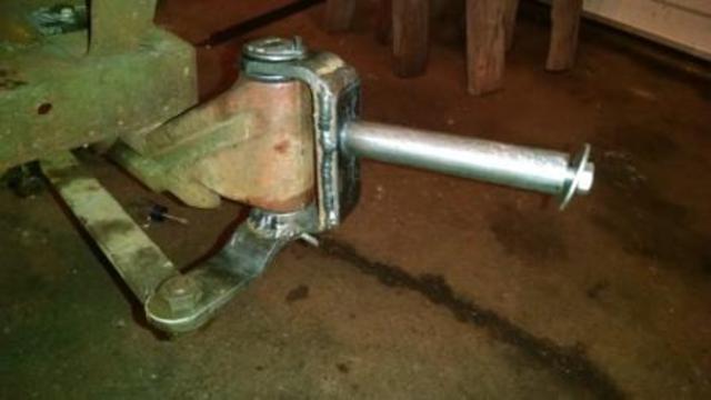

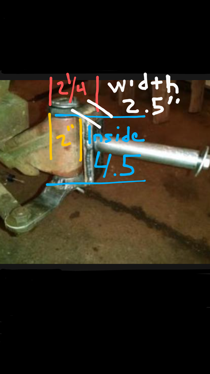

Oldskool 6,678 #81 Posted January 26, 2021 7 minutes ago, ebinmaine said: So if I use a c type spindle I can adjust for both height and width.. I'm not familiar with this style. Any pics? 2 Share this post Link to post Share on other sites
ebinmaine 81,048 #82 Posted January 26, 2021 18 minutes ago, Oldskool said: I'm not familiar with this style. Any pics? I do but it's not mine to share... @Achto Can I post that pic? 1 Share this post Link to post Share on other sites
Achto 32,891 #83 Posted January 26, 2021 9 minutes ago, ebinmaine said: @Achto Can I post that pic? I got it. 2 2 Share this post Link to post Share on other sites
ebinmaine 81,048 #84 Posted January 26, 2021 @Achto Thanks mister @Oldskool There you go. I'm going to build a similar thing and weld the trailer stub axle right to the outside instead of a piece of 3/4 rod. 1 Share this post Link to post Share on other sites
Achto 32,891 #85 Posted January 26, 2021 (edited) 8 hours ago, ebinmaine said: I'm going to build a similar thing and weld the trailer stub axle right to the outside instead of a piece of 3/4 rod. For mine I drilled a hole through the vertical portion of the C so that the spindle passes through it. It is only welded on the inside of the C, I thought this to be stronger than butt welding the 2 together. Plus it left a clean surface for the bearing to set against. Edited January 26, 2021 by Achto 3 Share this post Link to post Share on other sites
ebinmaine 81,048 #86 Posted January 26, 2021 4 minutes ago, Achto said: For mine I drilled a hole through the vertical portion of the C so that the spindle passes through it. It is only welded on the inside of the C, I thought this to be stronger than a butt welding the 2 together. Plus it left a clean surface for the bearing to set against. Yes sir. I'll be doing the same. I'll most likely be welding the steering knuckle tab at the top instead of the bottom because it lines up better. 1 2 Share this post Link to post Share on other sites

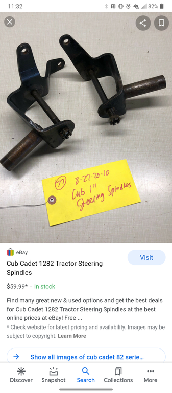

Oldskool 6,678 #87 Posted January 26, 2021 1 hour ago, Achto said: I got it. I was thinking this might be what you were getting at 2 Share this post Link to post Share on other sites
ebinmaine 81,048 #88 Posted January 26, 2021 Here's how it'll be made... 1 1 Share this post Link to post Share on other sites
WVHillbilly520H 10,379 #89 Posted January 26, 2021 5 minutes ago, ebinmaine said: Here's how it'll be made... Why didn't you just say Cub Cadet spindles??? 1 2 1 Share this post Link to post Share on other sites
ebinmaine 81,048 #90 Posted January 26, 2021 1 minute ago, WVHillbilly520H said: Why didn't you just say Cub Cadet spindles??? Niiiice.... The things ya learn everyday... 1 1 Share this post Link to post Share on other sites

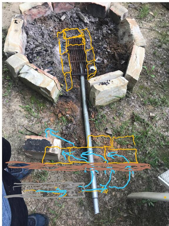

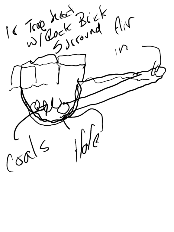

Wheel Horse 3D 3,827 #93 Posted March 18, 2021 (edited) On 1/24/2021 at 1:10 PM, ebinmaine said: Love this site. . Asks question and within just a few minutes several answers. The "torch" is just a handheld with an old black tank. I don't remember what's in it. I did try to bend a piece experimentally. The torch I have just doesn't get anything to do with red hot. I was able to bend it with a 3 foot piece of iron pipe and a large me for leverage. I found that the last 2" just before the bend was not quite straight. Perhaps a slightly smaller diameter and longer piece of pipe would work better. Ideally of course... More heat. Throw ya a few bricks together with a blowdrier or small fan EB! make ya a temp forge. or even an inground hole forge. Nothin like a forge for heatin and bendin! I keep me a bucket of coal picked from the train tracks for just such an occasion, but hardwood or charcoal does well too. Edited March 18, 2021 by Wheel Horse 3D 1 2 Share this post Link to post Share on other sites
ebinmaine 81,048 #94 Posted March 18, 2021 5 minutes ago, Wheel Horse 3D said: an inground hole forge. You know that's not a bad idea at all. You got any links about that or ideas you want to share I'd be all ears and so would My Female Paint Department BBT Honey. Share this post Link to post Share on other sites
Wheel Horse 3D 3,827 #95 Posted March 18, 2021 6 minutes ago, Wheel Horse 3D said: Throw ya a few bricks together with a blowdrier or small fan EB! make ya a temp forge. or even an inground hole forge. Nothin like a forge for heatin and bendin! I keep me a bucket of coal picked from the train tracks for just such an occasion, but hardwood or charcoal does well too. 1 1 Share this post Link to post Share on other sites
ebinmaine 81,048 #96 Posted March 18, 2021 I don't have any coal or charcoal but I've got all kinds of hardwood seeing as to how we live in a forest that's 70% beechwood. Share this post Link to post Share on other sites
Wheel Horse 3D 3,827 #98 Posted March 18, 2021 (edited) Hers a pic of one buddy was tryin and i sketched some improvement suggestions Once ya get good coals confine that space as much as ya can without killing air flow Edited March 18, 2021 by Wheel Horse 3D 1 Share this post Link to post Share on other sites
Ed Kennell 47,750 #99 Posted March 18, 2021 I like the forge idea. Just be careful with the bricks or stones. They will explode if they contain moisture. 1 Share this post Link to post Share on other sites
