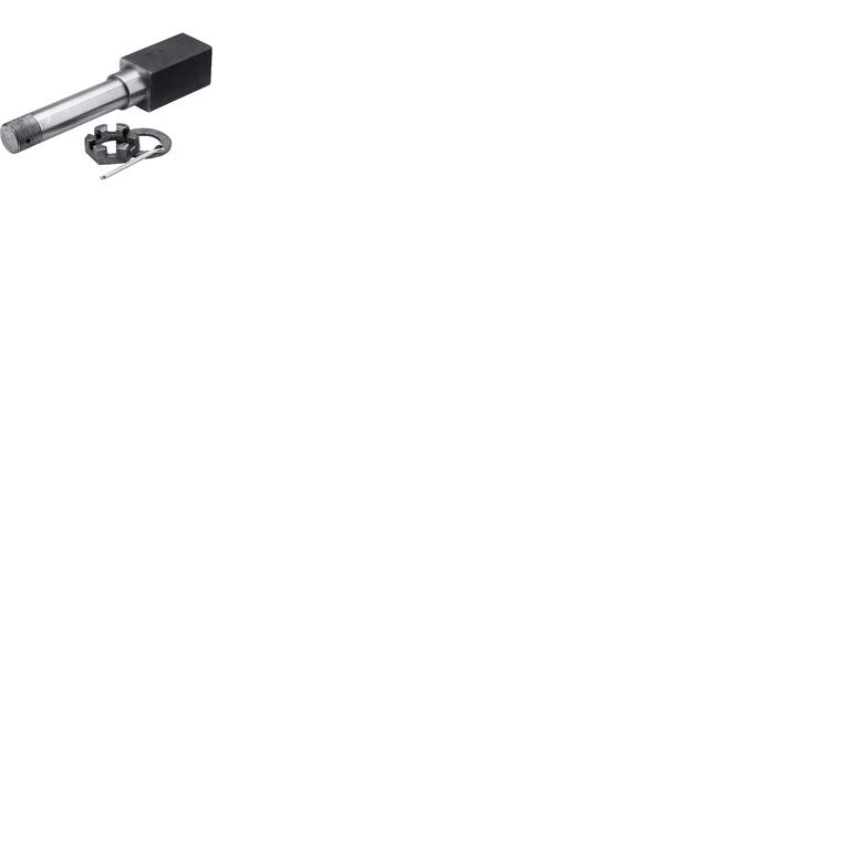

wallfish 20,515 #28 Posted January 24, 2021 (edited) Depending on your tools, Is it easier to bend the 3/4 rods or drill a 3/4 hole? Maybe something like this to weld a 3/4 rod into. Might be stronger too. $20 from Northern tool but may find them less expensive somewhere else Edited January 24, 2021 by wallfish 5 1 Share this post Link to post Share on other sites
RandyLittrell 3,945 #29 Posted January 24, 2021 27 minutes ago, wallfish said: Depending on your tools, Is it easier to bend the 3/4 rods or drill a 3/4 hole? Maybe something like this to weld a 3/4 rod into. Might be stronger too. $20 from Northern tool but may find them less expensive somewhere else This is what I was going to suggest!! If you are not confident in your welding to do this, you could drill it, fab it, then tack weld it together. Then take it somewhere and have them weld it up. If all they gotta do is weld, shouldn't cost much. Randy 2 Share this post Link to post Share on other sites

ebinmaine 80,390 #34 Posted January 24, 2021 5 minutes ago, Oldskool said: So did you get them bent? Not to the sharpness that I need. @wallfish @RandyLittrell the idea of the square spindles has crossed my mind and may very well be the way to go. 2 Share this post Link to post Share on other sites

Oldskool 6,678 #36 Posted January 24, 2021 Just now, ebinmaine said: Not to the sharpness that I need. @wallfish @RandyLittrell the idea of the square spindles has crossed my mind and may very well be the way to go. The square spindles would give you roughly the same type the GT14 has 1 1 Share this post Link to post Share on other sites

ebinmaine 80,390 #44 Posted January 25, 2021 27 minutes ago, Oldskool said: The square spindles would give you roughly the same type the GT14 has 27 minutes ago, RandyLittrell said: That's the video I watched to get the idea... 1 Share this post Link to post Share on other sites
