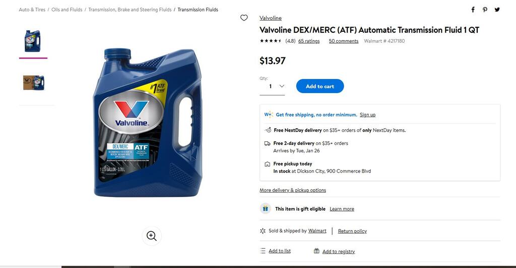

pfrederi 17,146 #4 Posted January 24, 2021 Dex/Merc will work just fine. Easy to find, many brands to chose from...Been using it in my 6 Sunstrands for many years now. 2 Share this post Link to post Share on other sites
squonk 38,909 #5 Posted January 24, 2021 36 minutes ago, pfrederi said: Dex/Merc will work just fine. Easy to find, many brands to chose from...Been using it in my 6 Sunstrands for many years now. Hope that add is a mis-print. A qt. should be around $6.50 . The picture shows a gallon jug. Now that would be a good deal at that price. I remember selling Napa 75-200 for a buck 99. 18 years ago. 2 Share this post Link to post Share on other sites
pfrederi 17,146 #6 Posted January 24, 2021 1 minute ago, squonk said: Hope that add is a mis-print. A qt. should be around $6.50 . The picture shows a gallon jug. Now that would be a good deal at that price. I remember selling Napa 75-200 for a buck 99. 18 years ago. I just grabbed the first google picture sorry. You are right that price is ridiculous but it is a Wally world ad Second search most were $22-26 a gallon... Share this post Link to post Share on other sites

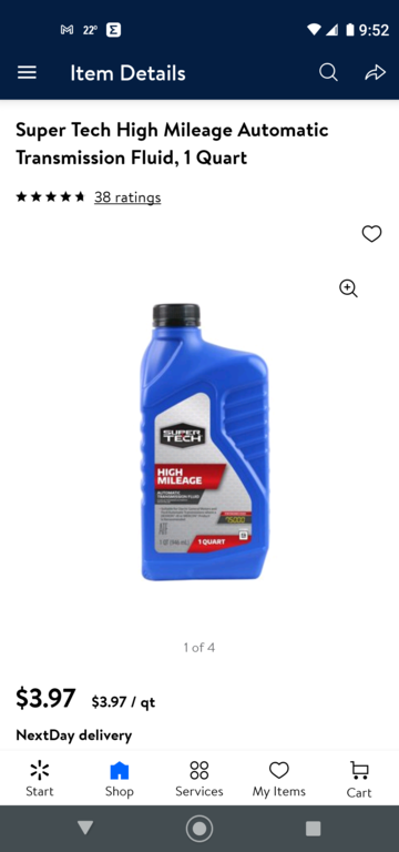

rmaynard 14,888 #7 Posted January 24, 2021 Speaking of Walmart, I just grabbed 6 of these at $3.97 each to try in my 875. 2 Share this post Link to post Share on other sites
