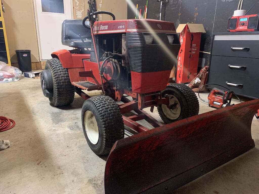

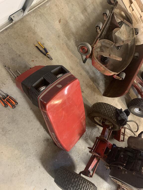

PA Horseman 20 #3 Posted January 23, 2021 Here are a few photos to start...my tractor is a 416-8 that was probably one of the earliest made, with white wheels and decals that don’t match the ‘85 310-8 I’ve been borrowing from my dad. I can’t read the tractor serial plate. It came with a barely used 48” SD deck and the plastic WH rear wheel weights. It needed some TLC after having sat for a year without running. Previous owner couldn’t get it started when I went to look at it, so when I got it home it got new fuel lines, an inline filter, a carb rebuild and cleaning, a fresh plug and fuel, and I have a new set of points on the way. I’ve also had to seal some cracks on the muffler, cut new rods for the hood pivot, and put some LED headlights on it. This thing is a beast. Looks great with a blade on it. The biggest issues left with it are a slow oil leak where the transmission input is, a broken dash where the steering column runs through, and a non-working voltmeter. 8 2 Share this post Link to post Share on other sites

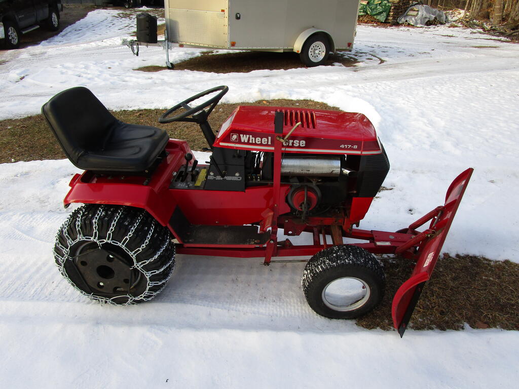

JCM 11,250 #6 Posted January 23, 2021 @PA Horseman Just checked out my 48'' dozer blade Model # 0648BC03 Serial # 1061044 and tried to measure this mounted on the 417-8. It appears to be 31 3/4'' long center to center with a 1 1/4'' right angle bend on each end and 1/2'' diameter solid rod. Toro part #104338 $ 69.24 With 2 hairpins # 9335124 or make your own rod. If you look on Parts tree you will see the orientation of the right angle bends. Hope this helps. 2 4 Share this post Link to post Share on other sites

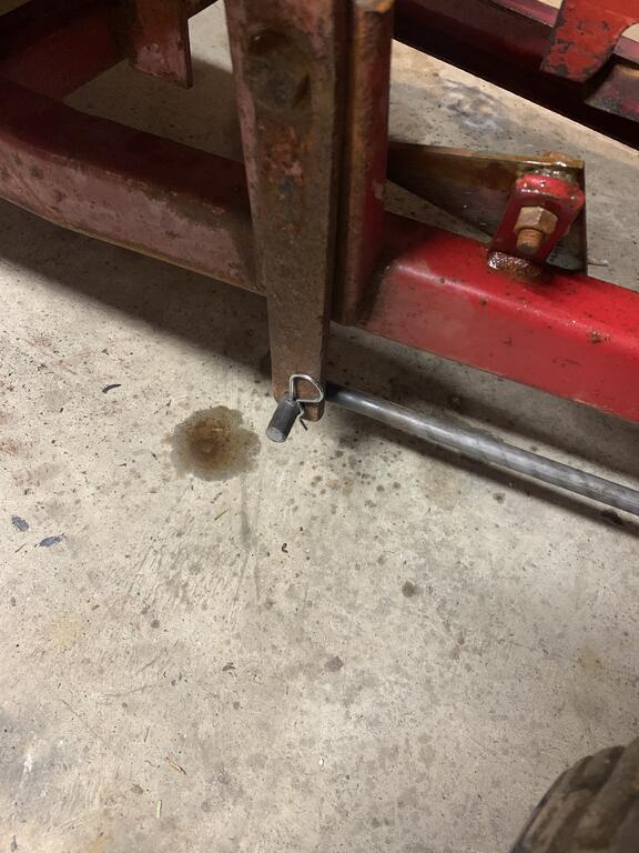

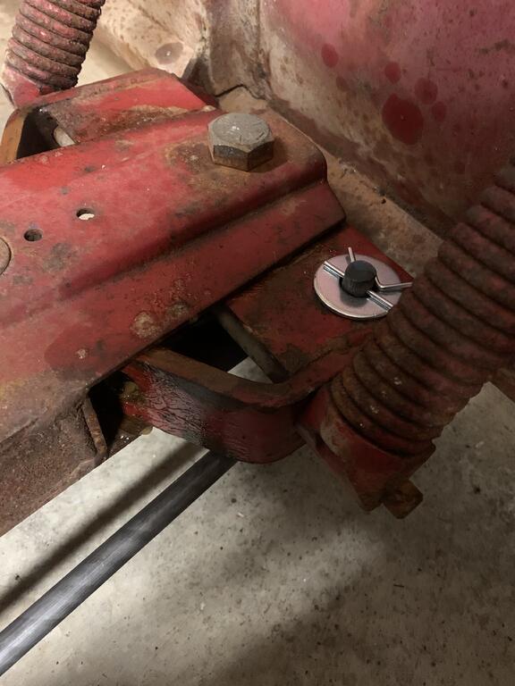

PA Horseman 20 #10 Posted January 24, 2021 (edited) 4 hours ago, WVHillbilly520H said: You can find a lot of things I made for the snow plows here... And Jim has the dimensions above if I didn't include in my thread. This is why I love Wheel Horses...the absolute simplicity of them. I just went to Home Depot and got rod and R clips for $8 and made the rod with your notes in about 30 minutes time. Here’s the final results, hopefully we’ll get some snow Monday to try it out!! Thanks to all for the help 😁 Edited January 24, 2021 by PA Horseman 3 4 Share this post Link to post Share on other sites
