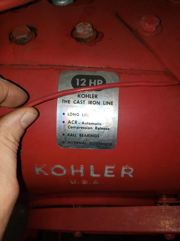

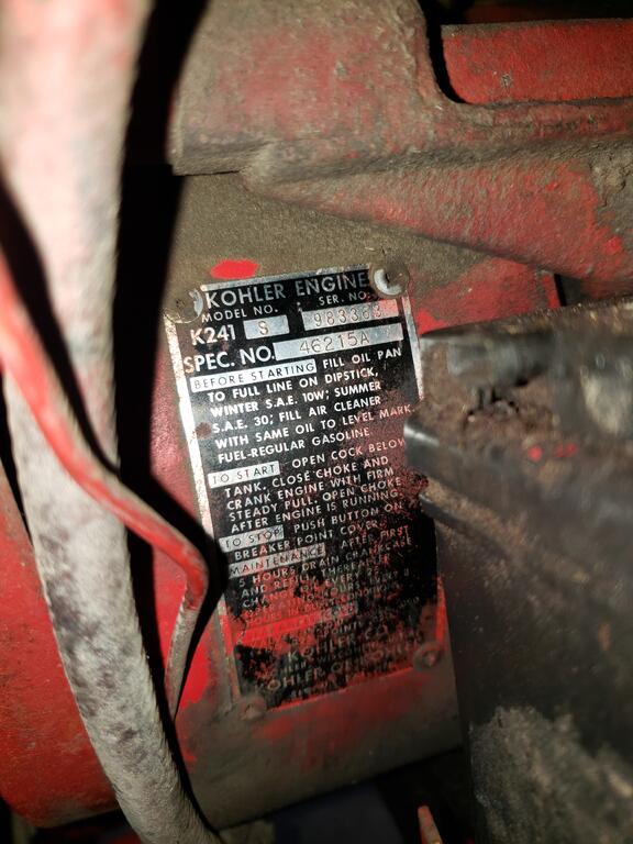

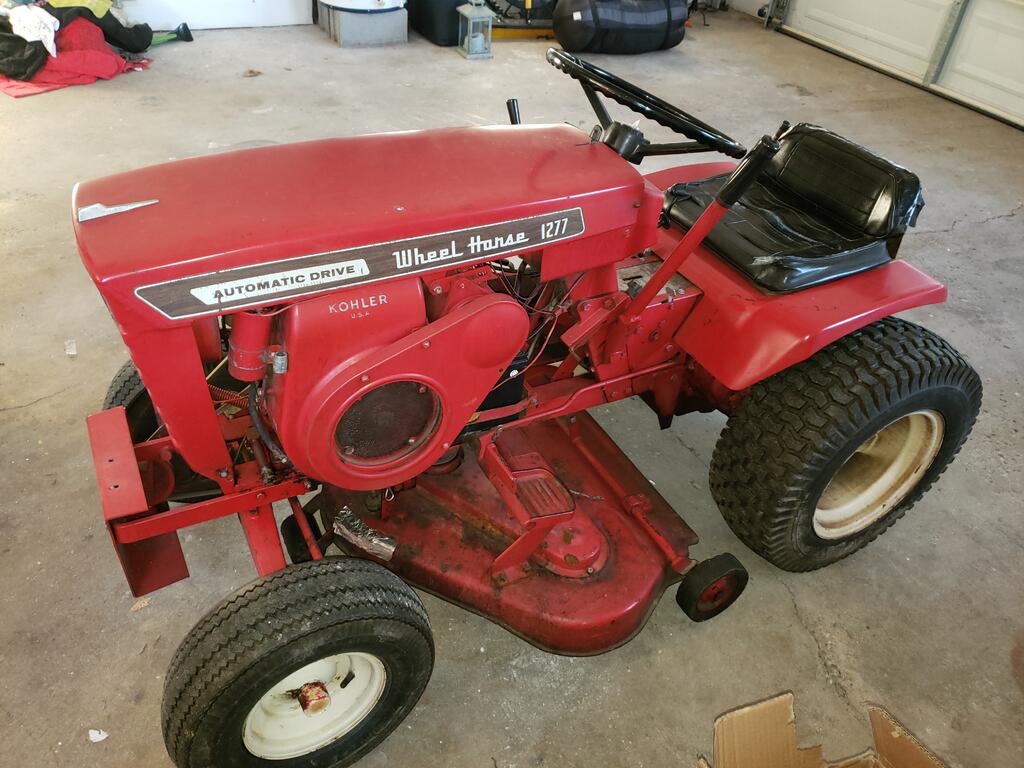

CB1993 34 #1 Posted January 23, 2021 Hello I recently purchased a 1277. It is my first. It is a 1277 I believe this model is supposed to have a 12 hp engine. Based on the engine tag I think I have a 10 hp engine. Could this be a replacement engine? I have attached some pictures. Thanks for any input. 4 Share this post Link to post Share on other sites
Ed Kennell 47,403 #2 Posted January 23, 2021 to the Looks like someone did some decal switching. Do you have the tractor model numbers? The only way I know to verify HP is to remove the head and measure the bore. 10 HP bore is 3.25 12 HP is 3.37 4 Share this post Link to post Share on other sites

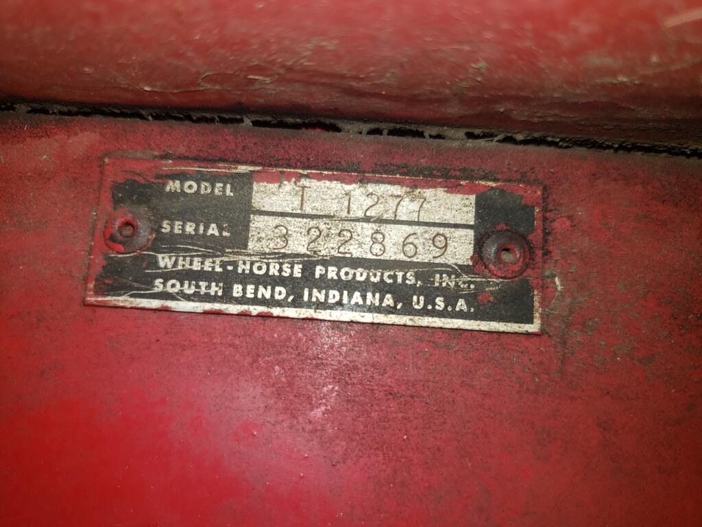

CB1993 34 #3 Posted January 23, 2021 Where can I find the tractor model numbers? Share this post Link to post Share on other sites
Ed Kennell 47,403 #4 Posted January 23, 2021 I believe the tractor tag is up under the dash plate on this model. Share this post Link to post Share on other sites

gwest_ca-(File Mod) 12,489 #6 Posted January 23, 2021 The K241S-46215A was used in the 1964 tractor model 1054. Garry Share this post Link to post Share on other sites
CB1993 34 #7 Posted January 23, 2021 1 hour ago, gwest_ca said: The K241S-46215A was used in the 1964 tractor model 1054. Thats really interesting thank you for the info. I bought this tractor at an estate sale. Supposedly the old man that owned it, owned the wheel horse dealership in Indianapolis in the 50s and 60s. 1 Share this post Link to post Share on other sites
CB1993 34 #8 Posted January 23, 2021 6 hours ago, Ed Kennell said: I believe the tractor tag is up under the dash plate on this model. Here is the tag Ed. 1 1 Share this post Link to post Share on other sites
ebinmaine 80,767 #10 Posted January 23, 2021 Yepp. Clearly a 1277 tag. It would be interesting to know if the engine really is a 10 or 12. Either way you've got a very nice find there! Share this post Link to post Share on other sites
rjg854 13,383 #11 Posted January 23, 2021 @CB1993 nice looking tractor you have there, at least it seems well taken care of, even if it's a 10hp. Share this post Link to post Share on other sites
squonk 48,164 #12 Posted January 23, 2021 Big block engine shrouds are the same dimension so itay have been swapped. Need to pull the head 1 Share this post Link to post Share on other sites

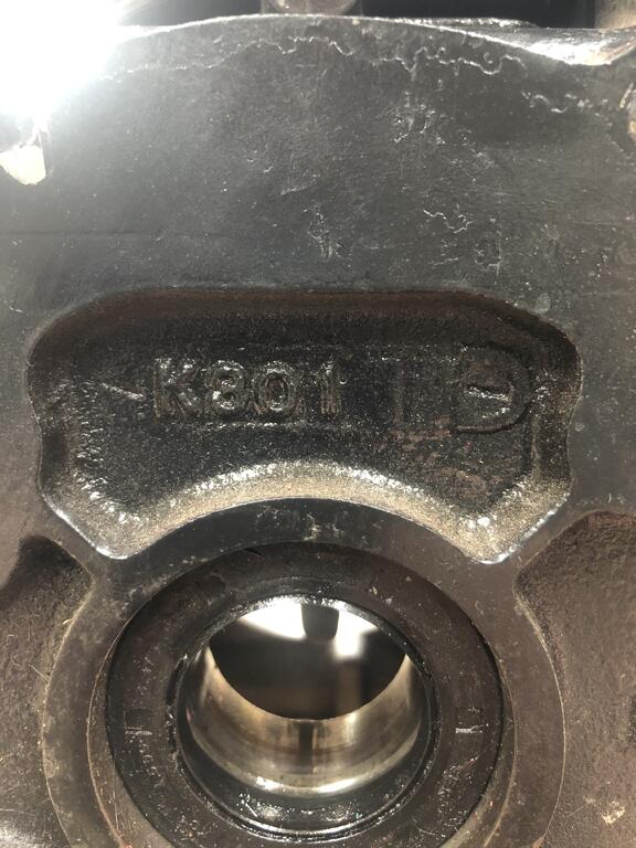

The Tuul Crib 7,354 #14 Posted January 23, 2021 41 minutes ago, CB1993 said: Thanks for all this info guys. A little off topic but could any of you give me some guidance on what drive belt this tractor uses? The one on it is very dry rotted. This is my first wheel horse and first riding mower period. It runs like a champ. I'm a first time homeowner and planning on using it for mowing this summer. Any other tips on things to look for on a new to me tractor would be greatly appreciated. I'm going to change all the fluids, filters, and belts. Another way to identify the block is on the PTO side. Behind the PTO it should be stamped just above the crank if it's a 301 or a 241. Ie 12 hp or 10 hp 1 Share this post Link to post Share on other sites

The Tuul Crib 7,354 #16 Posted January 23, 2021 (edited) 18 minutes ago, The Tuul Crib said: Another way to identify the block is on the PTO side. Behind the PTO it should be stamped just above the crank if it's a 301 or a 241. Ie 12 hp or 10 hp Edited January 23, 2021 by The Tuul Crib 1 Share this post Link to post Share on other sites
richmondred01 2,393 #17 Posted January 23, 2021 1 hour ago, The Tuul Crib said: most of the time you can trust the embossed numbers however, many don’t have the embossed model number. additionally it’s very common to have a k301 block and it’s bored to the k281 spec. the only way to truly tell is to pull the head and measure the cylinder. 2 1 Share this post Link to post Share on other sites
Ed Kennell 47,403 #18 Posted January 23, 2021 3 hours ago, CB1993 said: Here is the tag Ed. Looks like you have a 1277 tractor 12 = HP 7= hydro 7= 1967 If the riveted engine tag is correct, it has a replacement engine from a 1054 tractor 10=HP 5= 4speed gear drive 4=1964 The 12HP engine decal may have been added to the 10HP engine. Only way to be sure is to measure the bore. 1 Share this post Link to post Share on other sites
