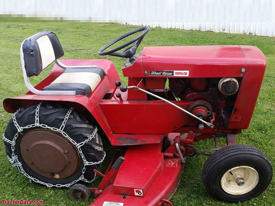

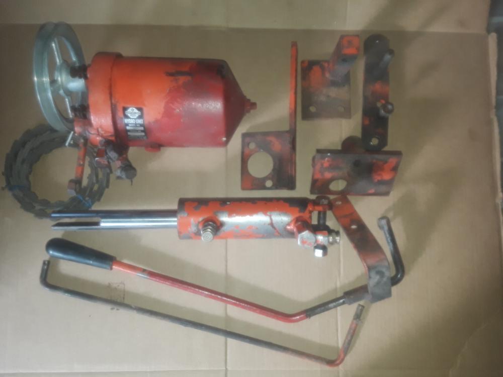

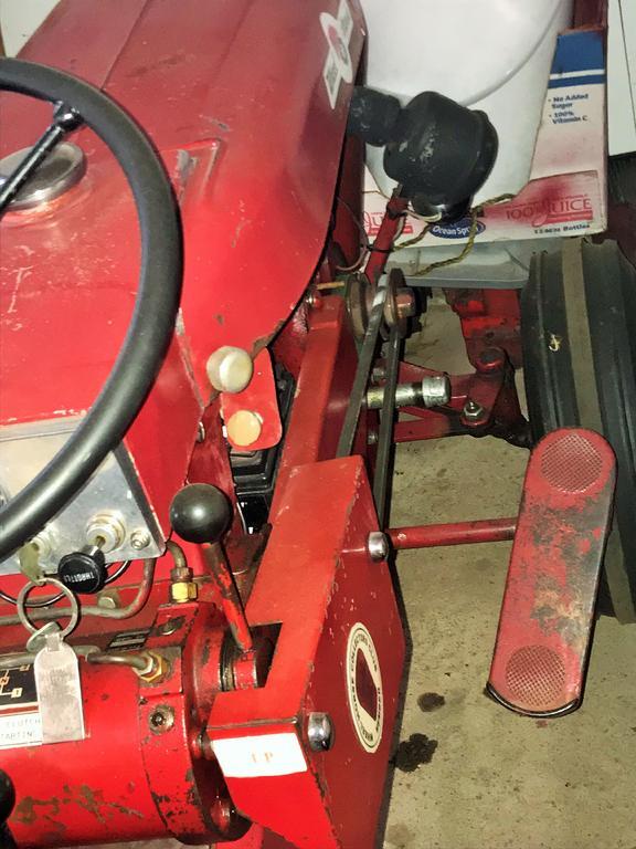

Achto 32,844 #13 Posted January 24, 2021 (edited) 3 hours ago, MikMacMike said: But like I got thinking too I think it would be good for a single use only, I did notice though they do have this setup with larger volume resivoirs too but then the size again becomes a problem trying to fit everything under the hood of the WH. I was thinking in particulare for a front end loader. I agree that using this pump will not work for a front end loader. My thoughts were that it may be a good replacement for the Wheel Horse HY pumps that were made by Hien Werner. These were nice compact self contained units that worked well to add hydraulic lift to a gear driven tractor. It was designed to lift the mower deck. snow blower. plow, etc. Hien Werner also made this pump for other companies like Bolens, Cub Cadet, and Economy. A pic of the HY kit. This is where it would mounted on a round nose if you added the HY kit to one. The pumps made for were designed to turn counter clock wise and were driven off from the PTO side of the engine. On a 953 or 1054 it would have been mounted at the factory and would be hidden under the center counsel between the dash and seat. The small handle on the right side of the center counsel is your control handle. I add a Hien Werner pump labeled as a Century Fox on to my Raider 12. My pump was designed to turn clock wise and had to run off from the flywheel side of the engine. I added some linkage to get the control closer to me. Edited January 24, 2021 by Achto 1 5 Share this post Link to post Share on other sites
