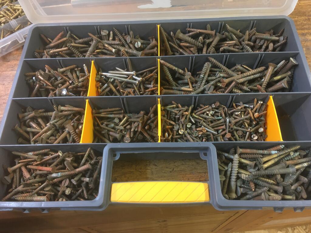

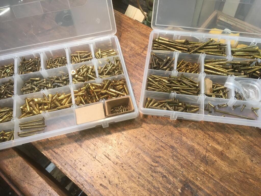

formariz 12,381 #1 Posted January 21, 2021 Today it is hard to keep up with all the newly emerging types of screws and drivers for them. I too use them . In the shop however, like with everything else, I like to work using old ways and methods. Slotted head wood screws have for very long been one of my favorite screws to use. In much of the work I do there are no exposed fasteners, but when it needs to be so, only a slotted wood screw is used. Anything else would just look out of place. No other screw has that classy and dignified look. I am very partial of brass and bronze screws of which I keep a vast supply of. I even have stock of oxidized screws for the right look in some pieces. A brass or bronze screw also will not rust making it easy to remove at a later date specially outside or work subjected to moisture. Most shy away from them feeling that they are hard to drive. Reason for that is that most do not have or use the correct tools to use them. 99% of screw drivers or power drivers are incorrect for them. What ever driver is used needs not only to have parallel sides but also be the correct size to match slot. Screwdrivers with nonparallel sides will just slip out and immediately damage slot. Cabinetmakers' screwdrivers such as the ones on photo are designed for slotted head screws. One can also use a wrench on them for extra torque such when seating a screw flush with work. I never use power tools to drive slotted head screws. My go to tools are braces specifically short throw braces used with a sleeved driver which prevents bit from slipping off screw. For seating screw flush with surface I then switch to a non sleeved driver so I can see screw's head. I keep various braces set up with different size /type drivers along with others with countersinks. I also use braces to also drive other types of screws. They are fast and efficient never overdriving or overheating screws leading to damaged or snapped off heads. Foe easier driving have a wax cup under bench which I use to lubricate all screws. Today we are constantly switching to a new type of screw or cordless drill to make our lives easier but in reality much of it is nothing but an addiction inflicted on us to spend money . Make no mistake I also use them only when necessary such as in production work. It is however the old ways of doing things that I was taught with, that captivate my passion for this craft. In the short video below I illustrate on how I drive screws here. I merely drilled a short pilot hole to start screws rather than a full length pilot hole as usual. The long steel screw is 6" long and it goes through a knot. 8 2 1 Share this post Link to post Share on other sites
WHNJ701 4,173 #2 Posted January 21, 2021 If you ever run out of those old slotted screws I have containers full of them from my grandfather her grandfather etc... Share this post Link to post Share on other sites
formariz 12,381 #3 Posted January 21, 2021 32 minutes ago, jabelman said: If you ever run out of those old slotted screws I have containers full of them from my grandfather her grandfather etc... I appreciate it. I have quite a stock but if you have 2" and longer or brass I am open to it. Share this post Link to post Share on other sites

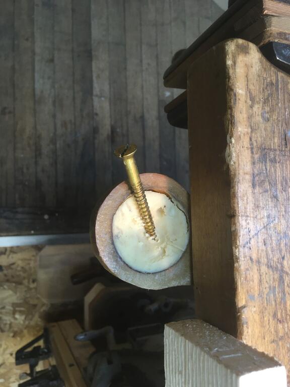

8ntruck 9,310 #5 Posted January 22, 2021 What kind of wax are you using? I've used bar soap as a lube on screws in hardwood. Share this post Link to post Share on other sites
formariz 12,381 #6 Posted January 22, 2021 1 hour ago, DennisThornton said: Really like your rasp/file holder! Neat little anvil in the video background. Thank you. My "Blacksmithing" center - Tools and Equipment - RedSquare Wheel Horse Forum Share this post Link to post Share on other sites
formariz 12,381 #7 Posted January 22, 2021 28 minutes ago, 8ntruck said: What kind of wax are you using? I've used bar soap as a lube on screws in hardwood. I use several different types of waxes such as Johnsons Paste Wax, Butchers wax or Bowling Alley Wax. Its something that is used extensively here as a finish or protectant. They are also in paste form so I can refill the bench cup easily with it .I also use paraffin that I have in block form. Bar soap works too. Many things work. I was taught at a young age to rub a nail on my scalp prior to driving it. It works trust me (even after shampooing). Share this post Link to post Share on other sites

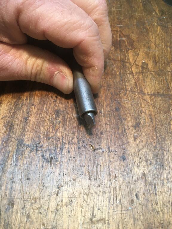

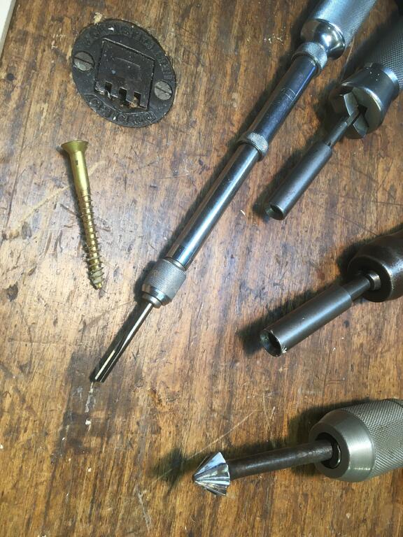

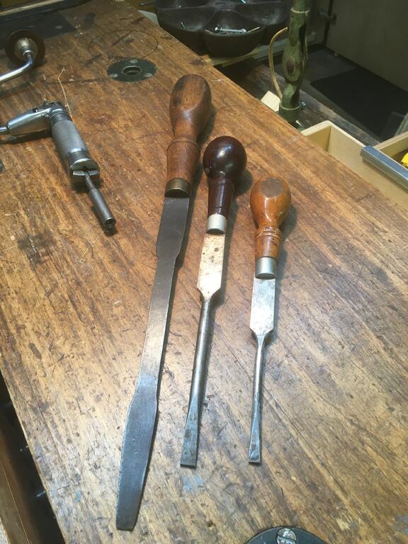

tunahead72 2,662 #13 Posted January 22, 2021 16 hours ago, formariz said: ... Slotted head wood screws have for very long been one of my favorite screws to use. In much of the work I do there are no exposed fasteners, but when it needs to be so, only a slotted wood screw is used. Anything else would just look out of place. No other screw has that classy and dignified look... ... Most shy away from them feeling that they are hard to drive. Reason for that is that most do not have or use the correct tools to use them. 99% of screw drivers or power drivers are incorrect for them. What ever driver is used needs not only to have parallel sides but also be the correct size to match slot. Screwdrivers with nonparallel sides will just slip out and immediately damage slot. Cabinetmakers' screwdrivers such as the ones on photo are designed for slotted head screws... Excellent thread Cas, and I hear what you're saying about slotted screws and appropriate drivers. I'm curious, do you see any difference in the screws themselves, between older and newer? We live in an old Pennsylvania farm house, and I've noticed the older (possibly original) slotted screws that I've found in door hinges for example seem to accept screwdrivers more tightly and firmly. I don't have any cabinetmaker's drivers (yet), just regular mostly older Craftsman screwdrivers, and they seem to work just fine in the older screws, not so well in the newer ones. Share this post Link to post Share on other sites
Handy Don 17,495 #14 Posted January 22, 2021 I've noticed a lot of the newer brass screws at the big box stores look like compressed powdered metal and not forged or machined. Share this post Link to post Share on other sites
formariz 12,381 #15 Posted January 22, 2021 (edited) 2 hours ago, tunahead72 said: I'm curious, do you see any difference in the screws themselves, between older and newer? We live in an old Pennsylvania farm house, and I've noticed the older (possibly original) slotted screws that I've found in door hinges for example seem to accept screwdrivers more tightly and firmly. I don't have any cabinetmaker's drivers (yet), just regular mostly older Craftsman screwdrivers, and they seem to work just fine in the older screws, not so well in the newer ones. 1 hour ago, Handy Don said: I've noticed a lot of the newer brass screws at the big box stores look like compressed powdered metal and not forged or machined. You both are correct in your observations. Brass screws bought today are mostly garbage. Similar to brass fittings bought today. They are extremely light and metal has no strength whatsoever. Slots are usually inconsistent width and not deep enough. Totally useless. Similar qualities apply also to steel screws. In addition to it newer screwdrivers, not cabinetmakers', are also slightly different than the old versions hence the reason the older ones they fit better on the slots. I believe that since no one uses slotted head screws anymore they are just made as a general utilitarian tool for things like opening cans without any real attention paid to how they fit on an actual screw. A little story on screw quality today. A little while ago I made a temporary contraption to support a considerable amount of weight that would also move in several different directions. I pretty much cobbled it up from 2x4s. It was temporary to only allow me time to align it and secure it properly. Conscious of the possibility of the danger involved I went and bought these special 6" long structural screws that are used today instead of lag bolts. These things basically cost almost one dollar each so I spent a little time calculating just how many I needed. Sure enough I shorted myself 4 screws. Not wanting to go back I used 4 vintage 6" long slotted screws I have. The same ones you see me driving on the video. As fate and the insanity of what I was doing would have it, things did not go well and weight shifted all to one side collapsing my contraption. Upon inspecting the unit I found some very interesting things. Basically most of the specialty screws snapped in the middle or heads snapped off allowing separation of the wood parts. The 4 slotted screws merely bent in half but kept the pieces of wood together. Nothing more needs to be said about much of screws bought today. Edited January 22, 2021 by formariz 1 1 Share this post Link to post Share on other sites

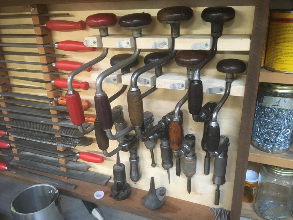

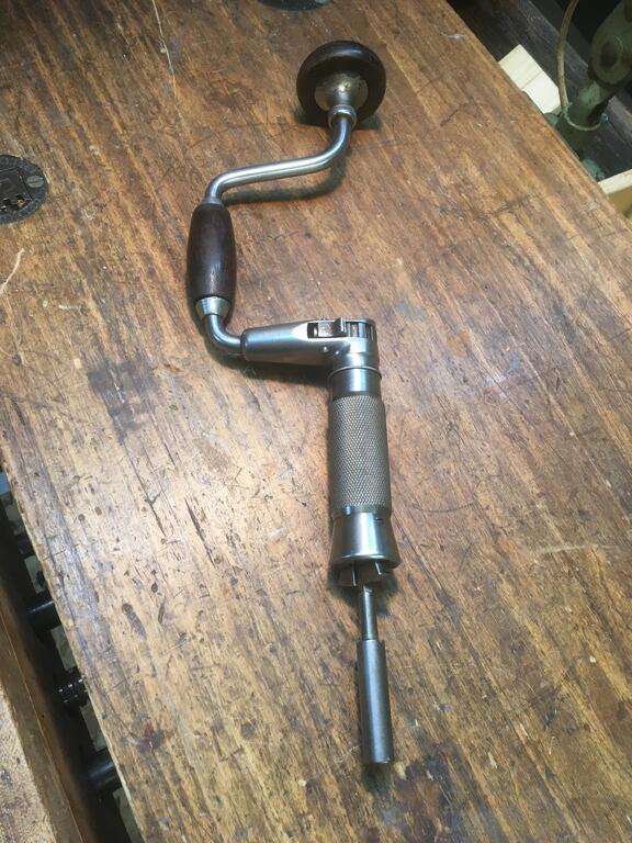

71_Bronco 1,072 #17 Posted January 22, 2021 Very cool. I love the older tools (even though I admit to grabbing the newer stuff most of the time). What are your thoughts on the ratcheting style braces? Share this post Link to post Share on other sites
stevasaurus 23,857 #18 Posted January 22, 2021 If I may, being a linemen, I had a ratcheting brace and bit. I used it to drill 5/8" and 3/4" holes in Telephone poles while I was on hooks. It was nice, once you got it started, if it was one of those hard white poles. You needed a sharp bit, but being on hooks, it gave you a little wiggle room. 2 Share this post Link to post Share on other sites
elcamino/wheelhorse 9,363 #19 Posted January 22, 2021 1 hour ago, stevasaurus said: If I may, being a linemen, I had a ratcheting brace and bit. I used it to drill 5/8" and 3/4" holes in Telephone poles while I was on hooks. It was nice, once you got it started, if it was one of those hard white poles. You needed a sharp bit, but being on hooks, it gave you a little wiggle room. Now I know where "Steve on a stick " came from. Out of a history book. 1 1 1 Share this post Link to post Share on other sites
AMC RULES 37,259 #20 Posted January 22, 2021 Yeah, modern stone age history. 2 Share this post Link to post Share on other sites
Handy Don 17,495 #21 Posted January 22, 2021 5 hours ago, formariz said: Basically most of the specialty screws snapped in the middle or heads snapped off allowing separation of the wood parts Yeah, I've used a lot of deck screws for assembly (square and star drives) and noticed they are very strong in tension but are brittle when bent Share this post Link to post Share on other sites
formariz 12,381 #22 Posted January 23, 2021 10 hours ago, 71_Bronco said: What are your thoughts on the ratcheting style braces? Braces are one of my favorite and most used tools. All the ones I own are ratcheting type. I have however some extremely old rare patented ones such as the one on the second photo. It is a Pexto from 1892 and it has a totally different ratcheting system and chuck. I have several different types. Many are also short sweep braces like 6" which are relatively rare but ideal for driving screws. They are possibly the most overlooked tools today. 13 hours ago, tunahead72 said: That being said, do you have a source for better quality fasteners that you feel you can trust? I'm familiar with McMaster-Carr and Bolt Depot. Their fasteners seem to be at least as good as anything I can find locally, but I don't really know if they're actually any better. Luckily unless it is something totally unusual that I need , I do not often have to purchase fasteners for wood. I have quite an impressive stock accumulated over the years, either by inheriting them from older friends, or finding great quantities of old stock in old hardware stores. I am always watching out for stuff like that. Any stuff I bought lately regardless where from its is usually the luck of the draw. Sometimes good others not so good. The brass and bronze stuff I have tons of it from screws to carriage bolts, rivets etc., that I inherited from a good friends father who was a shipwright. 1 1 Share this post Link to post Share on other sites
