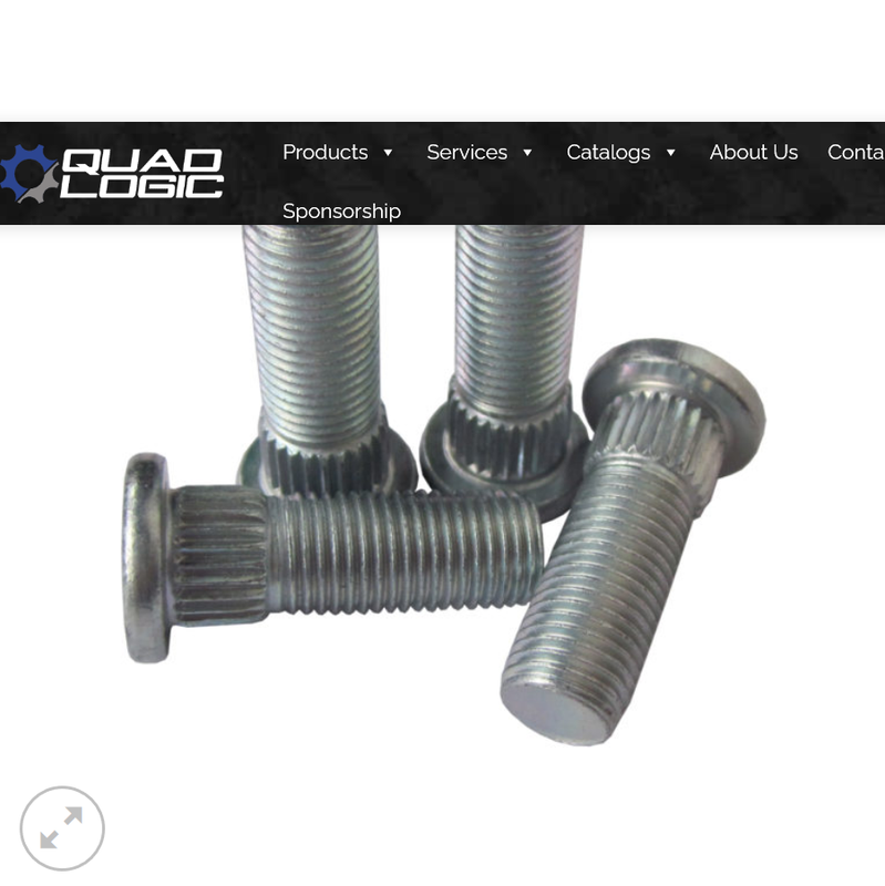

bc.gold 3,406 #27 Posted January 23, 2021 (edited) 3 hours ago, ebinmaine said: It's between 5-1/2" and 6". I can double check tomorrow. An estimated measurement of the length and diameter of the collar , the off the shelf parts with the manufacture of the face plate, drilling and threading holes then finally welding makes it very expensive. What I have in mind is a casting, like the OEM part straight keyed bore the holes drilled instead of threading use push in wheel studs. Edited January 23, 2021 by bcgold 1 Share this post Link to post Share on other sites
