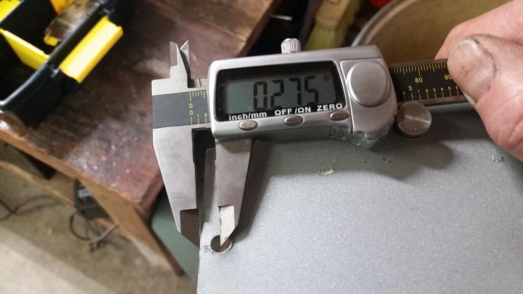

WHX?? 58,310 #3 Posted January 21, 2021 I just got a cheapy $10-20 one off flea bay. Works ok and gets me in ball parks. I would start off with one of those. If it doesn't pan out you ain't married to it. caliper digital | eBay 3 Share this post Link to post Share on other sites

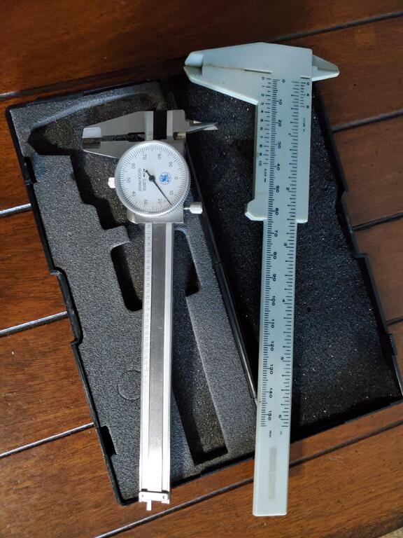

Racinbob 13,242 #4 Posted January 21, 2021 For what you're wanting I agree with Mike on the plastic. I have three of them. One in the garage, one in the workshop and one at my desk. Handy and super cheap. For reloading I need something better and I've used this dial for many years. Mainly for reloading. I don't know what brand it is but it has the Smith and Wesson logo on it so I thought it was cool. Personally I prefer the dial type and I don't want to rely on a battery. 5 Share this post Link to post Share on other sites

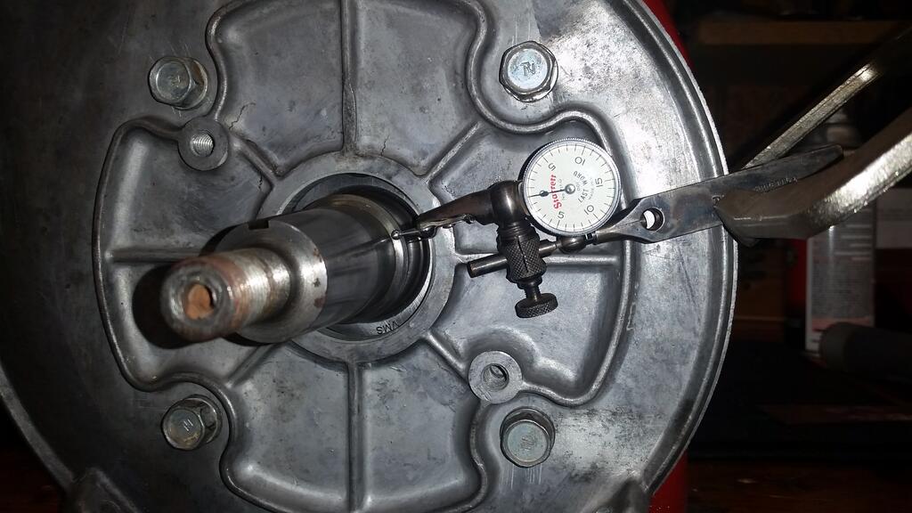

WHX?? 58,310 #7 Posted January 21, 2021 (edited) 6 minutes ago, Ed Kennell said: at auctions for cheap. Found this in the bottom of an auction box of junk for 5 bucks. Handy for measuring end play. The cheapy flea bay in action Edited January 21, 2021 by WHX24 4 Share this post Link to post Share on other sites

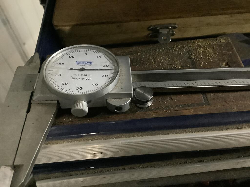

Pullstart 71,481 #12 Posted January 21, 2021 I have some Fowler calipers too. They were much cheaper than Mitutoyo and have lasted me close to 20 years already. Though I check it before every use, I have never needed to turn the dial to keep a true zero. 6 Share this post Link to post Share on other sites
