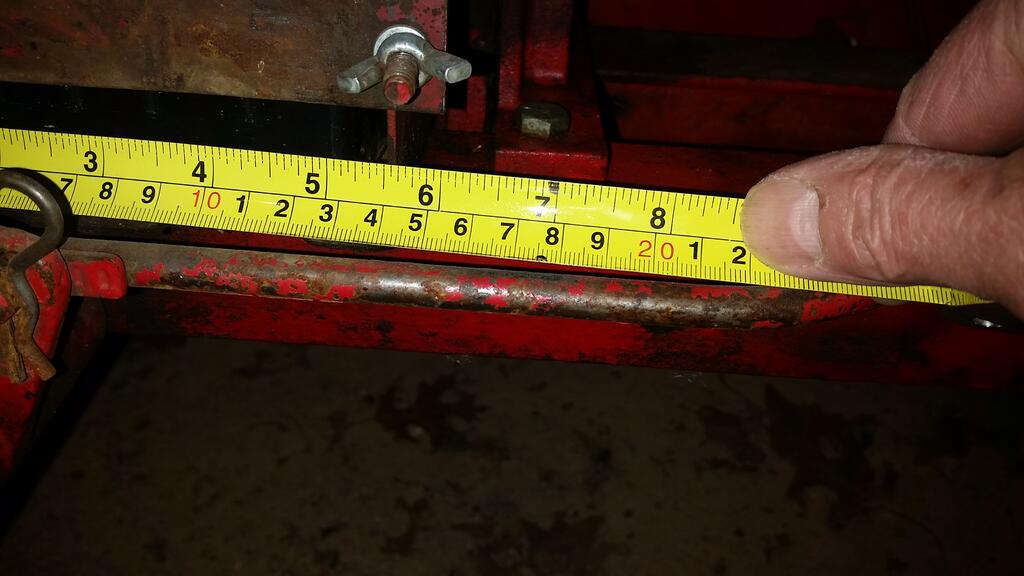

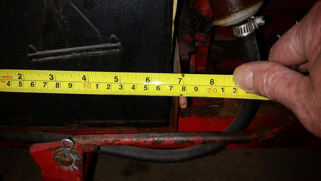

WHX?? 58,052 #35 Posted January 25, 2021 (edited) Thing that points me to a 1277 is the battery looks to the bigger auto style that should have had the top pinch posts we all know and love. The nerve of a PO putting a side post batt on a vintage tractor! I thought in 68 they went to the smaller size batt on long frames? I'll go snap some pics of a 67 & 68 battery tray width. Edited January 25, 2021 by WHX24 1 Share this post Link to post Share on other sites

WHX?? 58,052 #37 Posted January 25, 2021 1277 just shy of 7" 68 Raider 12 which is 5 1/2 but should be the same as '68 hydro? 1 1 Share this post Link to post Share on other sites
ebinmaine 80,600 #38 Posted January 25, 2021 6 hours ago, WHX24 said: 1277 just shy of 7" 68 Raider 12 which is 5 1/2 but should be the same as '68 hydro? Battery size may have been optional Jim. Only guessing. I have a 68 Raider but I can't remember what's in there. My 70 Charger and 74 C160 both have the larger tray. Both certainly could have been changed. 1 Share this post Link to post Share on other sites
