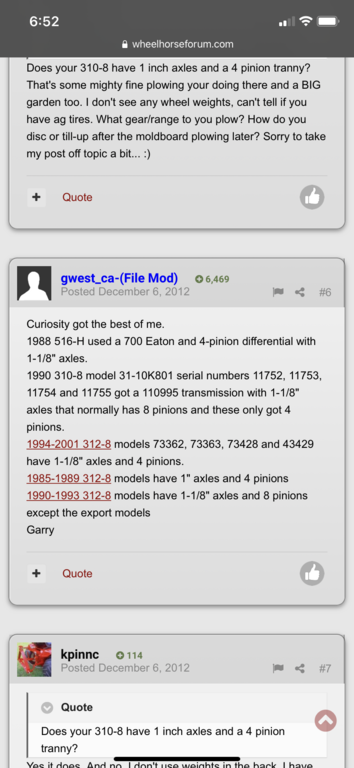

gwest_ca-(File Mod) 11,932 #12 Posted January 22, 2021 1 Share this post Link to post Share on other sites

stevasaurus 23,536 #15 Posted January 22, 2021 @gwest_ca I know it is a mute point, but I did say Wheel Horse in every statement I made. Honestly, I knew TORO did change some things for whatever reason, and to tell the truth...I have not really gotten involved in any horses that new. Sorry, if I made any incorrect statements. Like I said in another thread, I have been looking into making a spreadsheet that lists the transaxle and differential for all the models. It would take downloading the IPL of every horse to do that. 3 2 Share this post Link to post Share on other sites
