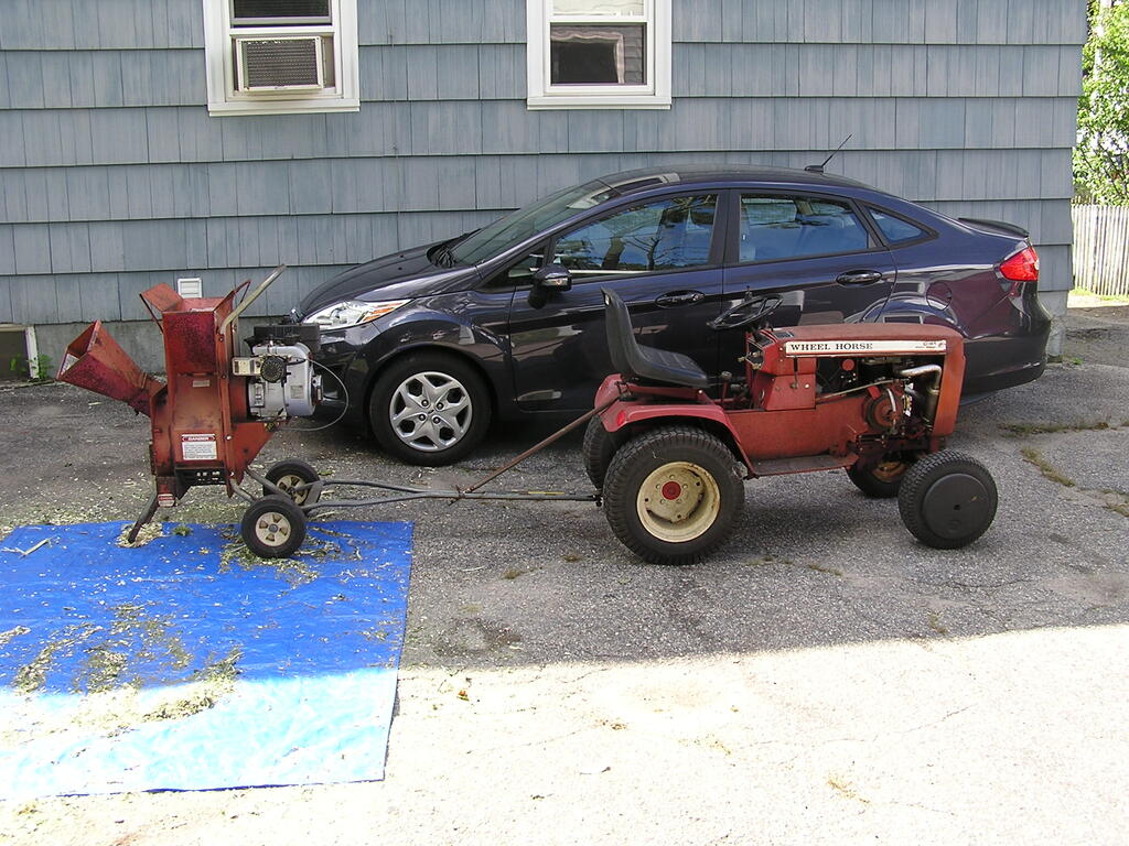

ri702bill 13,096 #28 Posted January 19, 2021 (edited) Dennis: Not always. Years ago, my son bought the chipper and a 60" tow behind 8 HP flail mower - he used them to clear trails behind a property I own in town using his 4 wheel ATV. Both are brutal and work well - the chipper came with the tow bar - you need to keep it attached to the tractor when using it - it has an annoying harmonic resonance at wide open throttle that makes the chipper spin in circles!! Bill Edited January 19, 2021 by ri702bill added picture 2 Share this post Link to post Share on other sites
Handy Don 17,500 #29 Posted January 19, 2021 2 hours ago, ri702bill said: Dennis: Not always. Years ago, my son bought the chipper and a 60" tow behind 8 HP flail mower - he used them to clear trails behind a property I own in town using his 4 wheel ATV. Both are brutal and work well - the chipper came with the tow bar - you need to keep it attached to the tractor when using it - it has an annoying harmonic resonance at wide open throttle that makes the chipper spin in circles!! Bill Off topic, but yeah those Tomahawk chippers are great at their job and very heavy to move around! Share this post Link to post Share on other sites
ri702bill 13,096 #30 Posted January 19, 2021 Don: And mighty top-heavy too! Yup, it's a 1984 Gard-N-Way that came with a good running but underpowered 5 HP Tecumseh - now has a cast iron HH70 - what a difference! 1 Share this post Link to post Share on other sites

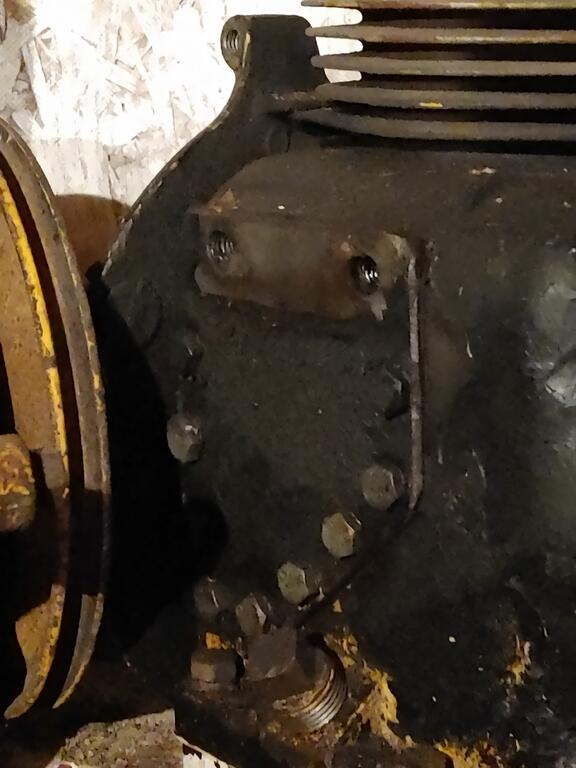

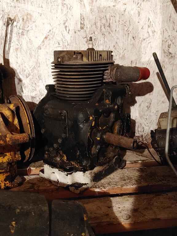

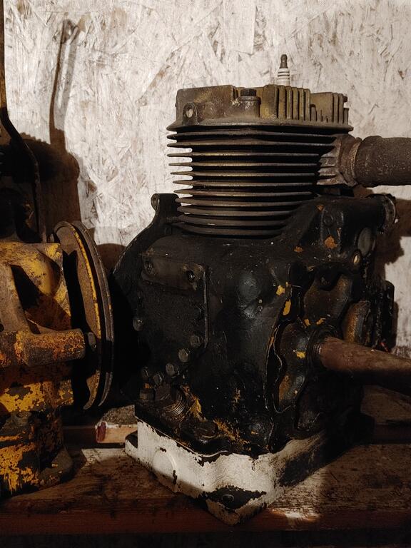

WVHillbilly520H 10,379 #39 Posted January 22, 2021 As promised... K161 40+ yo patch...and it ran like that for 25 or so. 3 Share this post Link to post Share on other sites
ebinmaine 80,772 #40 Posted January 22, 2021 10 minutes ago, WVHillbilly520H said: ran like that for 25 or so. And I'd run it more... Nothin' wrong with that. 1 Share this post Link to post Share on other sites
