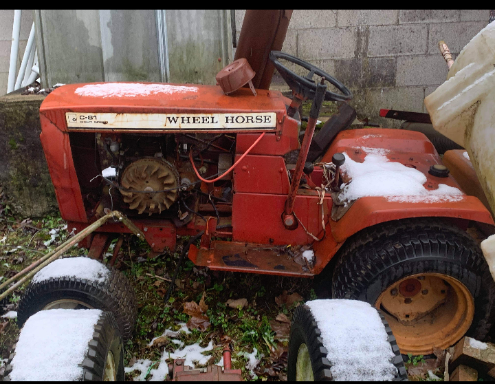

TractorChild97 158 #1 Posted January 17, 2021 Im curious because I just spent 100$ on one near me for parts but now I'm not sure if the parts are even useful to me. I need parts to fit 1 inch axle trans. I mean its not much a loss for 100$ because it aint the worst iv seen. Here in KY its hard to find anything really. I tried searching google but couldn't find anything. Thanks folks!! Share this post Link to post Share on other sites
rmaynard 14,898 #2 Posted January 17, 2021 I'm pretty sure that the C-81 has 1-1/8" axles. 2 1 1 Share this post Link to post Share on other sites
ebinmaine 63,151 #3 Posted January 17, 2021 Just now, rmaynard said: I'm pretty sure that the C-81 has 1-1/8" axles. I'll second that. You'll certainly get $100 back outta that though. Maybe Lincoln at A to Z Tractor has the stuff you need? 1 1 Share this post Link to post Share on other sites
rmaynard 14,898 #4 Posted January 17, 2021 5 minutes ago, TractorChild97 said: I need parts to fit 1 inch axle trans. What parts do you need? Many of the parts inside are interchangeable. 1 Share this post Link to post Share on other sites
RandyLittrell 3,827 #5 Posted January 17, 2021 If the C81 tranny is good, just swap it into the tractor you are working on. Randy 1 1 Share this post Link to post Share on other sites

TractorChild97 158 #7 Posted January 17, 2021 Thanks guys! I will honestly just swap them out. If its good that is Share this post Link to post Share on other sites
ebinmaine 63,151 #8 Posted January 18, 2021 1 hour ago, TractorChild97 said: Thanks guys! I will honestly just swap them out. If its good that is If you need any parts lemme know. I've got a couple 8 speeds partially disassembled. Share this post Link to post Share on other sites
AHS 1,411 #9 Posted January 18, 2021 Check out if the shifting boot is cracked, where it’s sitting outside.... pull the dipstick on the tranny and you’ll find out.... if there water in there. Just a tranny fluid change and a shifting boot change and you’ll be all set.😀 1 Share this post Link to post Share on other sites
stevasaurus 22,230 #10 Posted January 22, 2021 One thing...according to my notes the #103916 transmission is the one that uses the needle bearing on the inner axle...not the famous #1533 ball bearing. The needle bearing is #111199. 1 Share this post Link to post Share on other sites
