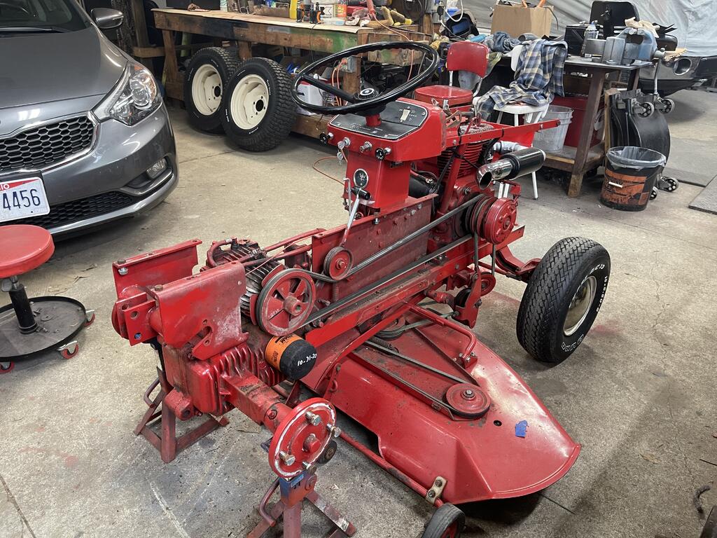

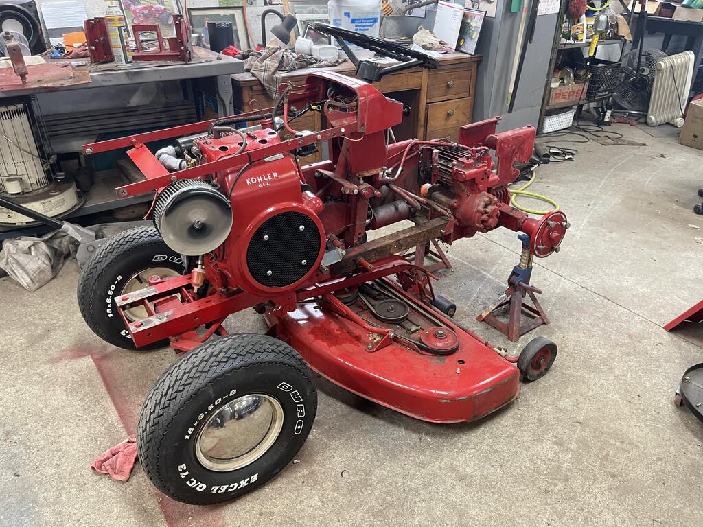

Bear G 690 #1 Posted January 16, 2021 Working on restoring another GT-14. this one has a 16-HP in it. Still in tear down stage. Super slow going. Hope to get it done “eventually”. lol 9 11 1 Share this post Link to post Share on other sites
ebinmaine 81,048 #2 Posted January 16, 2021 Looking like it'll be a nice rig when done. I like the air cleaner and sidepipe style stack. 2 1 Share this post Link to post Share on other sites
Pullstart 71,482 #3 Posted January 16, 2021 Now I see what you’re workin’ on! Nice stuff! 1 1 Share this post Link to post Share on other sites
Achto 32,891 #4 Posted January 16, 2021 Looking good so far Bear!! Good to see that your still at the customs. 2 Share this post Link to post Share on other sites

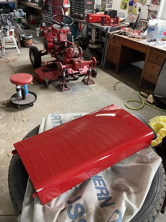

Bear G 690 #11 Posted January 17, 2021 Got the hood & grille back from painter today. hood needs wet sanded one more time and another coat of clear applied. Dropped off a bunch more parts for paint. 4 8 Share this post Link to post Share on other sites

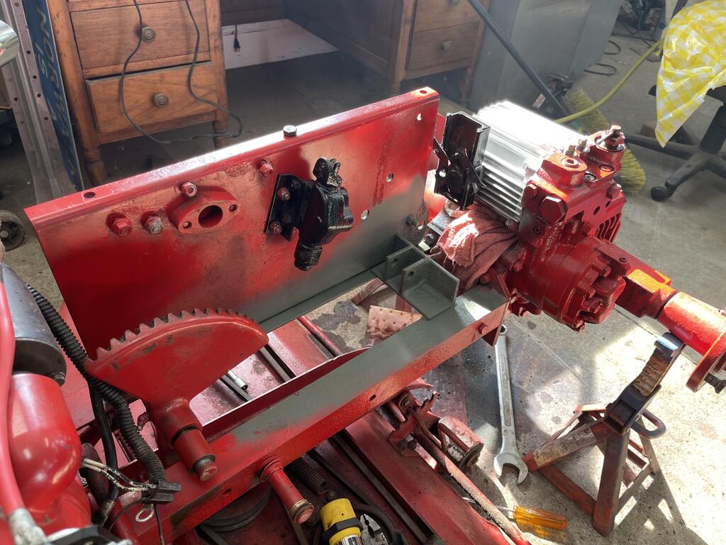

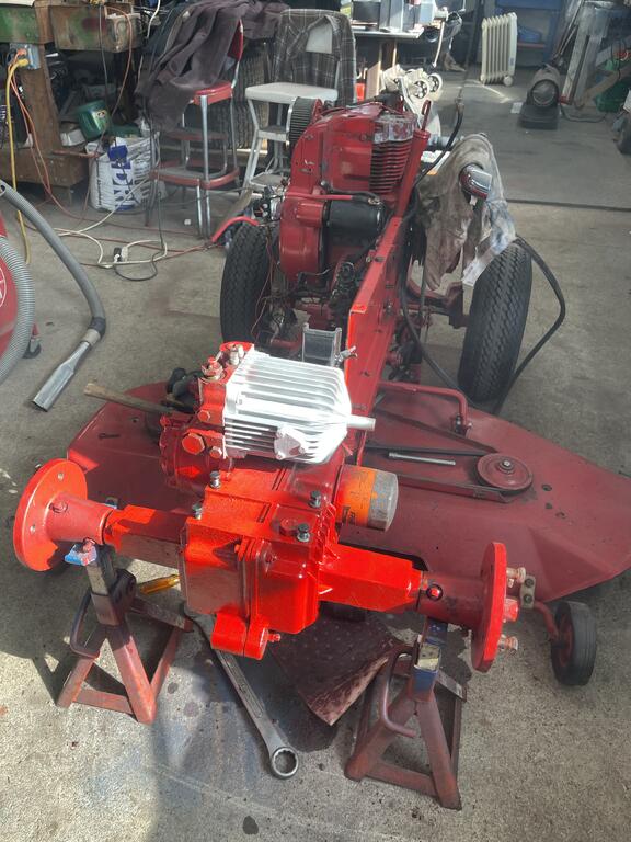

Bear G 690 #15 Posted February 7, 2021 Progress at snails pace. It doesn’t look like it, but I am getting a few things done with this project. Slowly but surely! 5 4 Share this post Link to post Share on other sites
Oldskool 6,678 #16 Posted February 7, 2021 Snails pace or not. Progress is progress. It's looking good. 4 Share this post Link to post Share on other sites
ebinmaine 81,048 #17 Posted February 7, 2021 1 hour ago, Oldskool said: Snails pace or not. Progress is progress. It's looking good. Agreed 4 Share this post Link to post Share on other sites
DennisThornton 4,773 #18 Posted February 7, 2021 3 hours ago, Bear G said: Progress at snails pace. It doesn’t look like it, but I am getting a few things done with this project. Slowly but surely! It's wintertime! You seen a snail? They ain't pacing! You are flying man! Keep it up and you'll be ready for GT time! Love your tractor! 2 3 Share this post Link to post Share on other sites

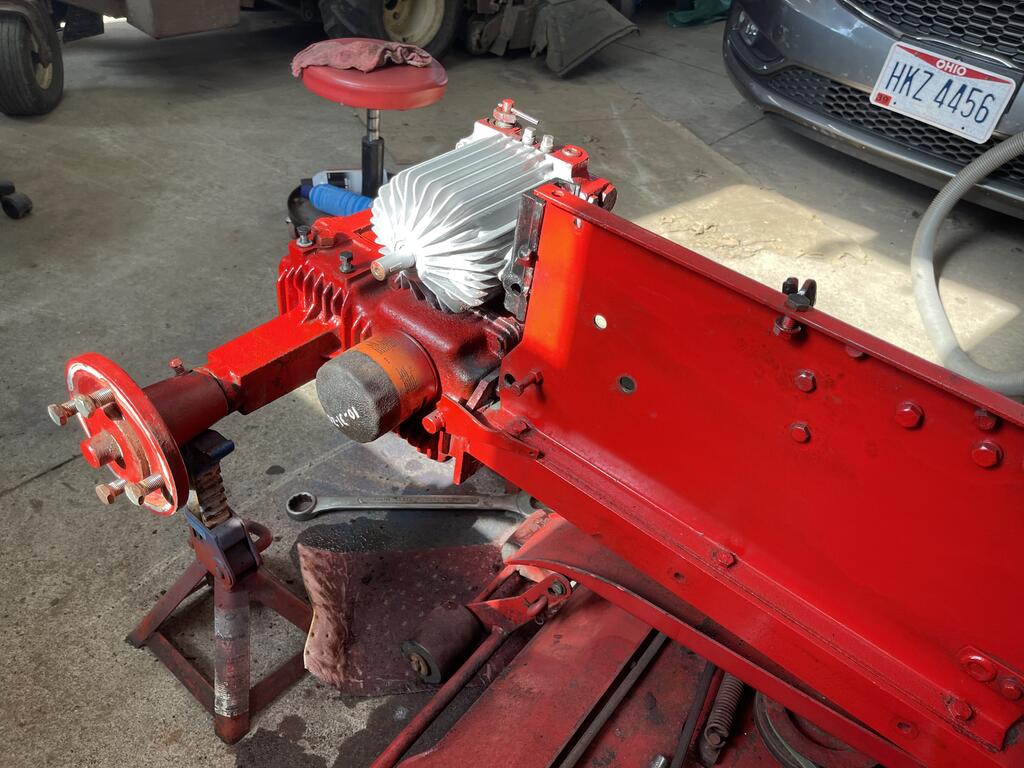

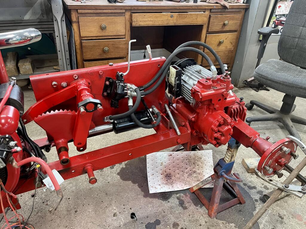

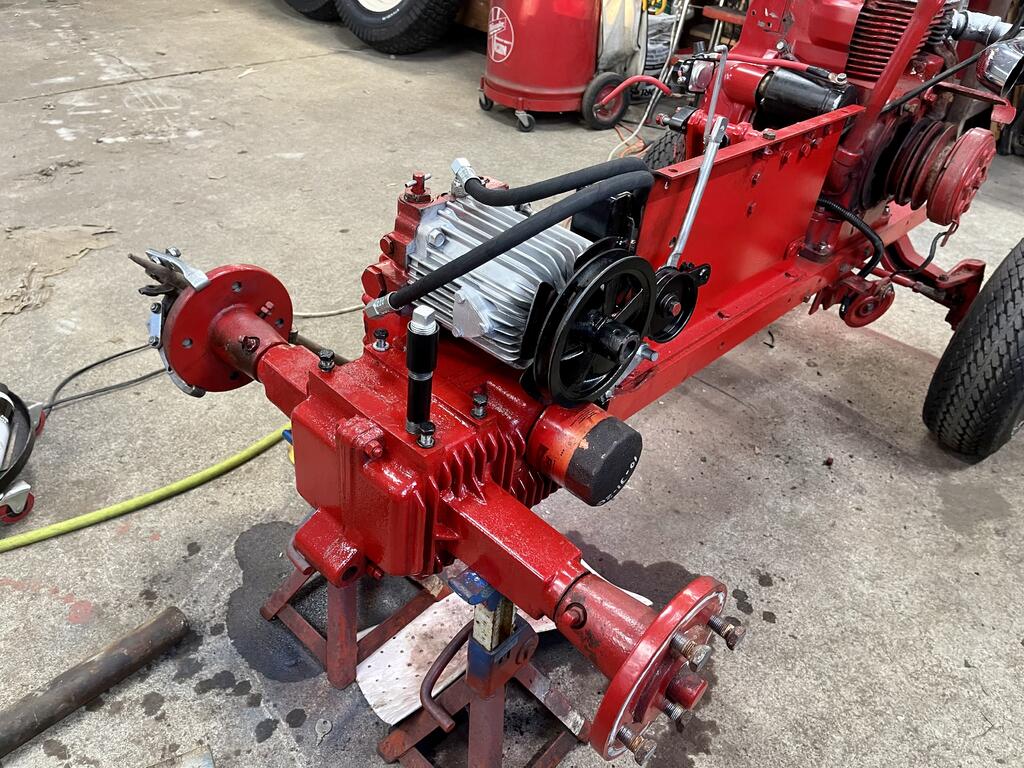

Bear G 690 #20 Posted February 9, 2021 Greg Meeker came over today to help tinker on this old girl. He was a HUGE help and great company! We pulled the deck and got it put up, replaced acceleration springs in rear end, got rock shaft & hyd cylinder put back in, new hyd lines installed, fan & drive pulley back on. we briefly tried to pull a hub. Might abort that plan. Afraid I’ll break it. They’re really stuck. I can clean them up and paint them while on the tractor. No big deal. 7 1 Share this post Link to post Share on other sites

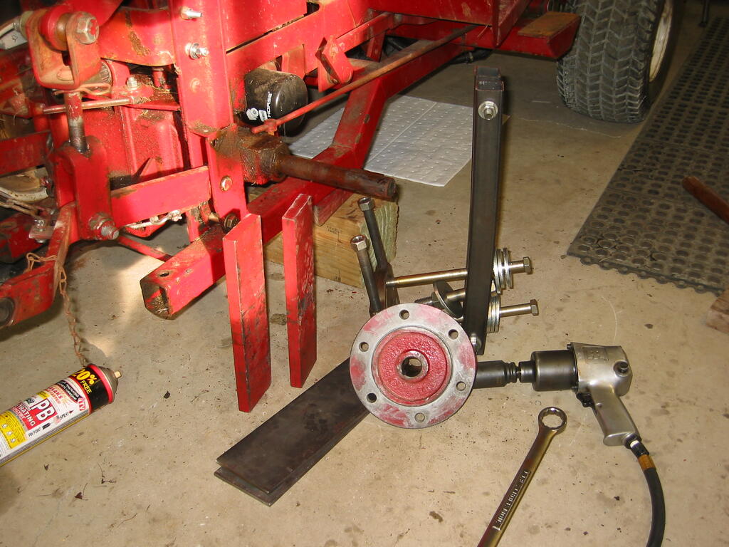

Pullstart 71,482 #21 Posted February 10, 2021 Bear, do you have any other 4 lug hubs? Using another hub as a puller works better than the 2 or 3 jaw pullers every time! 1 Share this post Link to post Share on other sites

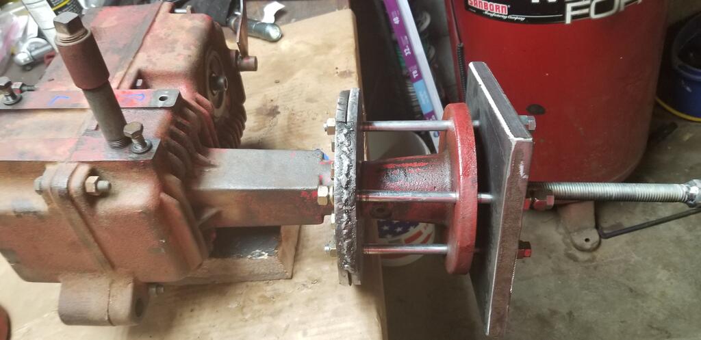

pfrederi 21,274 #22 Posted February 11, 2021 5 hours ago, pullstart said: Bear, do you have any other 4 lug hubs? Using another hub as a puller works better than the 2 or 3 jaw pullers every time! I would not recommend that. The ratio of flange to hub length on GT-14s and D series means you will almost surely break the hub if it is seriously stuck. The hub is 4-5 inches long the flange about a half inch... You have to pull from the back of the hub. 4 1 Share this post Link to post Share on other sites

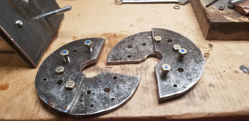

953 nut 70,062 #23 Posted February 11, 2021 On 2/9/2021 at 5:52 PM, Bear G said: we briefly tried to pull a hub. Might abort that plan. Afraid I’ll break it. Rather than a 3 jaw puller I have used a bottle jack like the one @meadowfield built.(I have to give him credit for a great idea) If you don't have an extra hub you could drill four holes onto a piece of 3/8 thick steel. 2 2 1 Share this post Link to post Share on other sites
gt14rider 1,283 #24 Posted February 11, 2021 I made this one, pulls from the back 3 4 Share this post Link to post Share on other sites
ebinmaine 81,048 #25 Posted February 11, 2021 (edited) Great ideas on the hub puller/pullers. Makes me wonder if we should have a dedicated thread in the information section titled such? Forgive me if we do already.... Search words. (ignore). Hub. Hubs. Puller. Pullers. Pulling. Cast iron. Brittle. Information. Pic. Pics. Picture. Pictures. 2 3 jaw. Good. Better. Best. Safe. Safer. Type. Types. Design. Designs. Home. Homemade. Remove. Removal. Edited February 17, 2021 by ebinmaine Added hub puller information and search keys. 7 1 Share this post Link to post Share on other sites
