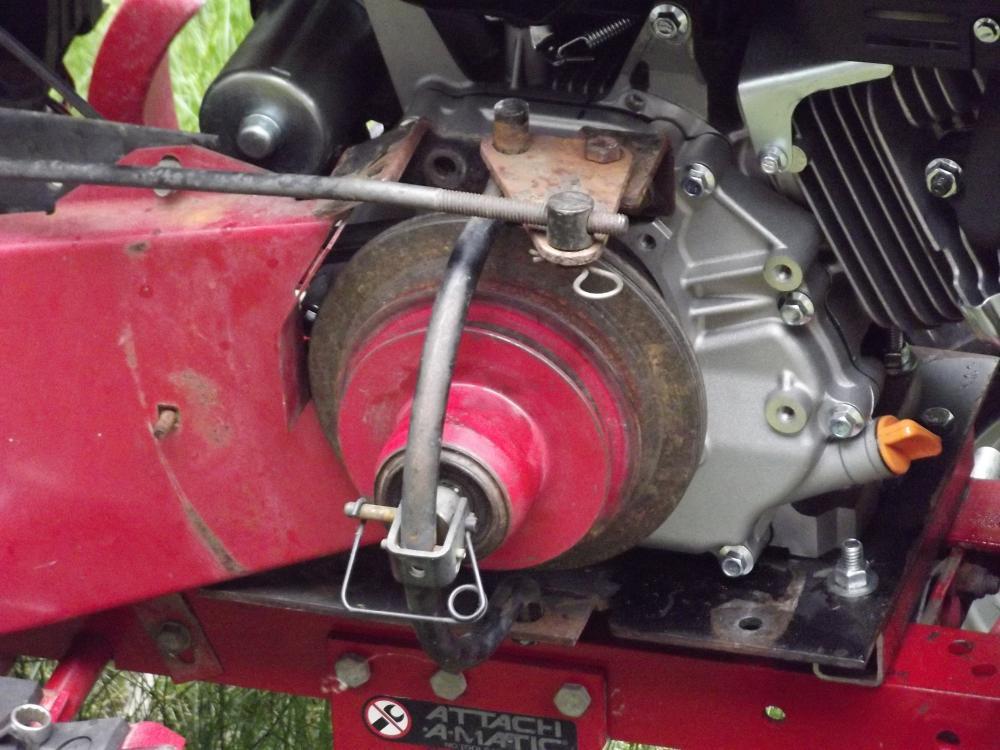

JAinVA 4,636 #5 Posted January 15, 2021 (edited) You can run the WH pto assembly on a Predator 13,no problems Edited January 15, 2021 by JAinVA 5 1 Share this post Link to post Share on other sites

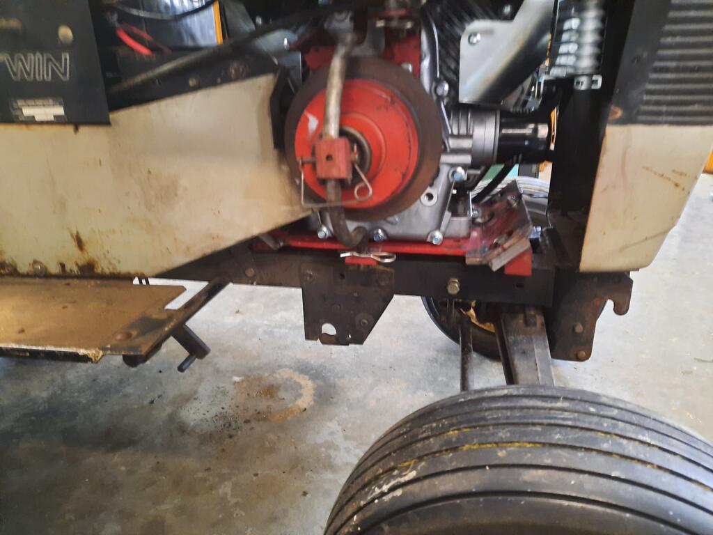

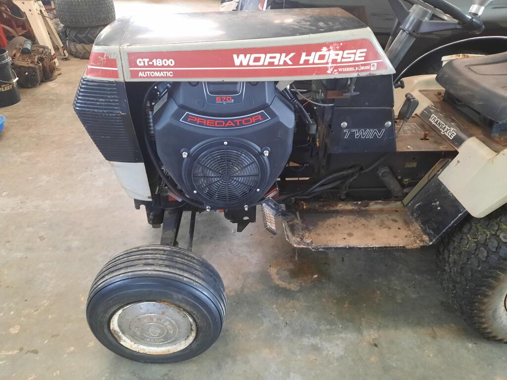

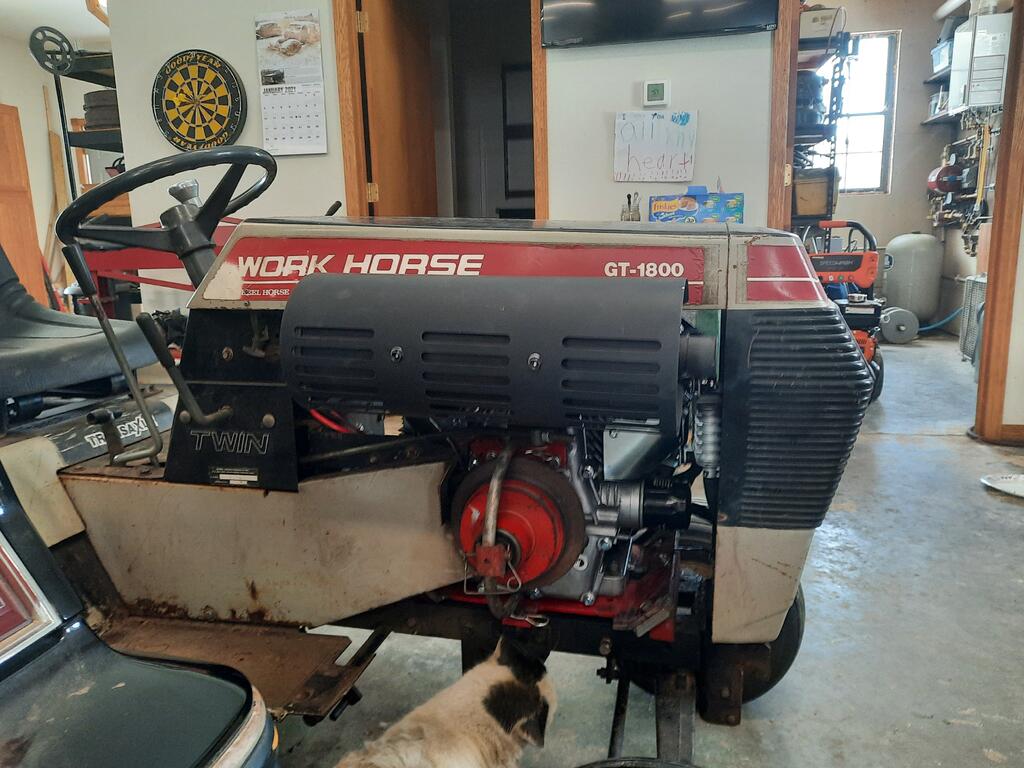

jeremi3210 742 #8 Posted January 23, 2021 (edited) Got it done! Thing runs and drives great! Can't wait to use it this spring! I decided to give the manual pto a try, guess someone needs to get this question answered once and for all right! I used steves 8hp shaker plate i got from @pullstartjust had to make solid mounts and drill 2 hole to mount the motor. Oh and put in a hole for the drain plug! Hopefully it will make a oil change! Lol!! Everything thing else lined right up! The exhaust i had to bring out and up about 3 inches. Still interested if anyone else has tried this with this motor or not! The wiring i used a battery power ignition switch and put in a relay for the kill switch. Edited January 23, 2021 by jeremi3210 5 Share this post Link to post Share on other sites
