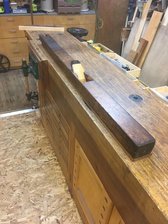

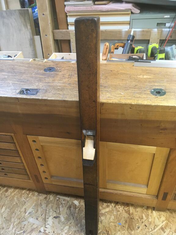

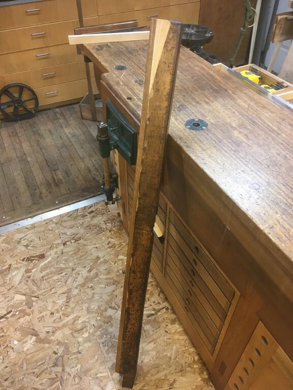

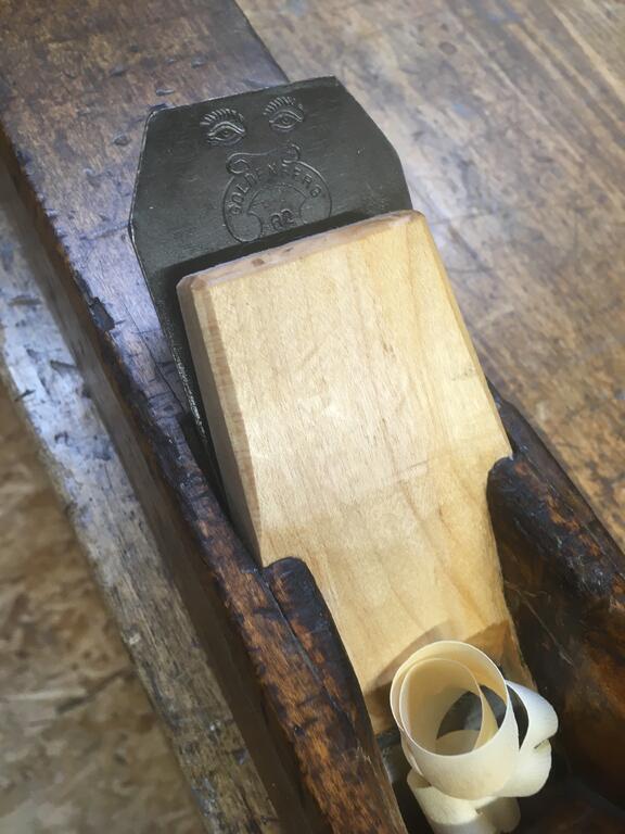

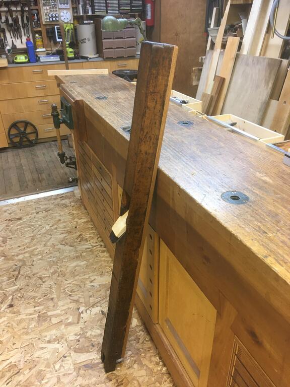

formariz 12,381 #1 Posted January 15, 2021 (edited) A Coopers jointer plane is a rather rare item to find today. I have had thousands of hand planes in my hand but only twice in my life held one. Been wanting to make a few but have not come around to it yet. Opportunity came to obtain one . It was in sad shape with missing chunks ,large cracked areas, incorrect iron and wedge from another plane. A metal plate had been installed on bottom to compensate and stop wear, a sacrilegious move as far as wood planes go. Restored its dignity and functionality by adding a new sole, fitted it with one of my prized 150 years old irons and a new wedge. She is back to service singing loudly as shavings go through it like butter. Edited January 18, 2021 by formariz 1 5 6 Share this post Link to post Share on other sites

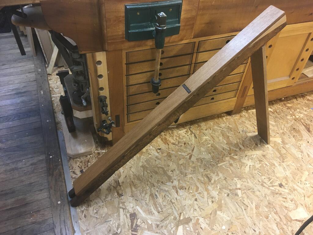

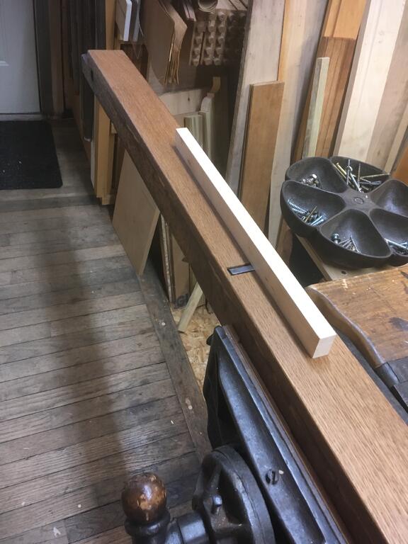

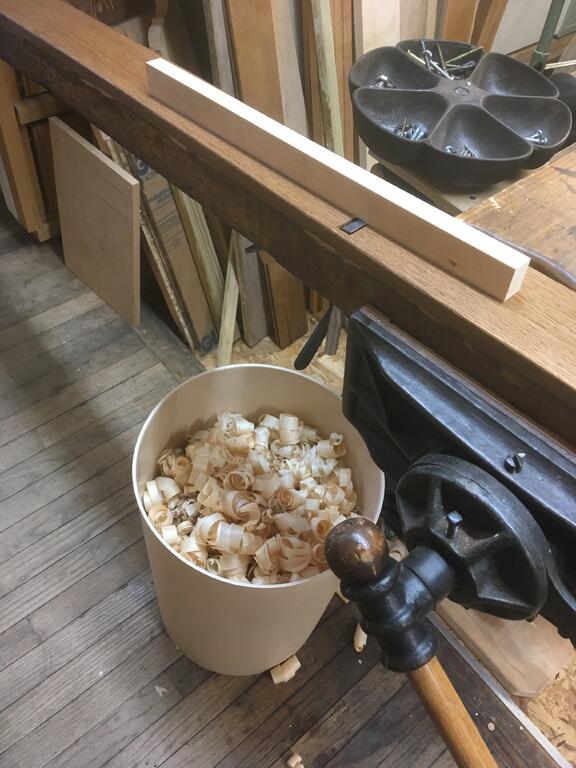

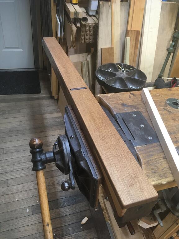

formariz 12,381 #5 Posted January 15, 2021 (edited) 37 minutes ago, SylvanLakeWH said: Very cool! Care to elaborate on its unique applications? vs a standard plane... curious... Barrel staves are beveled on the edges and ends are tapered from the center on each side. This was done by running stave by hand on jointers like this used upside down at an angle with heel up against a block or wall and toe of plane on a trestle or stand. Curiously enough this one from the marks and wear on it never had a stand but it was cantilevered on some type of special block on the heel. It will not be used that way here since my back is not very forgiving to leaning for long. It will be used on the vise as shown in photo. 42 minutes ago, jabelman said: Next time I am cousins shop I try to get some pics, one his distant great great something relatives was a cooper/barrel maker. Somehow he inherited all the tools I remember. I know they are ancient pa dutch? Part of family were also coopers. Although I did not inherit many of those tools I did inherit the knowledge on how to make barrels. Here is a photo of one recently completed many years ago as I was also building my bench. Edited January 15, 2021 by formariz 2 4 1 2 Share this post Link to post Share on other sites

formariz 12,381 #17 Posted January 15, 2021 1 hour ago, Handy Don said: Was there a tool or fixture to hold the stave while jointing? Seems risky to fingers to move piece over tool instead of vice versa. No tool guide or fixture. It’s done freehand without any measuring or templates. It’s all about practice and experience with the process. One does have to be careful when doing very small pieces but barrel staves are usually not that narrow where ones fingers get that close to cutter. Below is a short video on how it’s used . IMG_5210.MOV 1 Share this post Link to post Share on other sites
formariz 12,381 #18 Posted January 15, 2021 1 hour ago, JoeM said: A place up the road here processes barrel wood. Lots of PA hardwood trucking in and pallets of the stave strips headed out. At one time they would give you the rejects but I figured folks got greedy and now send them over to the stove pallet plant. Not sure but they make a sweet camp fire. A small pile burns for hours nice bluish flame. https://www.wilsonforestproducts.com/ It’s all the best White Oak available that is used in barrel making. Some of the best firewood there is. Share this post Link to post Share on other sites
formariz 12,381 #19 Posted January 16, 2021 1 hour ago, pullstart said: So would you say a skill saw is safer than a table saw? Both have their own unique dangers. The idea is to know what they are and avoid them. 2 hours ago, Handy Don said: Seems risky to fingers to move piece over tool instead of vice versa. There is a certain risk to it. Reason why its done this way is the same as for any time a decision is made to run the tool over the work vs running the work over the tool or vise versa. Its about efficiency and efficacy first, and second its convenience. In this particular operation it would take forever to run tool over work, since work would have to be clamped in a vise and constantly be removed to ensure that all four edges are correct and consistent. This way one quickly performs the task and checks it without wasting any time removing it from a vise, putting it back again and at the same time continuously picking up and dropping the tool. It is also much easier to keep a consistent angle on the edge of the stave than to try and keep a plane and the correct angle every time one picks it up. Just refer to the video posted before. Share this post Link to post Share on other sites
