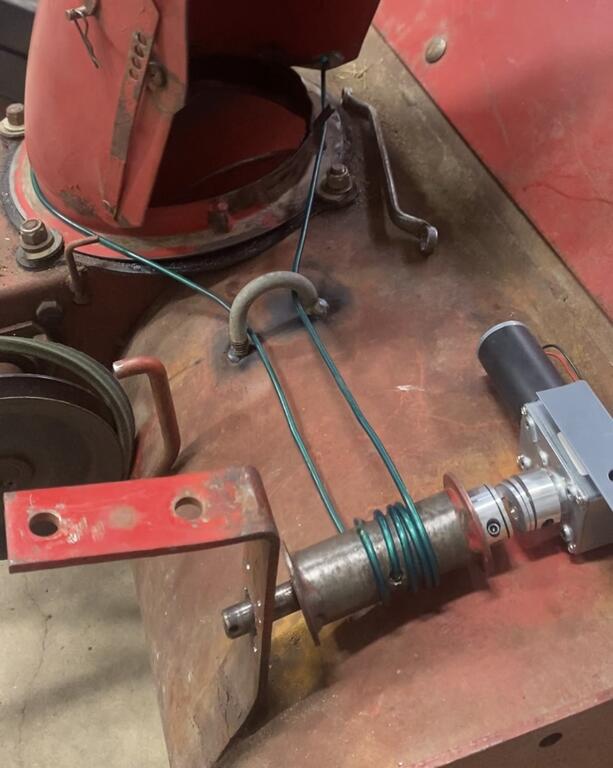

JustinW.73 224 #1 Posted January 15, 2021 Wanted to convert my single stage blower to utilize a small motor to turn the chute instead of cranking. The video was before it was all finished and wired up. I also plan on building a cover to cover the motor and I need to find a better joint coupler as the one I have is very weak. IMG_4393.MOV 3 Share this post Link to post Share on other sites

JustinW.73 224 #8 Posted January 15, 2021 Here’s a pic in case the video doesn’t work for everyone. 6 Share this post Link to post Share on other sites
JustinW.73 224 #9 Posted January 15, 2021 Well it snowed last night. It worked great until the cheap coupler broke. At least I know if has enough torque 1 Share this post Link to post Share on other sites

peter lena 10,030 #11 Posted January 15, 2021 JUSTINW , got your singular picture, thanks, you will probably have to make up something that relates to the size fit of that coupling , also take the time to lubricate all related dry areas , like base of chute , slide , silicone grease on cable to hoop contact , mabey small plastic tubing as a slide point , with silicone spray , found that to be very durable and dramatically cuts down on drag , good idea , pete Share this post Link to post Share on other sites

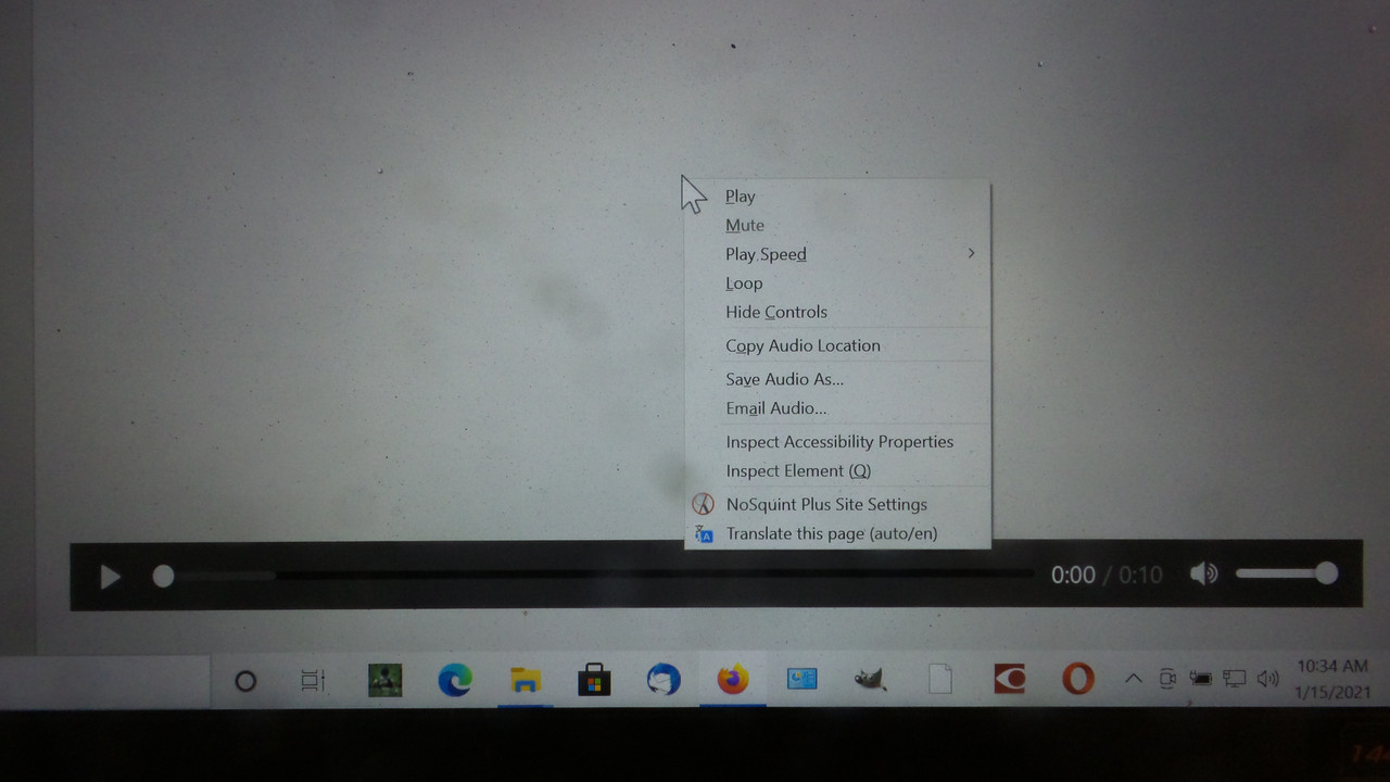

bc.gold 3,406 #15 Posted January 15, 2021 49 minutes ago, JoeM said: same for me. I have this problem when using the desk top and windows, probably fine on a I pad or apple devise?? I think the best way is through You Tube, always there and works. Win 10 does not give me the option to even copy the video url so that I'm able to view in youtube. Share this post Link to post Share on other sites

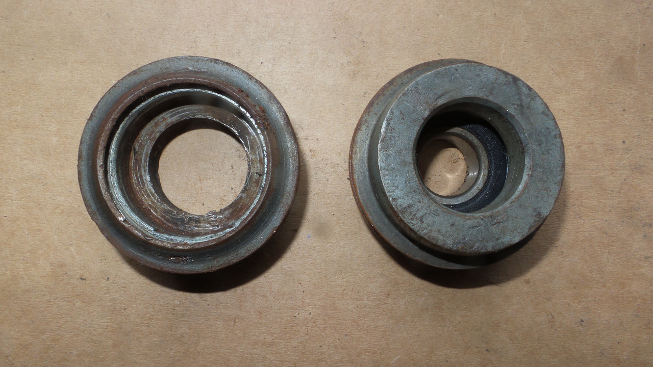

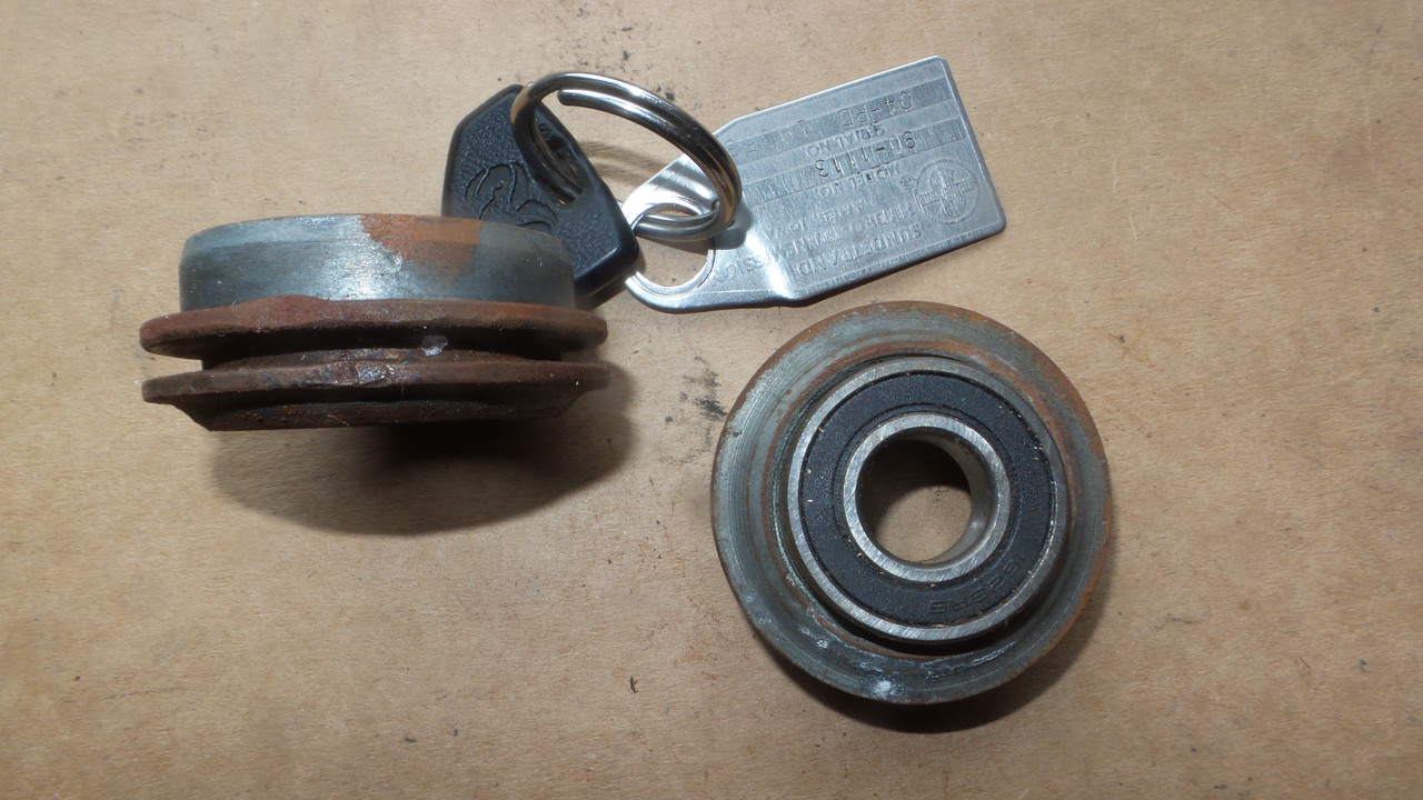

bc.gold 3,406 #16 Posted January 15, 2021 (edited) 3 hours ago, JustinW.73 said: Here’s a pic in case the video doesn’t work for everyone. My simplicity snow thrower came from the factory with electric chute which used aircraft type cable with a double wrap around the base. There were 3 bearings with a specially machined sleeve with a groove that the flange at the bottom of the chute fit into, the reduction gears no longer working have since removed the accessory. You should post the manufacture and part identification for others who would like to add or replace. Bearing is press fit, there is another piece not shown that fit in the center of the bearing and had a collar machined on the bottom to give some clearance and have 3/8: hole to accept the fastener. Edited January 15, 2021 by bcgold Share this post Link to post Share on other sites

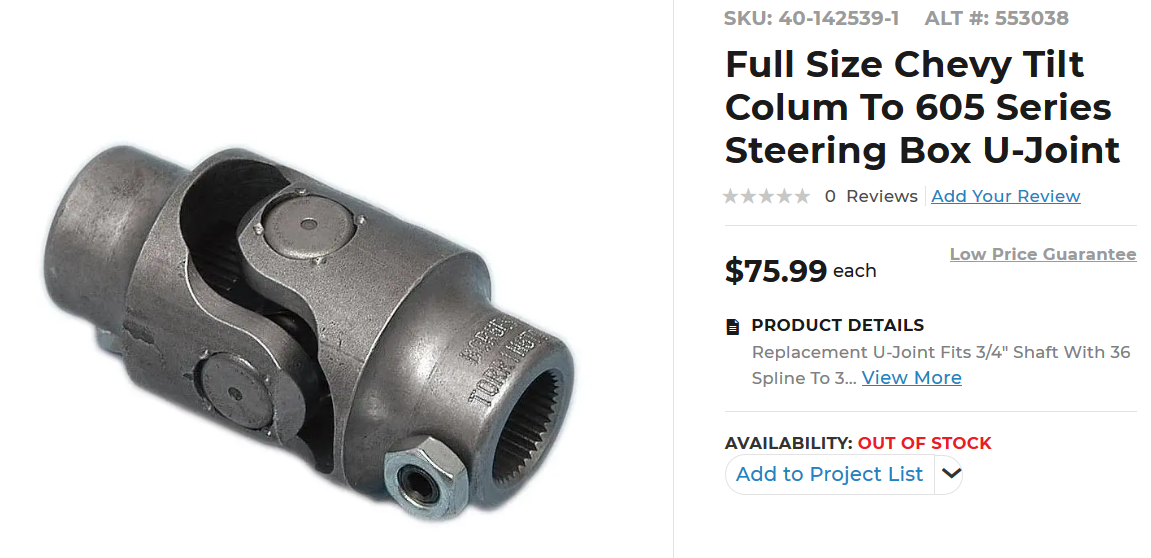

bc.gold 3,406 #18 Posted January 15, 2021 Auto wrecker or Pick a part, rag joint from steering assembly. 2 Share this post Link to post Share on other sites
Jeff-C175 7,211 #19 Posted January 15, 2021 Great idea! I have some windsield wiper motors out of an old bus but somehow I don't think the back and forth motion would cut it... I wonder if the cable rubbing on that loop would eventually abrade it? Maybe a couple small pulleys if it does? Share this post Link to post Share on other sites

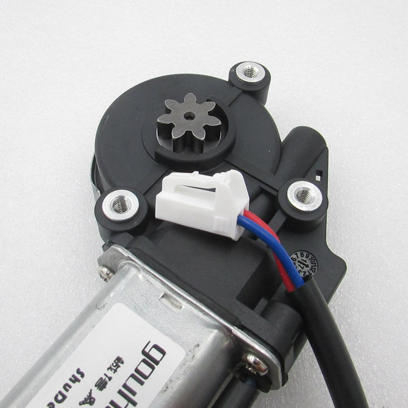

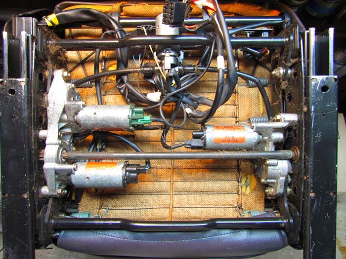

bc.gold 3,406 #20 Posted January 15, 2021 (edited) 3 hours ago, Jeff-C175 said: Great idea! I have some windsield wiper motors out of an old bus but somehow I don't think the back and forth motion would cut it... I wonder if the cable rubbing on that loop would eventually abrade it? Maybe a couple small pulleys if it does? Window regulator, motors to modify seat position, nine out of ten- failure faulty relay causes the malfunction. The DOT requires every vehicle to have a secure seat, those linear rails have bearings to move heavy loads and keep everything snug. Edited January 15, 2021 by bcgold 1 Share this post Link to post Share on other sites
bc.gold 3,406 #21 Posted January 16, 2021 This u-joint can be repurposed from that old wreck sitting in the weeds behind the barn, Share this post Link to post Share on other sites
