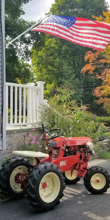

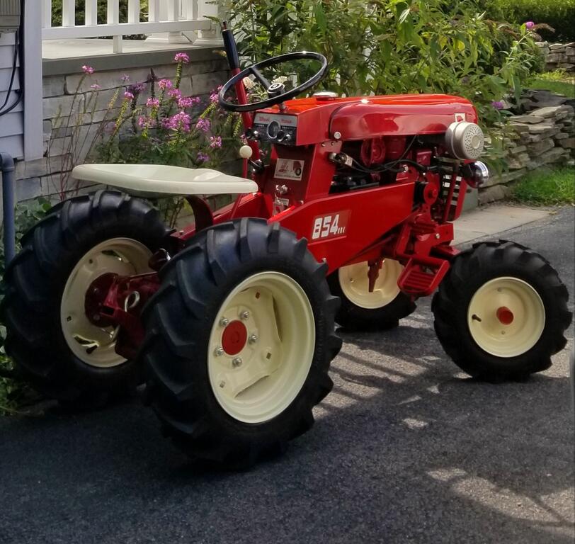

JCM 11,451 #26 Posted January 14, 2021 25 minutes ago, AMC RULES said: Yes sir, same tractor, same ags! Sitting proudly there under that beautiful American flag that allows you to set up your W-H tractor in this country any way you see fit to. God bless the U.S.A. Amen Brother, That is a real work of art. Love the front ags on that. 2 Share this post Link to post Share on other sites

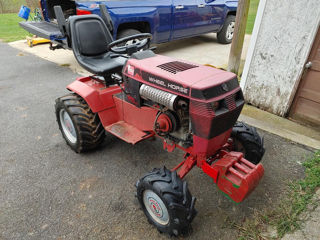

WVHillbilly520H 10,379 #27 Posted January 14, 2021 I did the AGs all 4 corners because 1 I really liked the the OTR brand I put on the back (great year around traction without chains) and they are the same brand and correct factory size for the 520s and yes IMHO has increased my steering traction as well mowing slopes, gardening, and snow removal while installed in the "correct" orientation as the rears, these have a more pronounced bar angle than "generic" AGs plus have a straight center section that seems to enhance the ride (front/rear over the standard bar design)and reverse traction of the driven tires in my experiences so far. As a young fella, my father had a straight pipe stack on the CC Original K161 the only benefit of that was the cool factor ,definitely not my hearing. 5 2 Share this post Link to post Share on other sites

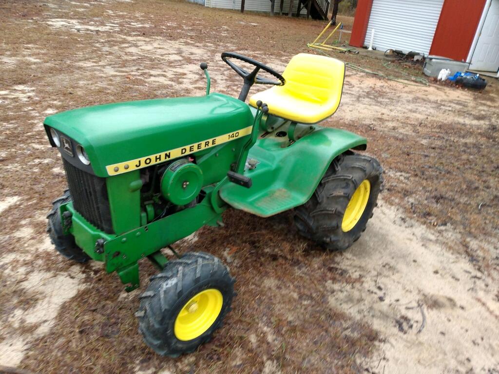

PetesPonies1 119 #35 Posted January 15, 2021 I have Ags on the front of my Deere 140, but I installed them backwards. I have a hydraulic blade on the front and push dirt. The Ags help hold the line better,. I am going to build or buy another WH and put a blade on it. Not sure if I will need the Ags on the front of it. 2 1 Share this post Link to post Share on other sites

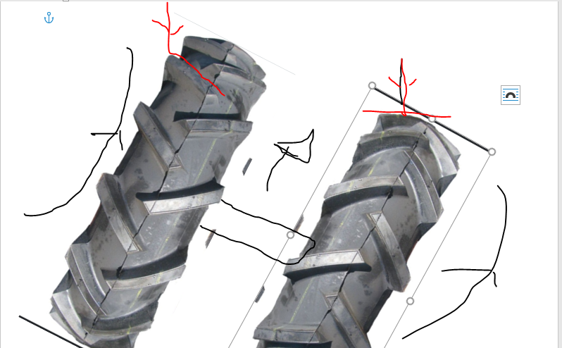

Maxwell-8 4,371 #39 Posted January 15, 2021 Left: AG mounted for steering Right: normal After some thinking: When AG are steering, in the normal postion, the ground gets taken head on by the ribs, and therfore no steering, When tires are flipped; they are not taking the ground/mud/sand/snow head, on but take sideways traction...... but wait, the ground, mud, moves true the ribs in the wrong direction? I am overthinking this 1 1 Share this post Link to post Share on other sites
ebinmaine 81,156 #40 Posted January 15, 2021 25 minutes ago, Maxwell-8 said: Left: AG mounted for steering Right: normal After some thinking: When AG are steering, in the normal postion, the ground gets taken head on by the ribs, and therfore no steering, When tires are flipped; they are not taking the ground/mud/sand/snow head, on but take sideways traction...... but wait, the ground, mud, moves true the ribs in the wrong direction? I am overthinking this Part of the reason that ag/bar tires are so good for driving anything in a forward manner is that they are to a very large extent self-cleaning. if you imagine that the arrows are pointing forward when they are at the top of the tire then they are pointing backwards when they are at the bottom of the tire. If the tire spins at all the bars themselves will self-cleanse by moving the ground material to the OUTSIDE of the tire. SELF-CLEANING..... The reason that they work in the opposite manner on the front of the tractor is that the tread bars are now pointing forward when they are on the bottom. So no matter which way you turn the steering wheel one set of those bars is working directly against the ground and the other set of those bars is working to stay in line with the ground. 3 Share this post Link to post Share on other sites
