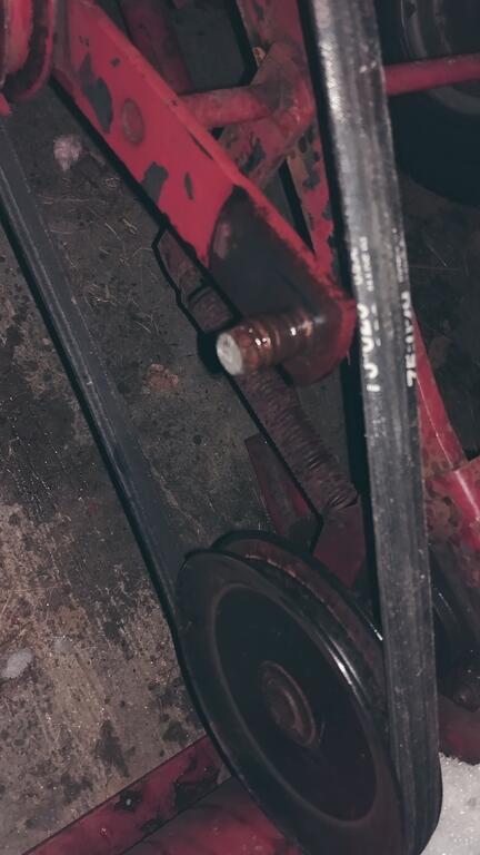

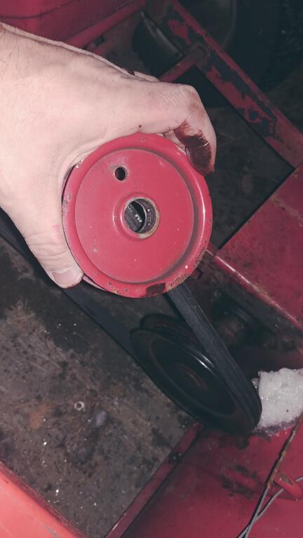

Seth Powers 35 #1 Posted January 14, 2021 Hi All, Don't know how but this pulley broke off my snow blower. It came on my 417-8 tractor. It has ball bearings. Do you know what the part is and where I could find one? I'm pretty sure my snowblower is the 06-42ST04. Thanks for the help! Seth Share this post Link to post Share on other sites

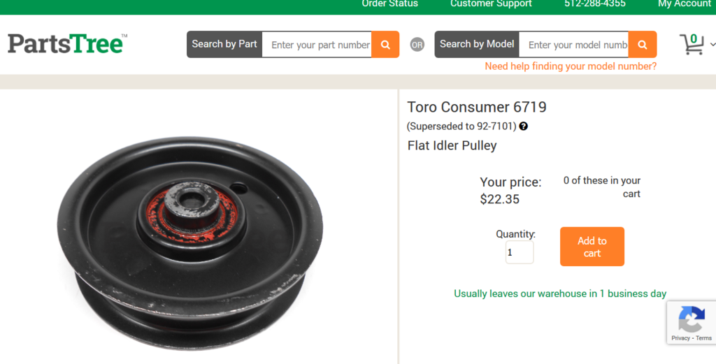

wildman 205 #2 Posted January 14, 2021 https://www.partstree.com/models/06-42st04-toro-42-snow-thrower-1986/snowthrower-42-in-107-cm-vehicle-identification-numbers-06-42st04-06-42sy02-1/ 2 Share this post Link to post Share on other sites

gwest_ca-(File Mod) 12,454 #5 Posted January 14, 2021 Flat idler pulley - 3.094" OD - 3-3/32" - WH 6719, 112425 and 519537 replaced by 92-7101 or 927101 (Stens 280-222 HD bearing Flat OD 2.750" Width 7/8" ID 3/8" with flanges) Flat idler pulley - 3.094" OD - 3-3/32" - WH 105874 replaced by 92-7104 or 927104 May replace 6704 (Stens 280-222 HD bearing Flat OD 2.750" Width 7/8" ID 3/8" with flanges) Napa 7-05205 with flanges) 1 Share this post Link to post Share on other sites
