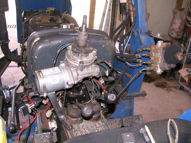

pacer 3,180 #33 Posted January 14, 2021 Heres another totally different approach to assist steering....... EPAS - electronic power steering. Virtually all new cars now have this setup, and the the classic car, off road, etc people have jumped on it. The link is to the post that I ran across describing it, Its VERY long, to see my post re my adapting to my Mitsubishi FEL go to post 28. I did successfully adapt an EPAS to a D180 (remember the D's have Ross steering and I dont think it would work on the fan type) with limited success using a Saturn EPAS which did not work well, but I learned a lot with that and decided to try it on the Mitsu, which turned out far better than I hoped! I used a '14 Hyundai unit. Most - all? - Japanese models after around '12 or '13 will have EPAS. Mind you, it was a serious trial and error with many hours fiddling with the mounting. https://ls1tech.com/forums/suspension-brakes/1848775-35-electric-power-steering-fail-safe-no-ebay-module-no-caster-issues-2.html 1 Share this post Link to post Share on other sites
oilwell1415 563 #34 Posted January 14, 2021 (edited) ls1tech...there's a website I haven't thought about in a long time. There have been a few Ford truck guys convert to the Volvo electric steering as well. Edited January 14, 2021 by oilwell1415 Share this post Link to post Share on other sites
