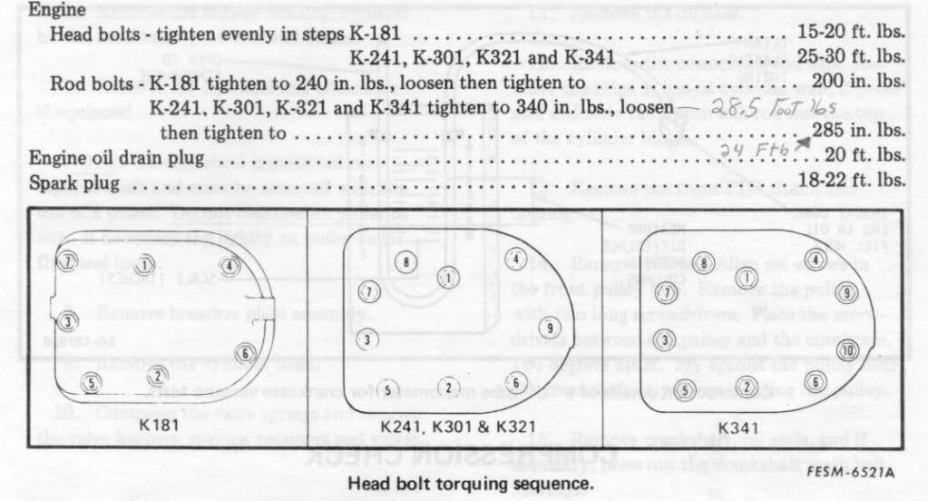

richmondred01 2,393 #3 Posted January 13, 2021 There is no scheduled decarb for the Kohler engines (k and magnum series) unlike the onans. However, for the cost of a head gasket, it’s not a bad idea to inspect one you just procured. That way you will know what you are starting with and what you may expect down the road. While you have the head off it may be a good time to check for warpage and level the head. Here’s the torque sequence. 1 Share this post Link to post Share on other sites
