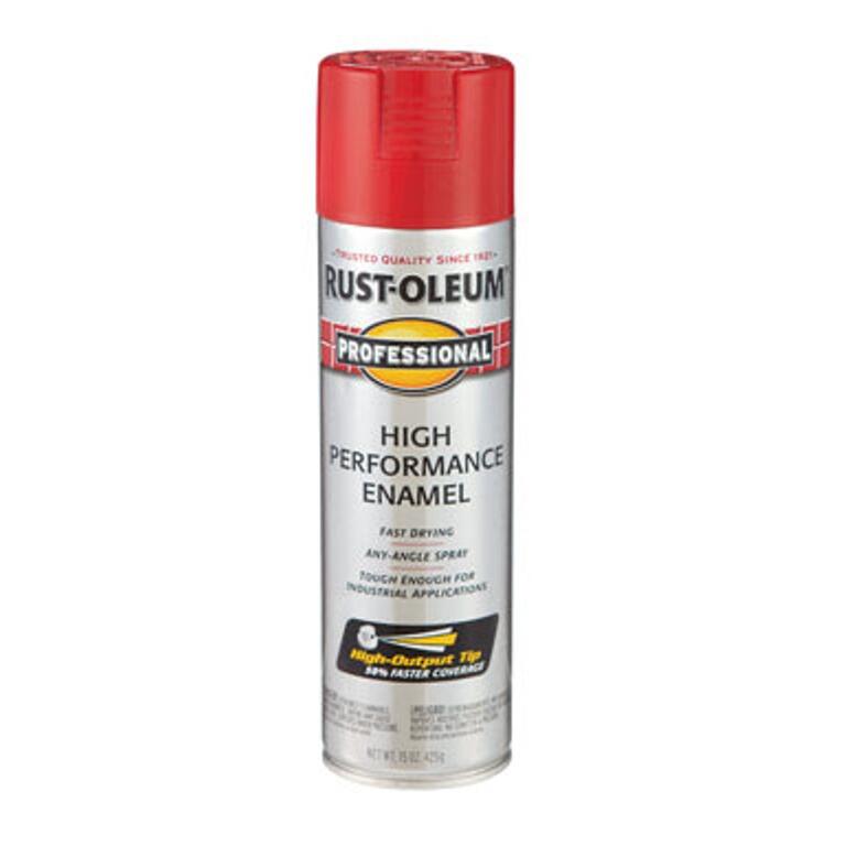

WHX?? 57,738 #18 Posted January 13, 2021 (edited) Been said many times here Bill. Painting a horse is alot like throwing hand grenades just get it close and RED! Personally I am done with rattle canning with Rust Oleum. Seems like I get half the can out and the rest won't come out and end up tossing it. Appears that it plugs up down inside the can. Just bought a tall can of rusty metal primer ... 20% more in can....never got the extra out! Sucks when it happens and you can't finish the job! What's worse is I can only find self etching in Rust olem around here! Never have this problem with Ace labeled cans... ok thanks for letting me vent! I have used this with good results on just a quicky job for a red color. Dries fast but not real scratch resistant. Comes in a tall can. Edited January 13, 2021 by WHX24 1 Share this post Link to post Share on other sites

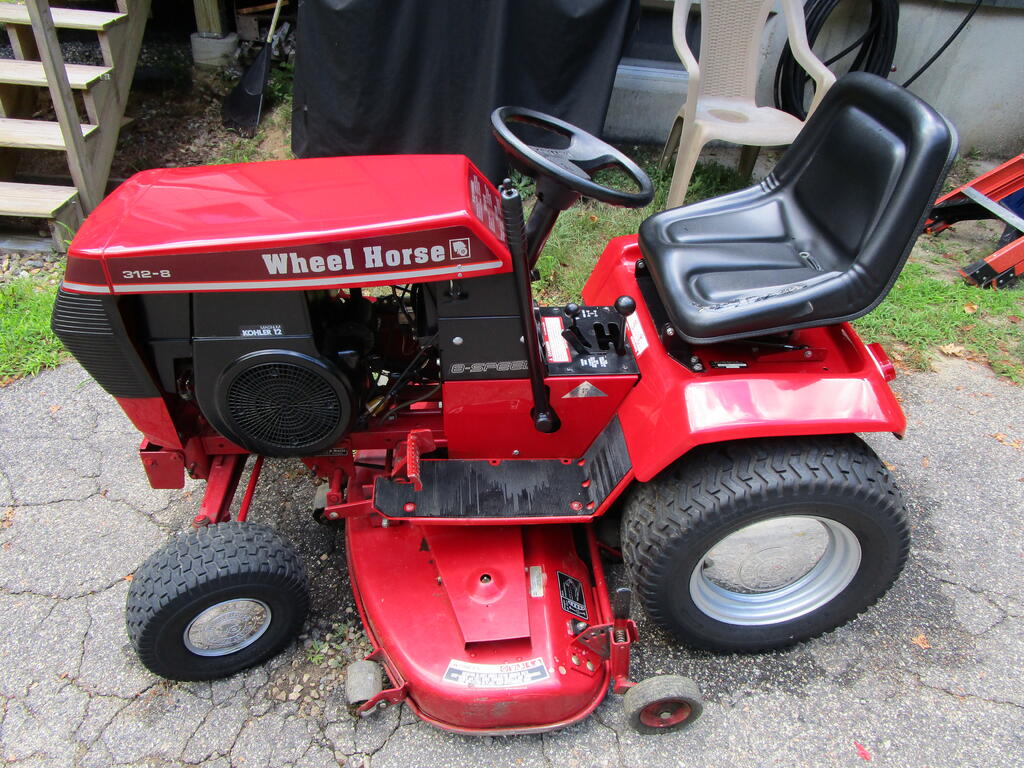

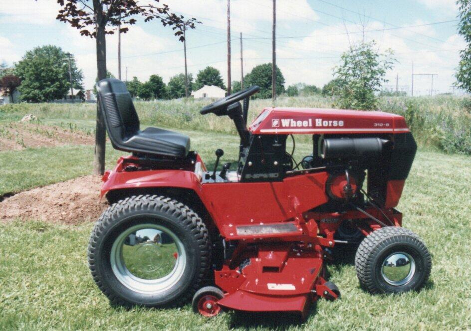

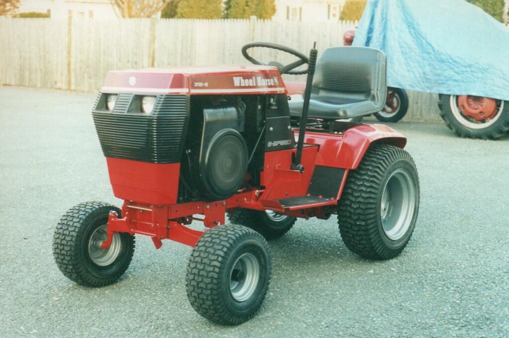

JCM 11,394 #20 Posted January 13, 2021 @Brockport Bill Congrats on holding on to the 312-8 and . I also have a 89 since new. The first pic here was a resto I did on a 1986 312 and used the Toro paint you mentioned and had great results, that was 20 years ago and since sold to a friend . The second pic is my 312 when new and the last was taken this past summer.I have been using Rustoleum Regal Red on recent projects with great results also. just a little darker than the Toro Red. Good luck on your project. 3 1 Share this post Link to post Share on other sites

Brockport Bill 2,453 #22 Posted January 16, 2021 On 1/13/2021 at 2:39 PM, JCM said: @Brockport Bill Congrats on holding on to the 312-8 and . I also have a 89 since new. The first pic here was a resto I did on a 1986 312 and used the Toro paint you mentioned and had great results, that was 20 years ago and since sold to a friend . The second pic is my 312 when new and the last was taken this past summer.I have been using Rustoleum Regal Red on recent projects with great results also. just a little darker than the Toro Red. Good luck on your project. yikes those reds are beautiful --- I actually talked to an auto body place today just to explore ideas -- but i also had my order of 4 different red spray paint can colors arrive today - -so i will test them each on the bare underneath of my shiny clean mower deck to see which color looks best and i like -- then i have to decide if i plan to do piecemeal, or maybe take sections to auto body ( if not having to pay a fortune) -- i am NOT looking for full restore - just maybe the deck and hood, seat fenders, and foot rests, side panels ? Still considering options but the info here is awesome -- thanks 1 Share this post Link to post Share on other sites
