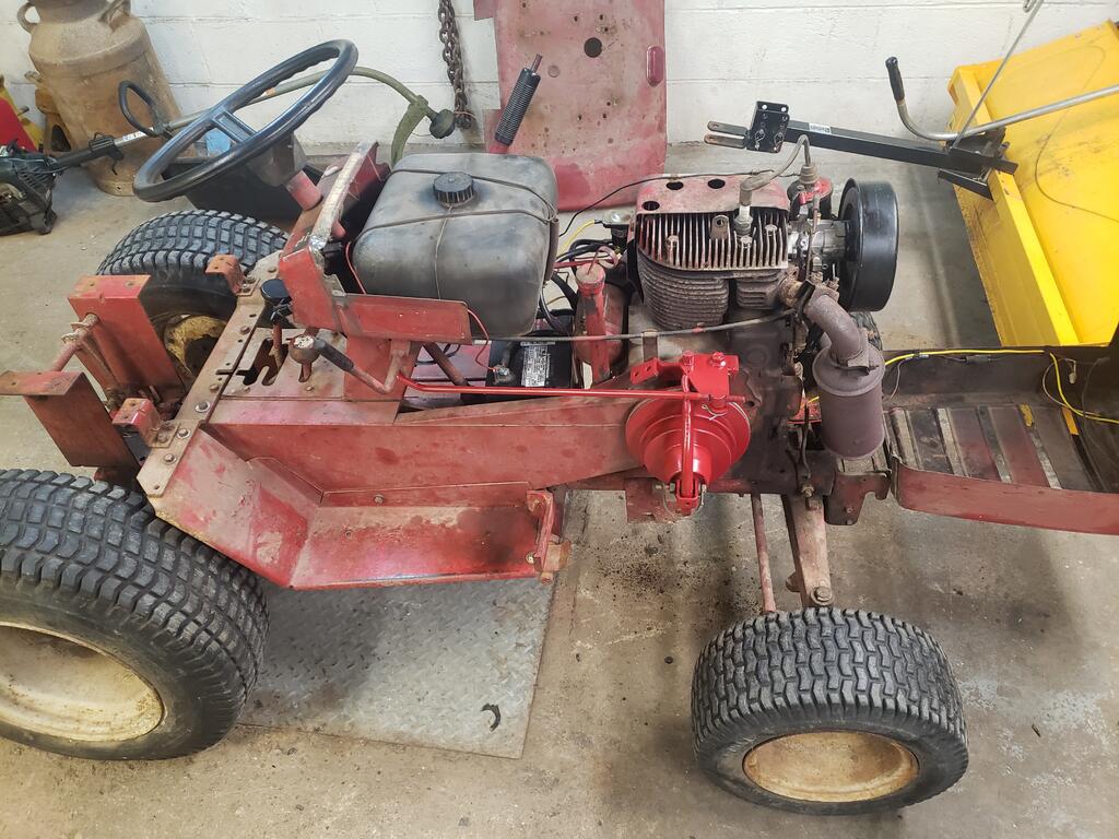

MoneyBagz 33 #28 Posted March 9, 2021 (edited) Ok guys.. I'm not seeing anything from the manuals to help me. And seems like I can't find too much info on c120's. But I been banging my head with the belt that goes from engine to the trans diff. I measured the one I took off it. It was 5/8 ×82 3/4. So I go myself a 5/8×82 belt. Its way too tight. So I bought a 5/8 ×84 and that is way too loose. From what I read it should take the 82. I don't see any adjustments for the pulleys. I don't know what I missing. Any help would be helpful or pictures of the assembly of the clutch and tensioner. Edited March 9, 2021 by MoneyBagz Misspelled Share this post Link to post Share on other sites
76c12091520h 4,289 #29 Posted March 9, 2021 Do yourself a favor and get an OEM Toro / Wheel Horse drive belt , # 7473 (new # 93-9808). It measures 81.95" long, section 5L (21/32" wide x 3/8" tall) . Some people have good luck with aftermarket drive belts, others not so much. 1 Share this post Link to post Share on other sites
ebinmaine 80,762 #30 Posted March 9, 2021 3 hours ago, 76c12091520h said: Do yourself a favor and get an OEM Toro / Wheel Horse drive belt , # 7473 (new # 93-9808). It measures 81.95" long, section 5L (21/32" wide x 3/8" tall) . Some people have good luck with aftermarket drive belts, others not so much. Do some searching online and you'll find the OE belt at a comparable price to aftermarket. Share this post Link to post Share on other sites
Rusty Tinsnips 477 #31 Posted March 9, 2021 15 hours ago, MoneyBagz said: So I go myself a 5/8×82 belt. Its way too tight. I ran around all over town one day buying 82 inch belts. 1 out of 4 ( one came from the internet) actually measured 82 inches, the rest were all short. Share this post Link to post Share on other sites
ebinmaine 80,762 #32 Posted March 9, 2021 2 minutes ago, Rusty Tinsnips said: I ran around all over town one day buying 82 inch belts. 1 out of 4 ( one came from the internet) actually measured 82 inches, the rest were all short. My memory is not perfect but I don't recall ever seeing a complaint about a Wheelhorse/ Toro belt. Look around online for just a few minutes and you can find o e belts around the same price as aftermarket or even less. Share this post Link to post Share on other sites
76c12091520h 4,289 #33 Posted March 9, 2021 OE belts on hand 20 minutes south of you. 1 3 1 Share this post Link to post Share on other sites

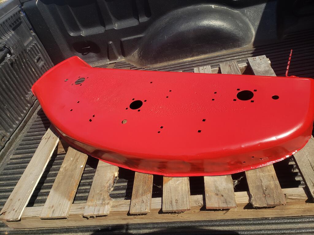

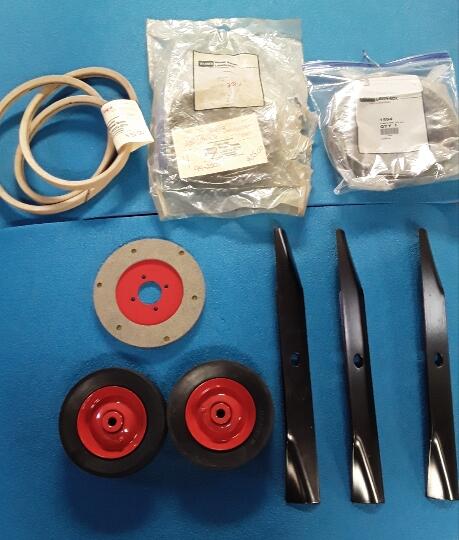

MoneyBagz 33 #34 Posted April 1, 2021 Haven't messed with the tractor yet but I did get my deck last weekend. It needs some tlc. But I need to get my all my belts now, blades, the clutch plates, and rear wheels for the deck. 1 Share this post Link to post Share on other sites

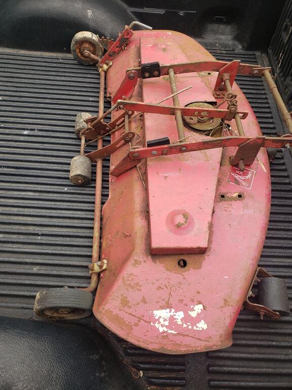

Jeff-C175 7,211 #35 Posted April 1, 2021 Looks pretty solid! Wonder what these extra holes are for? Share this post Link to post Share on other sites
pfrederi 21,172 #36 Posted April 1, 2021 18 minutes ago, Jeff-C175 said: Looks pretty solid! Wonder what these extra holes are for? Hole at this end is for the spindle grease fitting. The double extra hole were so the shell could be use on wider frame tractors like GT-14 and D series. 1 Share this post Link to post Share on other sites
Jeff-C175 7,211 #37 Posted April 1, 2021 39 minutes ago, pfrederi said: Hole at this end is for the spindle grease fitting So this model doesn't have the grease fittings on top of the spindle shaft then as my 48MS01 does. Thanks! lernt sumpin taday! Share this post Link to post Share on other sites
pfrederi 21,172 #38 Posted April 1, 2021 2 minutes ago, Jeff-C175 said: So this model doesn't have the grease fittings on top of the spindle shaft then as my 48MS01 does. Thanks! lernt sumpin taday! The old design was much better as the center spindle fitting could be easily accessed and didn't get mashed by the lift. 1 Share this post Link to post Share on other sites

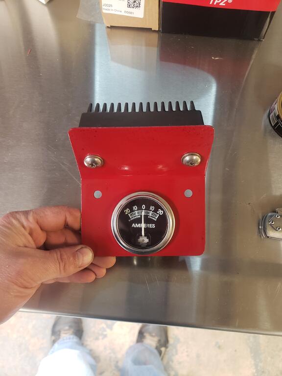

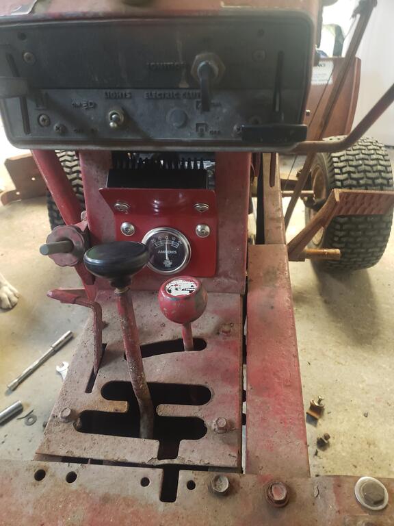

MoneyBagz 33 #39 Posted April 6, 2021 Well I have the deck tore down to free everything up and possibly repaint it. I also put my order in for everything I need to run the deck. Brain from K And B horse parts hooked me up with it all. Can't wait to pick the parts up and start putting it back together. Other note is I did get a new rectifier and amp gauge. I think it came out great. 2 Share this post Link to post Share on other sites

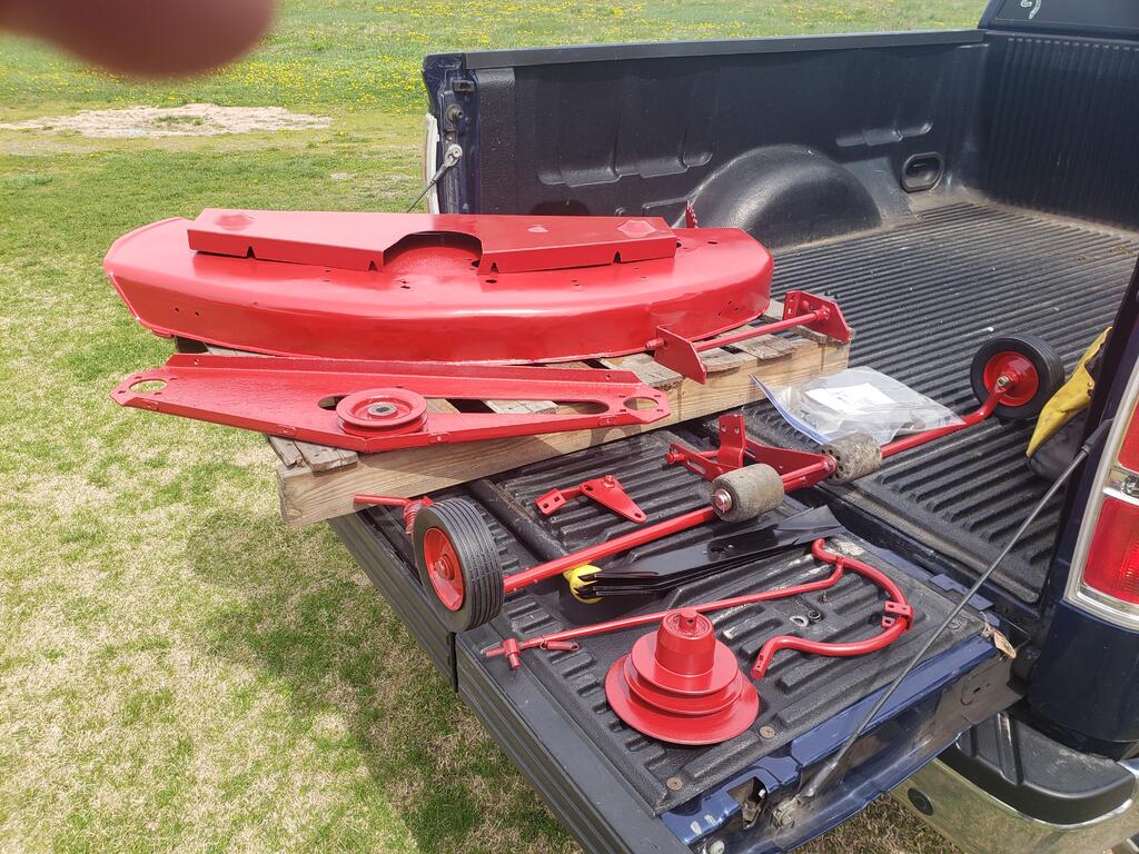

MoneyBagz 33 #40 Posted April 24, 2021 (edited) Well I got some of the deck redone. Its not a perfect deck by far. But will look somewhat nice to get the job done. Between my buddy helping out and Brain from K and B Horse Parts. Its getting done pretty quick. Edited April 24, 2021 by MoneyBagz 3 Share this post Link to post Share on other sites
Thor27 892 #41 Posted April 25, 2021 Probably could use a shift boot too. Big help to keep water out of the trans if it ever sits outside. 1 Share this post Link to post Share on other sites

MoneyBagz 33 #43 Posted April 25, 2021 13 hours ago, Thor27 said: Probably could use a shift boot too. Big help to keep water out of the trans if it ever sits outside. It stays in my garage. Lol. 1 Share this post Link to post Share on other sites

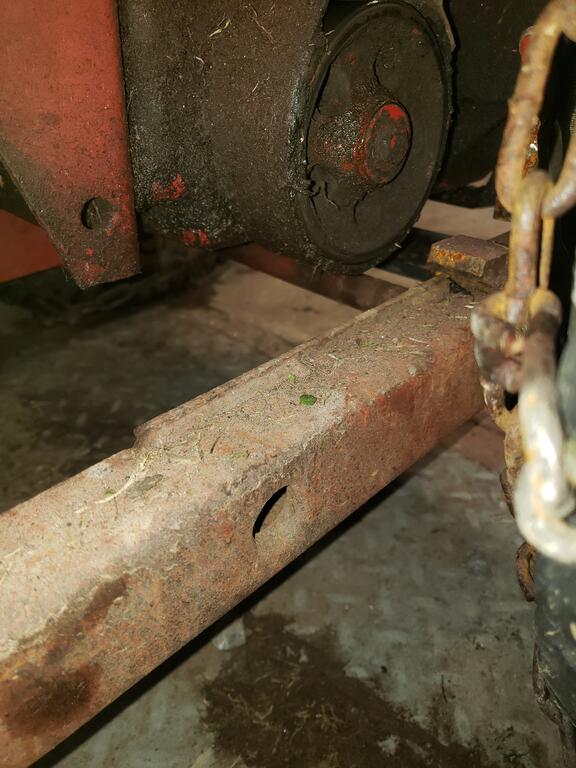

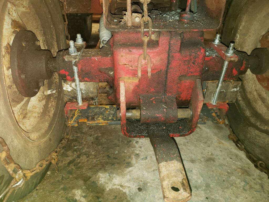

MoneyBagz 33 #47 Posted April 27, 2021 (edited) 22 hours ago, oliver2-44 said: Interesting that you have a standard transmission. The Kohler spec # on you tractor comes up as “Toro 61-16KS03, C-160 Automatic Tractor, 1976 KOHLER 12 H.P. ENGINE K301S, SPEC 47421D”. The Kohler Serial number comes up as a 1976. Of course who knows what past owners have swapped over the years Yea.. I have no clue what the previous owner before my father in law has done to the tractor. Prolly why I had to make blocks for the rear in order to make the plow work. Edited April 27, 2021 by MoneyBagz Share this post Link to post Share on other sites

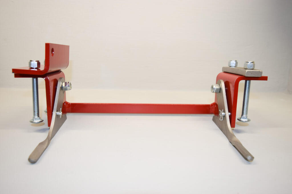

oliver2-44 11,758 #48 Posted April 27, 2021 @MoneyBagz am I seeing that your plow is hard bolted to the rear axle. They typically attached with a rear bracket like pictured below Of course if it works, it works. 1 Share this post Link to post Share on other sites
ebinmaine 80,762 #49 Posted April 27, 2021 5 hours ago, oliver2-44 said: your plow is hard bolted to the rear axle I was wondering about that too.... How's the tension on your clutch? That spring isn't stock. Looks like it has less pullback. Share this post Link to post Share on other sites
MoneyBagz 33 #50 Posted April 27, 2021 I had to put it that way. The lever to angle the blade was hitting my foot rest. As for the spring thats what was on it when I got it. Seems to work also. 1 Share this post Link to post Share on other sites
