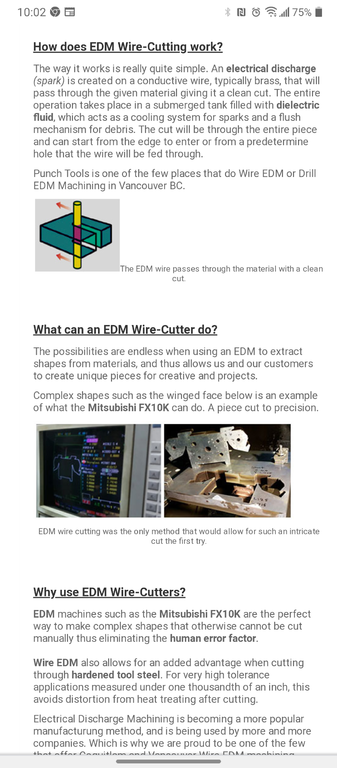

WVHillbilly520H 10,379 #125 Posted February 18, 2021 (edited) On 2/17/2021 at 7:17 AM, KAA 1973 said: Thats an easy part to laser or waterjet, just need a print to send to a shop. My brother has a Mennonite fab shop down the road from his machine shop we send parts for waterjet. Super cheap since they don't have overhead, (I.E., workers comp). We can't even buy the material for what this guy makes the entire part for. A waterjet can't make this part as precise as its needs to be, but a wire EDM can is just slow Video won't load sorry. VIDEO0045.mp4 VIDEO0045.mp4 VIDEO0045.mp4 Edited February 18, 2021 by WVHillbilly520H 3 Share this post Link to post Share on other sites
