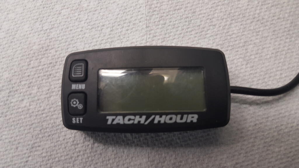

Gregor 4,848 #32 Posted May 18, 2021 I was thinking of this tach. In past conversations, I think it was said, the reading actually had to be cut in half. But sometimes I don't remember so well. Share this post Link to post Share on other sites
Jeff-C175 7,211 #33 Posted May 18, 2021 33 minutes ago, Gregor said: I think it was said, the reading actually had to be cut in half Would that be the case for the 'twins' with the 'wasted spark' design? If it's a single cylinder, with only one spark per revolution I would think it would read correctly. Share this post Link to post Share on other sites
lynnmor 9,042 #34 Posted May 18, 2021 30 minutes ago, Jeff-C175 said: Would that be the case for the 'twins' with the 'wasted spark' design? If it's a single cylinder, with only one spark per revolution I would think it would read correctly. It does not matter if there are one or two cylinders, if the ignition is timed from the crank there will be a spark at each plug every revolution. 1 Share this post Link to post Share on other sites
Jeff-C175 7,211 #35 Posted May 18, 2021 31 minutes ago, lynnmor said: It does not matter if there are one or two cylinders, if the ignition is timed from the crank there will be a spark at each plug every revolution. Yep... I realized that after I sent. So a digital tach reading will in fact need to be halved. Share this post Link to post Share on other sites
