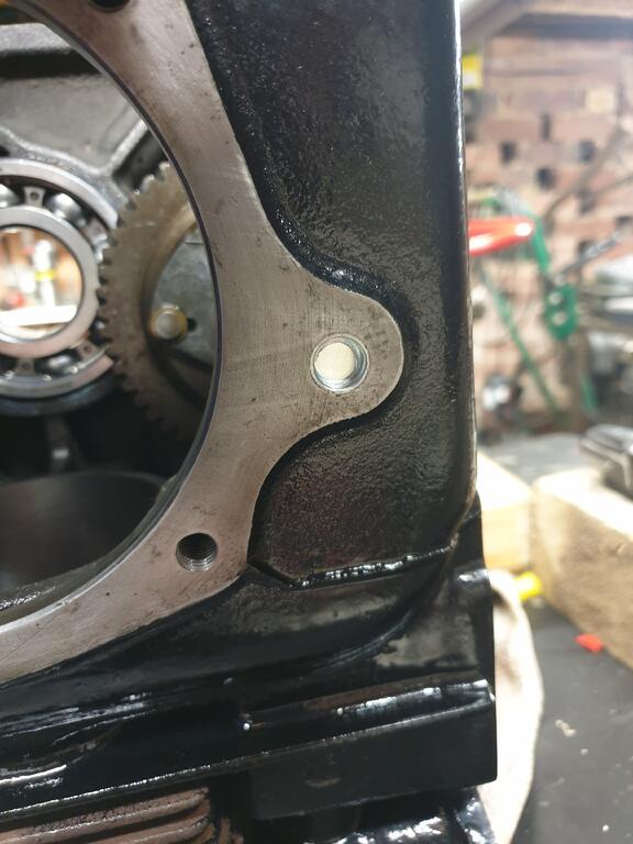

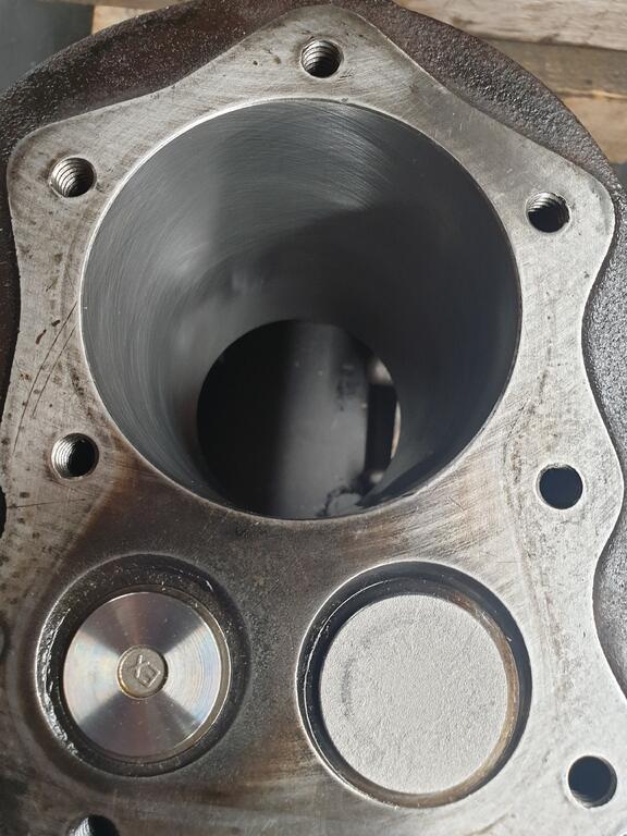

Mickwhitt 5,259 #128 Posted February 16, 2021 Engine back home from the machine shop. 11 4 Share this post Link to post Share on other sites
tunahead72 2,662 #129 Posted February 16, 2021 Oh, that's pretty! 1 1 Share this post Link to post Share on other sites
Tuneup 1,459 #130 Posted February 16, 2021 When you said 'bore', you meant it. I would have put a bit of steel wool buffing on the deck to make it shiny for you! Share this post Link to post Share on other sites

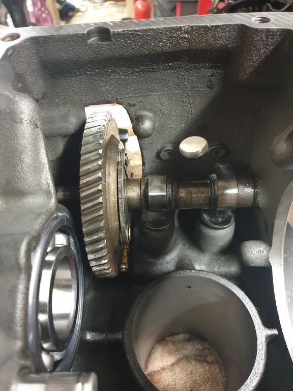

Mickwhitt 5,259 #131 Posted February 17, 2021 Washed out the bore with soap and water, dried and oiled it as per your instructions. Lapped in the valves and cleaned the grinding paste off scrupulously. Fitted the cam shaft, checking end float. Knocked in an expansion plug which was missing when I stripped the engine but should be there to seal the camshaft pin. 4 Share this post Link to post Share on other sites

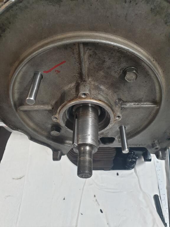

Mickwhitt 5,259 #133 Posted February 17, 2021 2 shims in mine and end float within limits. Crankshaft fitted, timed up with the cam shaft. Bearing plate fitted and end float of the crankshaft checked and within limits. I made a pair of lining up pins to hold the gaskets and shims in place while I knocked the bearing plate on. 3 Share this post Link to post Share on other sites

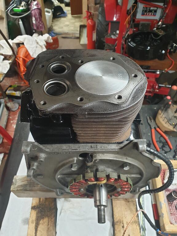

Mickwhitt 5,259 #135 Posted February 18, 2021 The crank was reground so I'm hoping it will be in balance still. Not much I can do about it now lol. Bottom end is all back together and done. Valves ready to be fitted in the morning and I will see where that gets me in relation to finishing off the rebuild. Mick 6 Share this post Link to post Share on other sites
