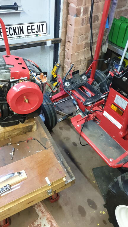

Mickwhitt 5,259 #14 Posted January 13, 2021 Right ho. The job has begun, I got my tiny shop set up to remove the engine from Fred and will park the chassis out of the way while I work on the engine. Im hoping for a pretty quick turn round with the only things out of my hands being the machining and the parts delivery. With any luck Fred will run for another 40 years by which time I won't be so bothered lol. The oil was very dirty and black when I dropped it, so we need to do this. Mick 2 Share this post Link to post Share on other sites
ebinmaine 81,004 #15 Posted January 13, 2021 I'll be looking forward to seeing your progress on this one. Hopefully you have your camera button pushing finger primed up and ready to go. Share this post Link to post Share on other sites
Mickwhitt 5,259 #16 Posted January 13, 2021 Absolutely Eric. The engine is now sitting on my work bench awaiting tear down. 2 1 Share this post Link to post Share on other sites
tunahead72 2,662 #17 Posted January 13, 2021 Nice sign... You'll fill us in on its special meaning in your world? 1 3 Share this post Link to post Share on other sites
Mickwhitt 5,259 #18 Posted January 13, 2021 Oops! Sorry. Thats a joke licence plate from Ireland my lovely wife brought me back as a gift. Not sure what vehicle she had in mind for me to display it on. Mick 3 Share this post Link to post Share on other sites
