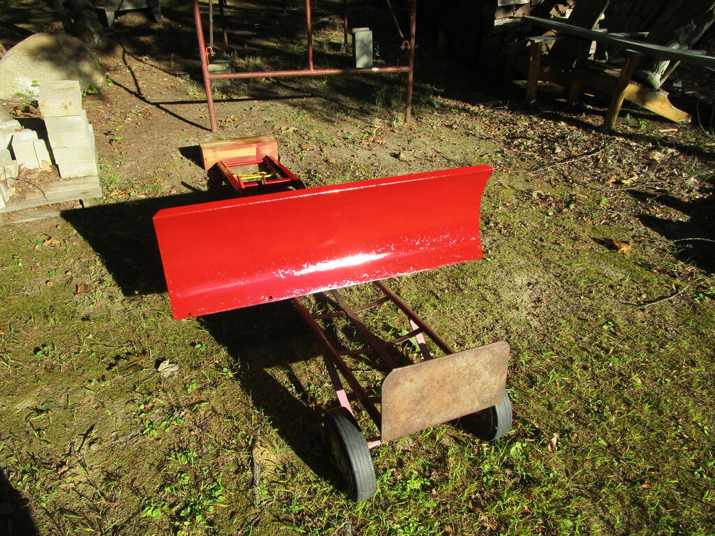

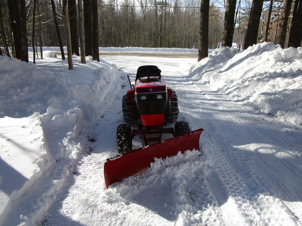

Achto 32,844 #5 Posted January 10, 2021 Sand blast or just sand it down & paint it with a good gloss enamel. I did this with my plow blade & have never had an issue with snow sticking to it. This will work even if there is pitting on the metal. 2 1 Share this post Link to post Share on other sites

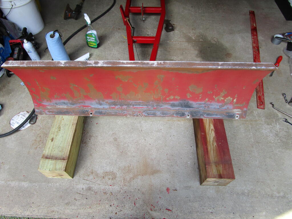

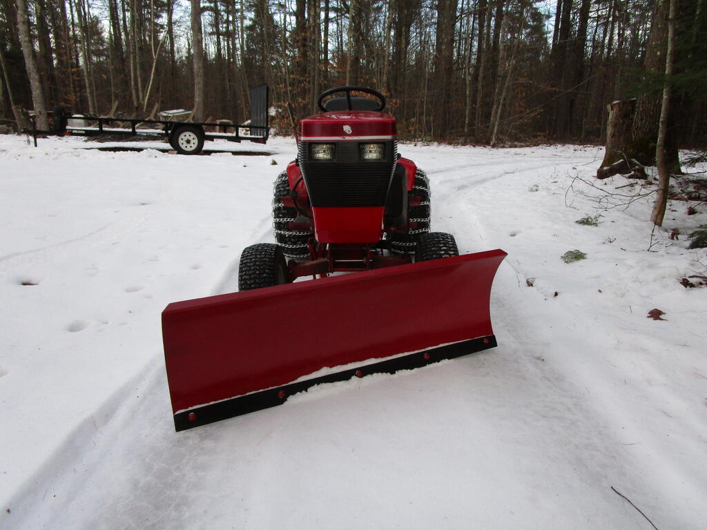

JCM 11,419 #9 Posted January 10, 2021 12 hours ago, Achto said: Sand blast or just sand it down & paint it with a good gloss enamel. I did this with my plow blade & have never had an issue with snow sticking to it. This will work even if there is pitting on the metal. I recently cleaned up the the front side of the 48'' dozer blade and did just what Dan said. Used a DA sander then Rustoleum rusty metal primer and finished with Regal Red.Have only used it twice since and have had no snow stick to the blade. Maybe to soon to tell but so far I am pleased with the results. 1 Share this post Link to post Share on other sites
