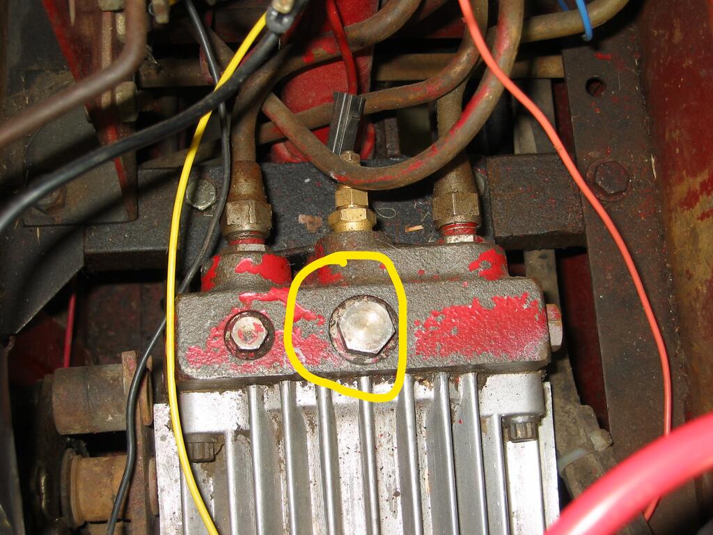

pfrederi 19,941 #6 Posted January 10, 2021 Mine self primes, but, it didn't sit for 10 years. In your case I would fill the rearend then open the plug (yellow circle) on the pump and pour in what ever fluid you are using. ATF or motor oil 1 Share this post Link to post Share on other sites
