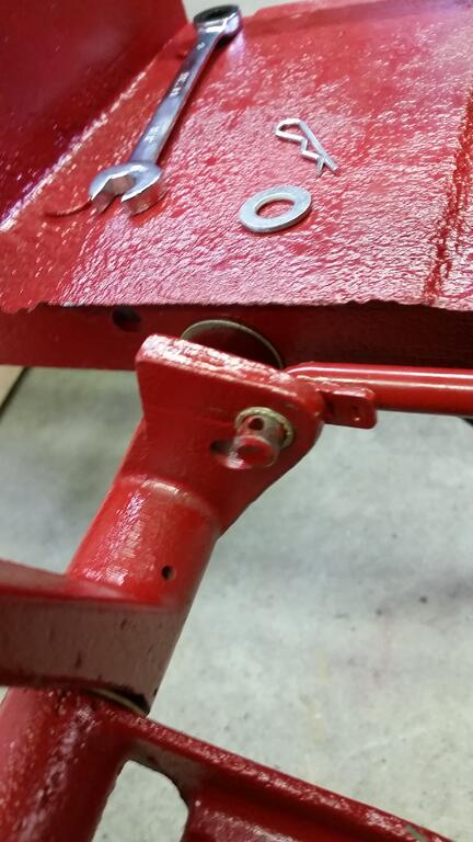

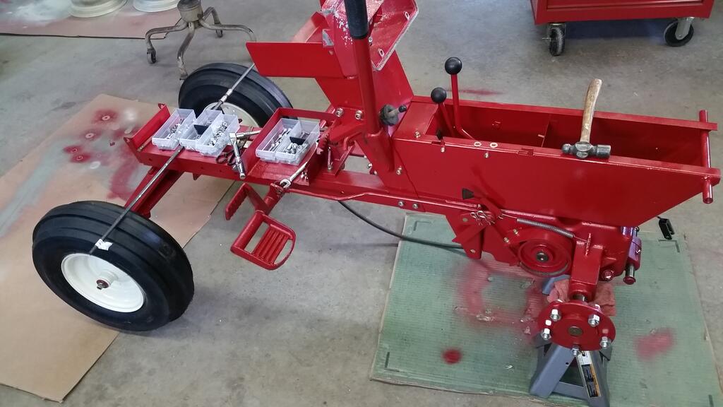

squonk 47,804 #26 Posted January 7, 2021 (edited) 20 hours ago, WHX24 said: Front should look like this Rear should look like this. This is on a 1067 Or this The only way the belt would tighten pushing the pedal down is either the front lever OR rear lever is flipped. Since the front lever is part of the pedal I would say the back one. Edited January 7, 2021 by squonk 1 Share this post Link to post Share on other sites
rmaynard 17,496 #27 Posted January 7, 2021 What's the chance of getting a picture of the other side of the tractor where the brake rod attaches? Share this post Link to post Share on other sites
