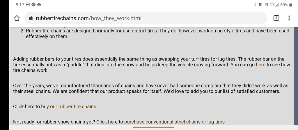

WVHillbilly520H 10,379 #8 Posted January 5, 2021 But what I find amusing is how most on here knock AG (lug) tires in snow, then praise the rubber chains but this little snippet is directly from the rubber chains web site... Things that make you go hhmmmm.... 1 1 1 Share this post Link to post Share on other sites

WVHillbilly520H 10,379 #13 Posted January 5, 2021 2 minutes ago, pullstart said: I must say, I’ve seen more paddle tires in the sand dunes than angled Ag style tires. They must grab and propel a bit different for that to happen... Now in "mud bogging/racing" I have seen quite a bit of both with some running an angled bar tread up front and paddles in the back on the same ride... But I was actually referencing the line before that. 1 Share this post Link to post Share on other sites
